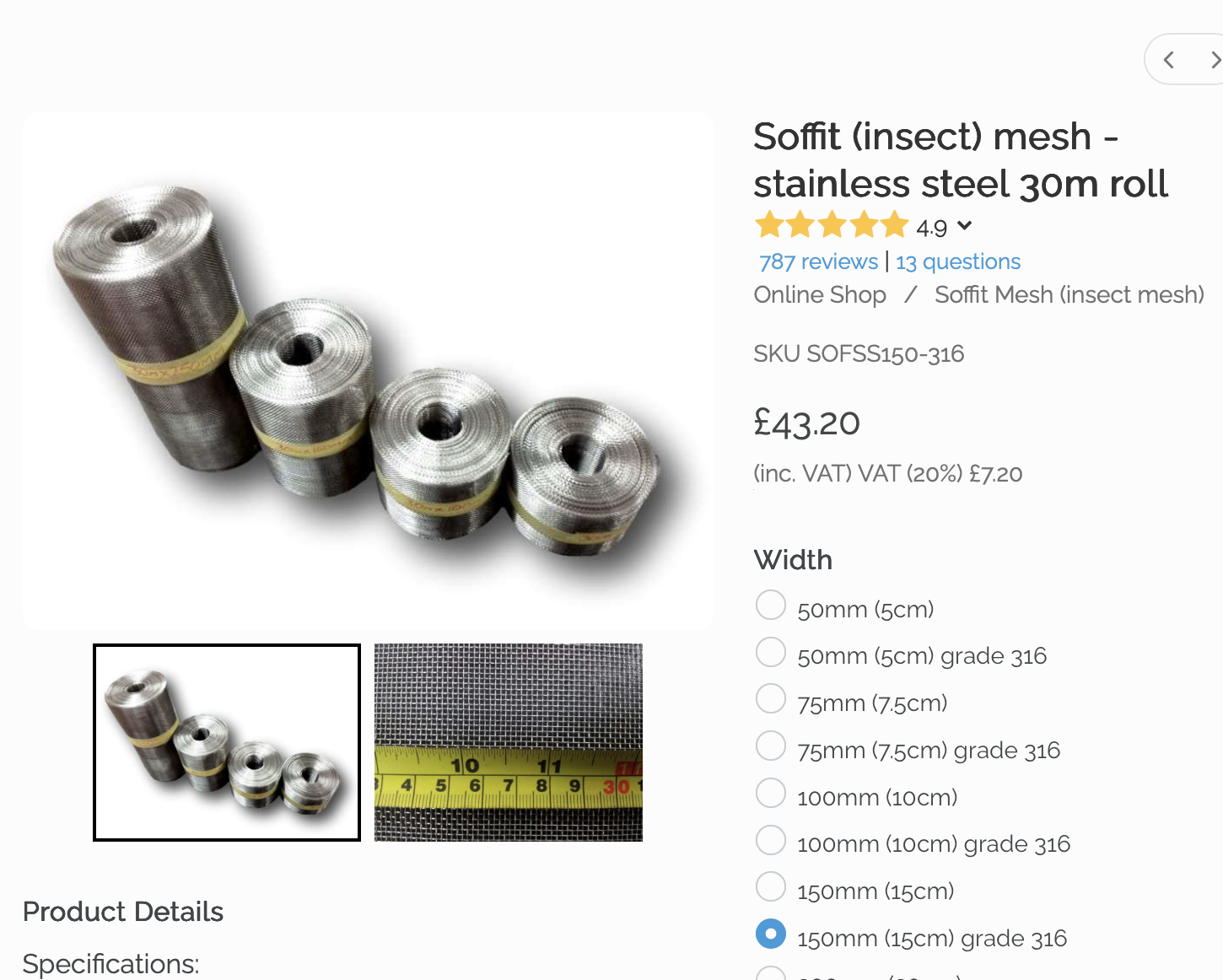

Great_scot_selfbuild Posted 7 hours ago Posted 7 hours ago 16 minutes ago, Big Jimbo said: Don't forget to mesh the top Yes, it'll need to be ventilated. No matter how many times I mention that we need a mesh installed, this seems to be something that is actively ignored and it looks like I'm going to have to go and add this to the list of stuff I need to do myself! (has anyone got any recommendations for mesh they've actually used? I'm sure I can find some, but no doubt some products will be easier to use and handle than others, so I'd like to hear some first-hand experience)
Dunc Posted 5 hours ago Posted 5 hours ago I have plastic eaves vents to go ontop of the fascia board. At cladding voids (bottom of the cladding, top & bottom of windows, verges, anywhere a mouse could think looks interesting) I'm using stainless steel woven mesh, 8 count. 150mm x15m rolls from Robinson Wire Cloth were the cheapest I could find, even with a surcharge for delivery to Scotland. Listed as "rodent mesh". Wear gloves, cut to size with tin snips, bend to shape by hand no problem, fix with button head stainless screws or just trap behind battens, as appropriate. I must have got through 150m of the stuff and I'm still not done. You definitely need mesh! How this partridge thought it would squeeze up a 50mm gap is beyond me....I shall be re-prioritizing getting the eves vents sorted 🙄 1
Nestor Posted 5 hours ago Posted 5 hours ago 1 hour ago, Great_scot_selfbuild said: (has anyone got any recommendations for mesh they've actually used? I'm sure I can find some, but no doubt some products will be easier to use and handle than others, so I'd like to hear some first-hand experience) I fixed this mesh at the top and bottom of the battens behind the Cedar cladding. https://www.robinsonwirecloth.co.uk/online-shop/Soffit-insect-mesh-stainless-steel-30m-roll-p49612077 1
saveasteading Posted 5 hours ago Posted 5 hours ago (edited) We had wasps somehow getting through a 2mm local gap between overlapping weatherboards. They then chewed the stud behind to make paper for a nest. So mesh needs to be very small. Someone will have studied this I hope. Overlapping messages. That mesh looks fine. Edited 5 hours ago by saveasteading Overlapping messages 1
Nestor Posted 5 hours ago Posted 5 hours ago 6 minutes ago, saveasteading said: We had wasps somehow getting through a 2mm local gap between overlapping weatherboards. They then chewed the stud behind to make paper for a nest. So mesh needs to be very small. Someone will have studied this I hope. Overlapping messages. That mesh looks fine. The mesh is fine, how effective it is, down to whoever fits it. 1
G and J Posted 5 hours ago Posted 5 hours ago 28 minutes ago, Dunc said: 150mm x15m rolls from Robinson Wire Cloth Snap......is working well, again fast delivery good price 2
