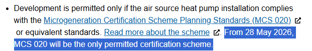

joth Posted September 30, 2025 Posted September 30, 2025 (edited) On 28/09/2025 at 11:16, JamesPa said: Is there any hope that things will change radically and soon? Is anyone in the industry campaigning? Government cant be expected to know what the problems are because the industry associations and in particular MCS will be painting a rosy picture of how standards are being raised. The impetus needs to come for the good guys in the industry who need to call out the problems and propose solutions to Government! No chance this changing any side soon: aside from BUS, MCS is also mandated by law for permitted development rights for ASHP install. And notice the wording on this is changing in May 2026: previously it allowed for MCS 020 or equivalent standards, but from May it it MCS 020 compliance, or no heat pump for you. (Obv you can still go the PP route, but what LPA is not going to slap the MCS020 requirement on their approval). https://www.planningportal.co.uk/permission/common-projects/heat-pumps/planning-permission-air-source-heat-pump - Oh, And I love the way the "MCS 020" link sends you to a 404 not found error on the MCS website. Pretty much highlighting the exact perils of public law referencing a private corporation (charitable trust) as the monopoly gate keeper for standards. Still, I guess it's no different to IET owning the wiring regs is it? Well, except they do at least step up and define the regs and the methods for the most part. Edited September 30, 2025 by joth
JohnMo Posted September 30, 2025 Posted September 30, 2025 44 minutes ago, joth said: Oh, And I love the way the "MCS 020" link sends you to a 404 not found error on the MCS website Quick google and its located here https://mcscertified.com/mcs-has-published-an-updated-version-of-mcs-020/ Interesting that the wording is somewhat different "Contractors shall be under a duty to ensure compliance with MCS 020 a) in relation to any installation carried out as permitted development. The MCS may impose penalties or sanctions if an MCS Contractor fails to ensure compliance with this Standard prior to undertaking an installation." It does not state the contractor has to be MCS cetified etc. Only is an MCS contractor sanctions will apply if you don't follow the rules. So following the exact wording - you need to follow the noise rules - but you do not need to be MCS certified - so anyone can comply you just do the certificate. Which I will do for install and file away.
-rick- Posted September 30, 2025 Posted September 30, 2025 1 hour ago, JohnMo said: Quick google and its located here https://mcscertified.com/mcs-has-published-an-updated-version-of-mcs-020/ That link includes the text Quote Compliance with MCS 020 a) under PDR will apply irrespective of whether it’s an MCS certified installation or not. Which matches previous discussion on here about this change. ie, that you have to meet the standards but don't have to be MCS approved as John says.
joth Posted September 30, 2025 Posted September 30, 2025 4 minutes ago, JohnMo said: So following the exact wording - you need to follow the noise rules - but you do not need to be MCS certified - so anyone can comply you just do the certificate. Which I will do for install and file away. Yes that's correct, my comment was speaking to @JamesPa point that MCS are the (sole) guardians of the standards, not regarding certification perse.
