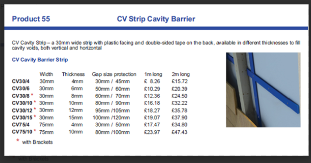

Lincolnshire Ian Posted September 22, 2025 Posted September 22, 2025 Hi folks We need intumescent strips to close the 50mm void in our timber frame where we use cladding (about 30% of the house). I am more than a little shocked by the difference in price between cavity socks for the masonry walls and intumescent strips for the cladded walls. Does anyone have a supplier that offers intumescent strips at a reasonable price? Thanks
nwnw Posted September 22, 2025 Posted September 22, 2025 I was reading posts on this recently and it seems that Envirograf is generally cheaper than Tenmat. However, I did see that folks were getting away without using intumescent strips if they had an open 'rain screen' cladding format, which is what I'm looking at. Will need a chat with BCO.

saveasteading Posted September 22, 2025 Posted September 22, 2025 4 hours ago, nwnw said: Will need a chat with BCO. Firstly Envirograf. My favourite in this field as they understand fire and the products, many of which they first produced. I haven't contacted them for years but always found their advice interested, realistic and worthwhile. The BCO unfortunately probably will want to see a test certificate for exactly the situation. The purpose of the strip is to stop the spread of flame, and a lump of wood or metal would do it fine. But nobody has tested that as there is no market. A product exists so you probably have to use it. If the manufacturer made the exact same product but wrapped in red , and tested with timber, or wrapped in blue and tested in metal cladding, then those would be the test certificate that existed, and you have to use the red or the blue. How about intumescent paint on a timber block or metal profile? A pragmatic and knowledgeable BCO might agree to it: after all it has the magic word intumescent. I'm not guessing btw. I've worked on this a lot, including a high level course, but there were no qualifications awarded. 3 hours ago, Mr Punter said: the chimney effect is much reduced if there are gaps between the boards. Yes, but the effect of heat rising is still there. A fire spreads very rapidly upwards, chimney effect or not, as the material above is preheated, and then a flash flame can occur. 1

Dunc Posted September 23, 2025 Posted September 23, 2025 Just installing ours right now. Envirograf CV strip significantly less expensive than the Tenmat offering. Got ours from www.lifelinefireprevention.com Probably worth checking with BCO exactly what they would want to see; the regs are pretty general and your individual building may not need "everything".

marmic Posted September 25, 2025 Posted September 25, 2025 Jit was extremely helpful........... cost lower than other products i found. significanty in some cases
Lincolnshire Ian Posted September 28, 2025 Author Posted September 28, 2025 Thank you everyone - very helpful. I will call Envirograf to get the info we need.
Lincolnshire Ian Posted September 30, 2025 Author Posted September 30, 2025 I spoke to the guys from Envirograf and it was a stress-free process for a novice. I explained my scenario, they asked a few questions, made some suggestions and followed up with an email - all within the space of a couple of hours. 1
