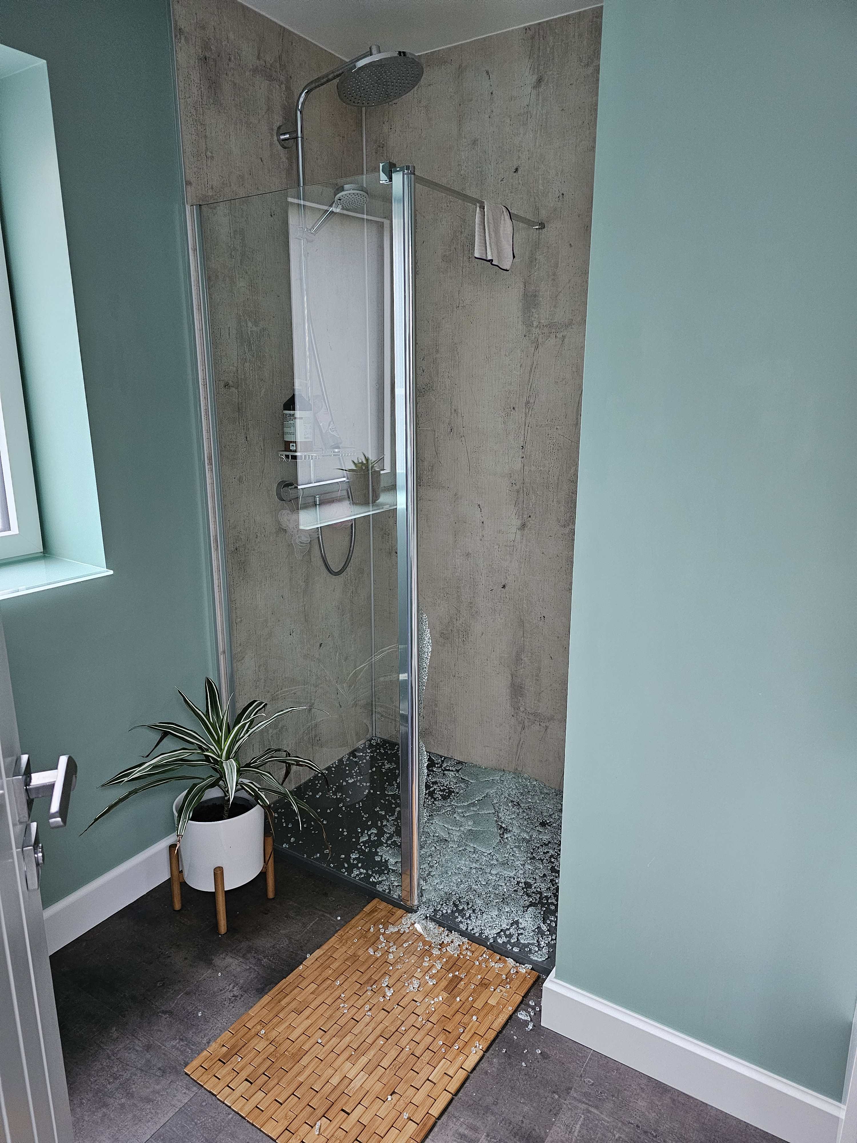

canalsiderenovation Posted September 20, 2025 Posted September 20, 2025 (edited) Woke up to this, it's our spare shower and not regularly used. Been in for about 3 years with no issues. Any idea what can cause this? Didn't even hear it. Its the flipped thingy Edited September 20, 2025 by canalsiderenovation 1
Bonner Posted September 20, 2025 Posted September 20, 2025 Happened to me twice, once at home and once in a hotel room, wasn’t anywhere near them at the time. It’s pretty much a spontaneous explosion, could be a combination of material fault and thermal expansion.
canalsiderenovation Posted September 20, 2025 Author Posted September 20, 2025 1 minute ago, Bonner said: Happened to me twice, once at home and once in a hotel room, wasn’t anywhere near them at the time. It’s pretty much a spontaneous explosion, could be a combination of material fault and thermal expansion. Wow, so strange. Does anyone know if you can just replace the flipper or if whole glass has to come off. It looks like it's just the flipper bit that smashed.
Bonner Posted September 20, 2025 Posted September 20, 2025 My flipper panel was supplied separately but it may depend on the manufacturer. Suggest you find out the make and model and look at the hinge fixings, you should be able to take it off.

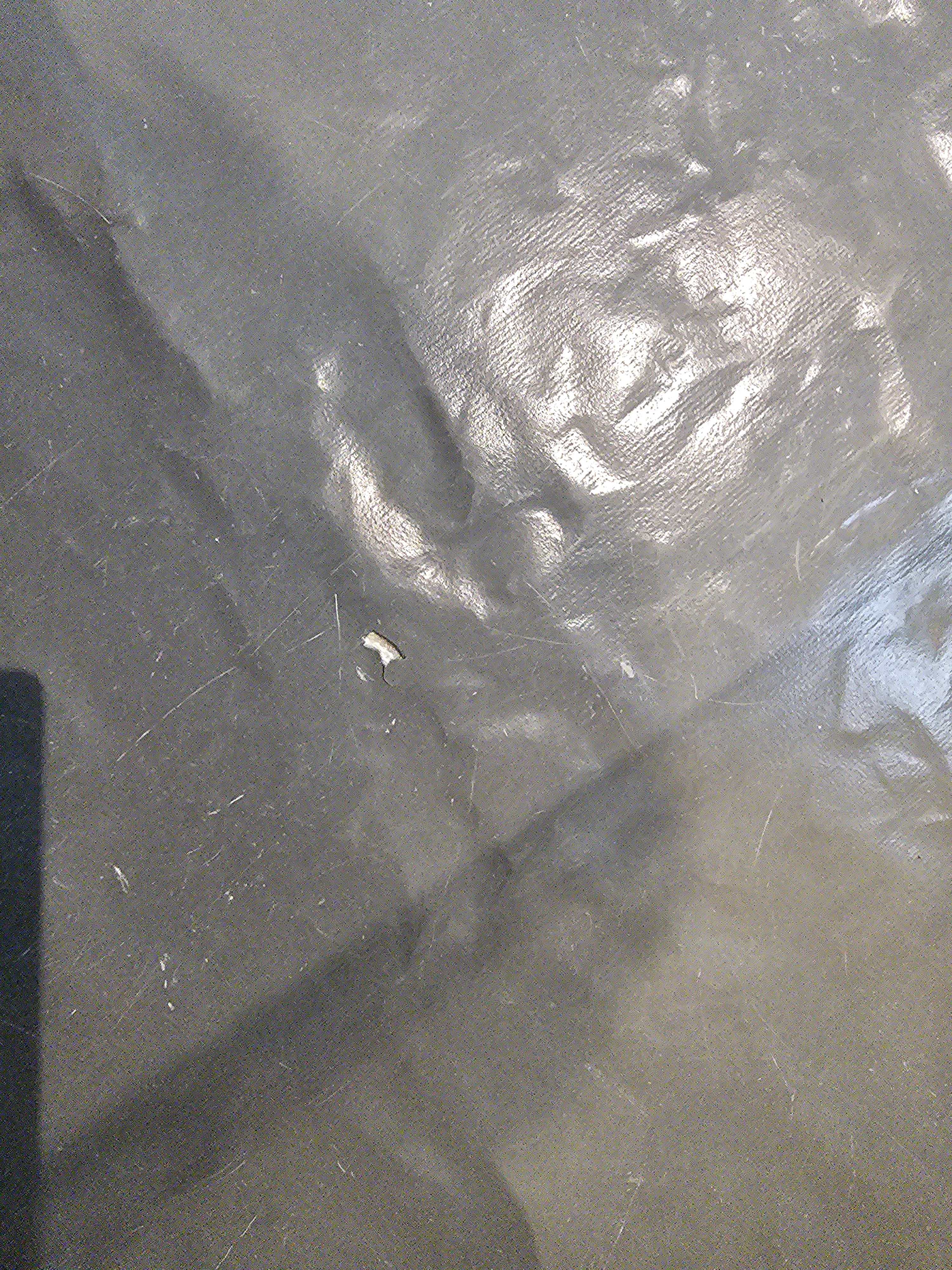

canalsiderenovation Posted September 20, 2025 Author Posted September 20, 2025 Good news is it looks like the flipper panel can be replaced as I've taken it off just now. Bad news, chip and scratches hes in slate ecfect shower tray thingy. Any idea how to repair?
dpmiller Posted September 20, 2025 Posted September 20, 2025 looks like the same flipper as ours. If so, there's a wee screw holds the top cap on, as a pivot
Nickfromwales Posted September 20, 2025 Posted September 20, 2025 7 hours ago, canalsiderenovation said: Good news is it looks like the flipper panel can be replaced as I've taken it off just now. Bad news, chip and scratches hes in slate ecfect shower tray thingy. Any idea how to repair? Mr Magic.com. 1
canalsiderenovation Posted September 21, 2025 Author Posted September 21, 2025 20 hours ago, Nickfromwales said: Mr Magic.com. That doesn't work as a www. Is that a typo?
Gone West Posted September 21, 2025 Posted September 21, 2025 1 hour ago, canalsiderenovation said: That doesn't work as a www. Is that a typo? There's a couple of companies one is magicman.co.uk https://magicman.co.uk/ 2
Nickfromwales Posted September 21, 2025 Posted September 21, 2025 4 hours ago, Gone West said: There's a couple of companies one is magicman.co.uk https://magicman.co.uk/ What he said. 1
