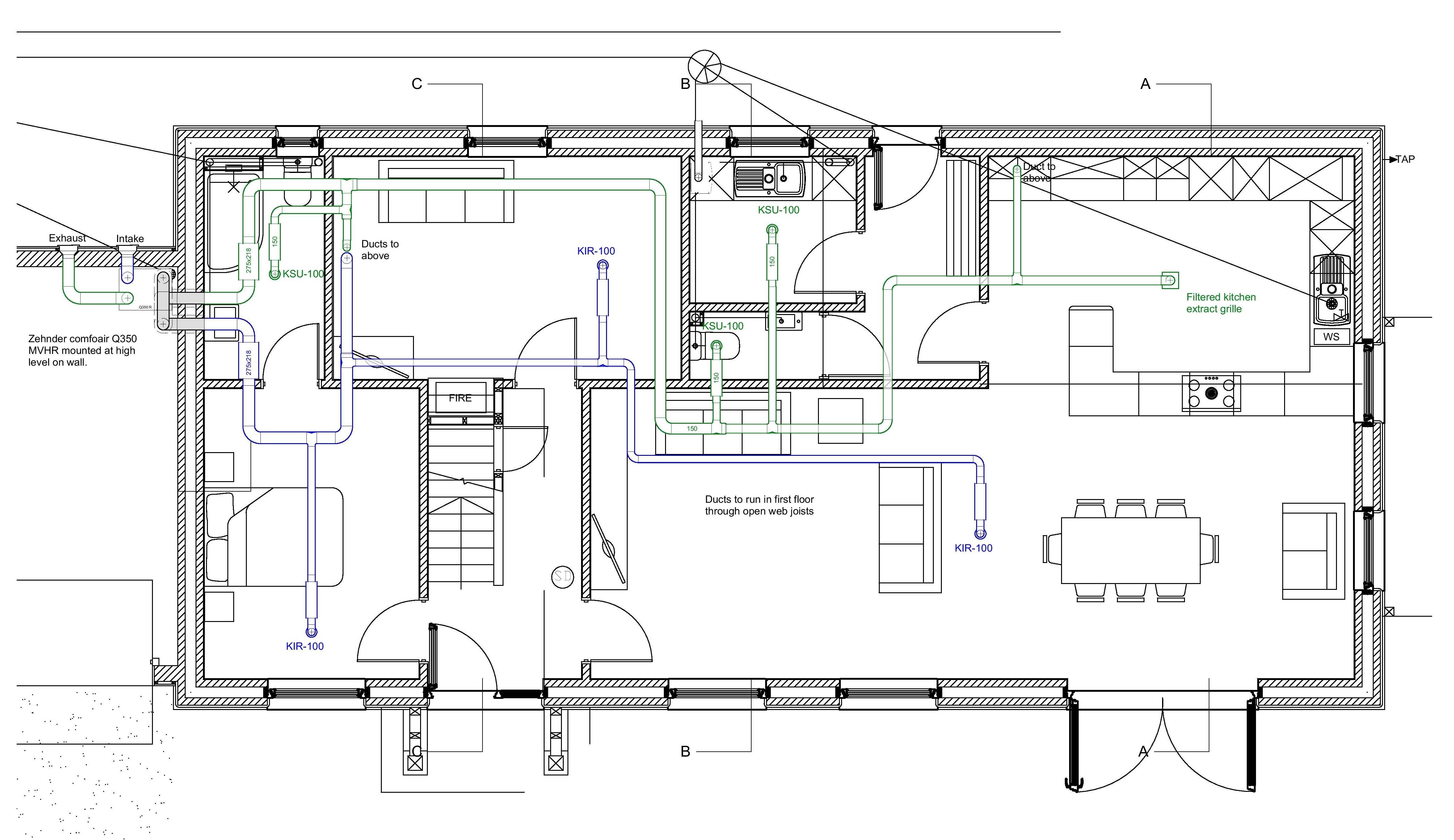

Which is better in terms of MVHR performance - rigid or semi-rigid ducting? Anyone have experience of both types?
We have ample space to accommodate rigid ducting in our new-build and have visited a build nearby which has used rigid MVHR ducting throughout, but a lot of the quotes I'm receiving are proposing semi-rigid ducting (our plans were supplied, so they can see we have 425mm posi joists and can run pipes up alongside the 350mm timber I-joists to the loft space). My assumption is that the rigid ducting will provide a smoother airflow and therefore better performance of the system.

Either rigid or semi rigid can good or bad. It's all down to design. Semi rigid being way more tolerant of not so good design.
Rigid, needs good between room attenuation, semi rigid had this by default.
Airflow, disturbance really depends on how many bends or changes in diameter you have with rigid. Semi rigid is all generally smooth long radius bends.
System pressure drop, resulting fan speed, either can be designed with the same pressure loss - so exactly the same fan speed.
Air flow noise, 90mm semi rigid in most instances can be a single run from plenum to outlet/inlet, 70mm may need 2x runs. Rigid should be silent normally.
Ease of install, semi rigid wins every time. It's flexible, rigid isn't.
Cost to install semi rigid should be way cheaper, no inter room attenuation needed.
I had two designs rigid and semi rigid, both to be self installed. Went semi rigid, just so much easier to install - it's silent.

With a rigid branch system, there is potential for noise transfer between rooms, which might require additional attenuators. With a semi-rigid radial system you can send more than one duct to a plenum which can be useful.
Not sure if rigid spiral ducting is smoother than semi-rigid, as one has seams and the other is seamless with a continuous unbroken duct. Rigid has lots of joints, which require the joints to be sealed. Lindab SAFE rigid ducting has double gaskets, but is more expensive than regular spiral ducting.

Rigid ducting in the standard outside the domestic sector where larger diameters are required to move more air, and where installation is less impeded - there's normally no need to thread it between joists, for example. In regular domestic situations the pros of semi-flexible ducting predominate and the performance differences aren't going to be very significant.
Bigger factors are how the intake and exhaust ducts (to and from the MVHR unit from outside) are routed and insulated - keep them short and insulate them well - and the performance of the MVHR unit. The latter needs to take into account both the heat recovery rate (for which the standard way of measuring it is inadequate) and the electrical consumption of the fans (which will be running 24/7 for many years). The reliable resource for selecting those, based on independent real-life testing of both measures, is the PassivHaus database, where Efficiency Ratio = overall performance (heat recovery & electrical consumption).

I used quality semi-rigid to the manifold which is really easy and quick to install. It’s also quite easy to damage if it catches on any sharp edges or random nails so some care is needed. We’d never have got rigid through the building. One mistake I made was not allowing quite enough room in the ceiling for the manifold, attenuation and pipe work to the MVHR unit. With a bit more thought I could have mostly hidden it. However it’s all in the plant room so not a big deal. The other issue we had is the MVHR unit is in the single storey part of the house so getting the ducting through into the other side of the house was a right pain. The design of the house made no allowance for this.
