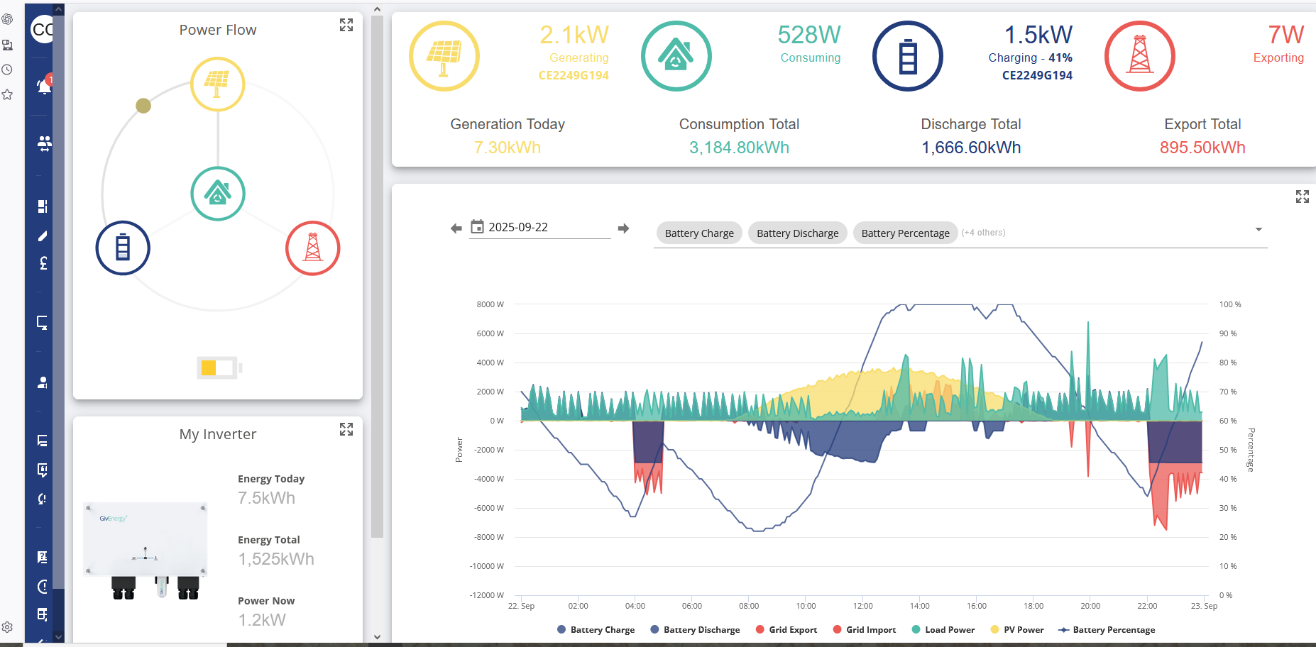

September 23, 20251 yr Author see attached 22/9/25 graph; is this an example of 'short cycling'? According to online AI: The LG Therma V R32 monobloc air-to-water heat pump does not have a built-in immersion heater (IH). The monobloc unit is designed as a self-contained outdoor unit for heating and hot water that connects directly to the domestic water system. I noticed that the WC kicks in when outside temp drops below 12°C. During overnight period, between 00:00 & 05:00, schedules for DHW & CH are OFF so it seems that the power draw is to satisfy the buffer using WC (AI). Since there is no IH available for use, I have to assume the AWHP is running at these times at a low (modulated) level. If this is an example of 'short cycling' what can I change to help reduce the effect? My World Heat DHW cylinder has a built in buffer tank at the base. There are 4 connections to this buffer tank which seems to indicate it is a 'hydronic seperator' preventing the AWHP's internal pump interfering with the CH pump attached the the CH circuit of the DHW tank. There is no IH fitted to this buffer tank. My 'sterilisation' IH is switched OFF permanently. My Octopus Cosy tariff has 3 daily cheap rate slots but the AWHP seems to be able to run at any time, contolled by WC. This means it could run during the most expensive time between 16:00 & 19:00 (3 times cheap rate!). Is there any way to mitigate this effect? Still no response from LG!
September 23, 20251 yr 18 minutes ago, chris47 said: My Octopus Cosy tariff has 3 daily cheap rate slots but the AWHP seems to be able to run at any time, contolled by WC. This means it could run during the most expensive time between 16:00 & 19:00 (3 times cheap rate!). Is there any way to mitigate this effect? Im struggling with interpretation of the graph but it looks like short cycling to me. At least 3 ways I can think of to mitigate: Take out the buffer and secondary pump(s) or turn it into a 2 port volumiser in the flow Logically 'or' the call for heat from any stats and connect it (via a relay) to the master call for heat from the heat pump (assuming there is one - which there usually is) Turn the stats up to say 2C above the target and run it on pure WC turned down as low as possible consistent with heating the house, balancing on the LSVs or loop flow regulating valves (heat pump may still short cycle at moderate temperatures if oversized). (1) + (3) is almost certainly the best solution. (1) on its own the next best, (2) involves least disruption but retains the disadvantage of buffer and control-by-thermostat. Edited September 23, 20251 yr by JamesPa
September 23, 20251 yr Author 20 minutes ago, JamesPa said: Im struggling with interpretation of the graph but it looks like short cycling to me. At least 3 ways I can think of to mitigate: Take out the buffer and secondary pump(s) or turn it into a 2 port volumiser in the flow Logically 'or' the call for heat from any stats and connect it (via a relay) to the master call for heat from the heat pump (assuming there is one - which there usually is) Turn the stats up to say 2C above the target and run it on pure WC turned down as low as possible consistent with heating the house, balancing on the LSVs or loop flow regulating valves (heat pump may still short cycle at moderate temperatures if oversized). (1) + (3) is almost certainly the best solution. (1) on its own the next best, (2) involves least disruption but retains the disadvantage of buffer and control-by-thermostat. Thanks for that; I'll try the LSV route first
September 23, 20251 yr 17 minutes ago, chris47 said: short cycling Short cycling occurs when the heat source cannot get the heat away quick enough, or there is little or no demand, or flow rate is too low, or all three conditions. As the heat source goes through a start cycle the target temperature is exceeded by enough margin to cause the heat source to shut down, this repeats. To eliminate it, you can raise the target flow temp, add a couple degrees to the existing target temp. Then fine tune down. Or increase the system volume or flow rate. If you have the parameter available you can increase/decrease the PI integral time. This changes the reaction time of the controller. The way your system is setup can actually cause short cycling. If I run heat pump, so the circulation pump runs periodically, the temperature of the water close to the heat pump cools quicker than that inside the house, so heat pump thinks it needs to start up, but in reality it doesn't, heat pump starts, the warm water from house hits the heat pump it shutdown. This is fixed by running the heat pumping it's default mode of circulation when there is a demand for heat. The heat pump control then knows exactly when to restart - no short cycling.
September 23, 20251 yr 55 minutes ago, chris47 said: Thanks for that; I'll try the LSV route first Actually thinking about it this isnt guaranteed to stop it coming on during peak periods. It will make it less likely because the buffer will almost certainly be warm before the 'switch off', but its not guaranteed to stop it. Its good practice anyway and, by turning down the WC, you will also reduce consumption if the heat pump does come on during peak. Sorry about this. Edited September 23, 20251 yr by JamesPa
September 23, 20251 yr 1 hour ago, JohnMo said: To eliminate it, you can raise the target flow temp, add a couple degrees to the existing target temp. Then fine tune down. Or increase the system volume or flow rate. If you have the parameter available you can increase/decrease the PI integral time. This changes the reaction time of the controller. I think (if I understand him correctly) that the cycling OP is concerned about is when the HP comes on yet there is no call for heat from the thermostats. This is almost certainly caused by satisfying a tiny buffer in a buffered system. This being the case is raising the LWT really going to make much difference? Certainly it wont guarantee that the system doesnt come on during peak cosy periods when call for heat on the secondary has been disabled. Edited September 23, 20251 yr by JamesPa
September 23, 20251 yr 16 minutes ago, JamesPa said: I think (if I understand him correctly) that the cycling OP is concerned about is when the HP comes on yet there is no call for heat from the thermostats. This is almost certainly caused by satisfying a tiny buffer in a buffered system. This being the case is raising the LWT really going to make much difference? Certainly it wont guarantee that the system doesnt come on during peak cosy periods when call for heat on the secondary has been disabled. 22-09 electric chart would certainly indicate short cycling almost all day. So as you say trying to keep a small buffer happy isn't working. But everything I stated are the reason for the cycling. Mentioned above by @HughF was that the buffer has no control system or feedback. So firing the compressor based on return temperature most likely. Cosy tariff - Would certainly look to dump the buffer in the short to medium term, convert to volumiser on the return side, remove secondary side pump(s). This can be done with or without buffer - either run pure WC (so call for heat 24/7) or a time based running in Cosy periods with WC flow temperature (maybe slightly elevated to compensate for some off periods). Set thermostat so you have no call for heat during really expensive period. Then set thermostat to 23 in cheap periods and a more tolerant temp in normal rate periods, say 19.5. This would encourage most running in cheap periods, coast in normal rate off in expensive rates, but internal temps could swing about if on radiators, less so on UFH. Ideally if you can run a second setpoint that would be better than a thermostat set point. I have (but don't currently use) a second set point setup, this add 5 degs to normal WC curve, so this would allow running elevated temps in cheap periods and normal WC at all other times. Net result is runs hard during cheap periods, pretty much off for several hours. Observation - the intermittent running to keep buffer happy is possibly costing as much as it would to run WC 24/7, as to run intermittently via time control, you have to run a higher flow temperature. Plus running WC allows you generally have a cooler house and still be comfortable. So current operating strategy is costing you not saving you money.
