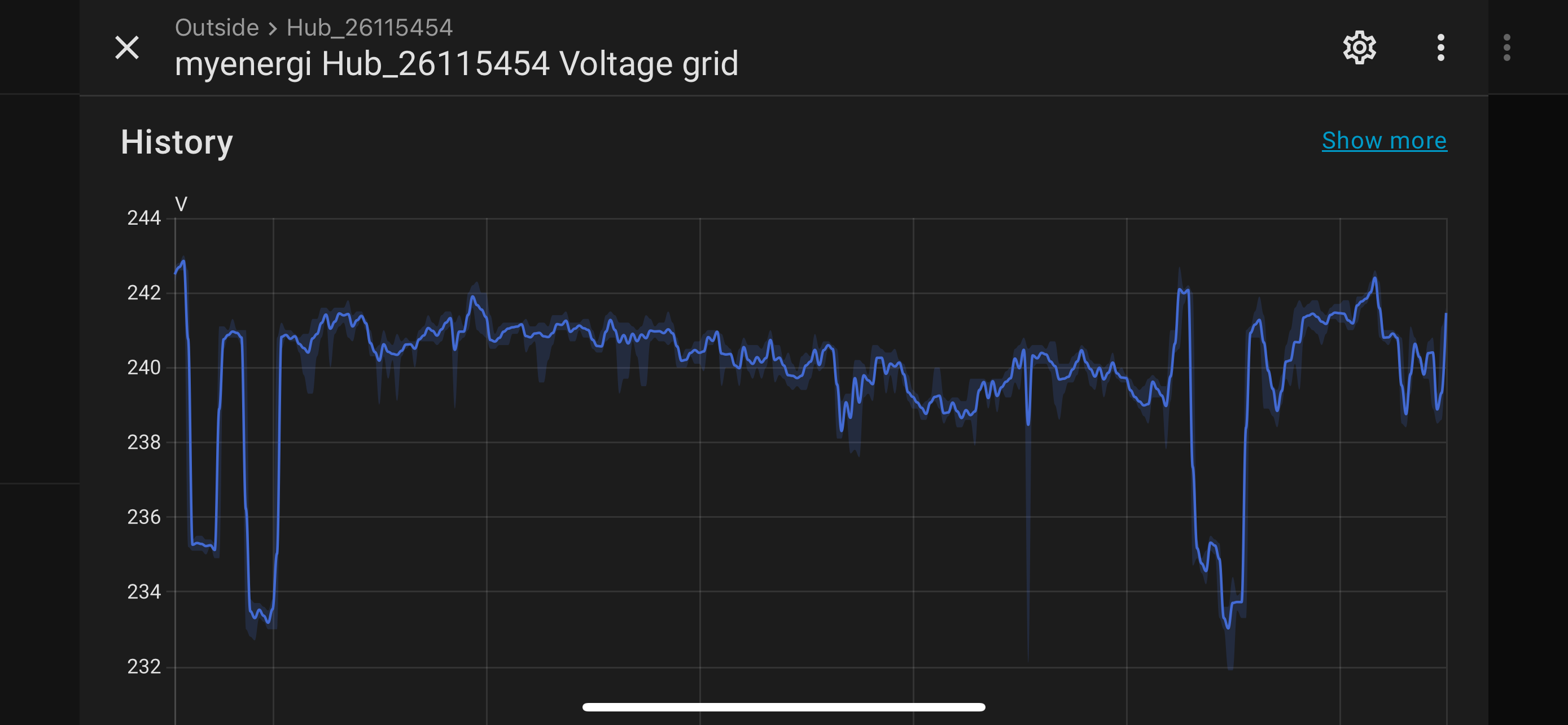

Kelvin Posted September 7, 2025 Posted September 7, 2025 Solved this in a different way. The Zappi tracks the voltage as a diagnostic in Home Assistant.
Kelvin Posted September 7, 2025 Posted September 7, 2025 (edited) The AC voltage at the inverter is slightly higher than what the Zappi is showing. The Zappi is reading this at the meter. The drops (sag) is me initiating charging the storage battery as I was testing being able to control it and automating it from Home Assistant. I’ll check it again tomorrow as it will be a slightly better day for solar generation. Edited September 7, 2025 by Kelvin
-rick- Posted September 8, 2025 Posted September 8, 2025 Those are some quite chunky drops. Guess thats what you get for being in the sticks at the end of a long wire?
Kelvin Posted September 8, 2025 Posted September 8, 2025 The mains cable is only 23m from the overhead line to the meter cabinet and this is being measured at the meter tails. I’ll set up Shelly and have it measure the V at the CU to compare. I have a 12kW inverter and I had it set to charge at 8kW although I’ve settled on 5kW for normal use.
-rick- Posted September 8, 2025 Posted September 8, 2025 1 minute ago, Kelvin said: The mains cable is only 23m from the overhead line to the meter cabinet and this is being measured at the meter tails. I’ll set up Shelly and have it measure the V at the CU to compare. I have a 12kW inverter and I had it set to charge at 8kW although I’ve settled on 5kW for normal use. Voltage isn't measured by the CT at your meter. It's measured at the device, so where your Zappi is. CT measures current. Is there a transformer on the pole or is the overhead line 240V? If the latter, then when I said long wire I meant to the nearest transformer.
Kelvin Posted September 8, 2025 Posted September 8, 2025 (edited) Yes of course. Apologies, I wasn’t very clear. What I meant is the Zappi is installed at the meter on a short cable run rather than elsewhere in the house. The transformer is on the next pole adjacent to the pole I’m attached to. There seems to be a nominal 3V difference between what the inverter shows and what the Zappi shows. Measuring using my multi-meter and it matches the inverter. Edited September 8, 2025 by Kelvin 1

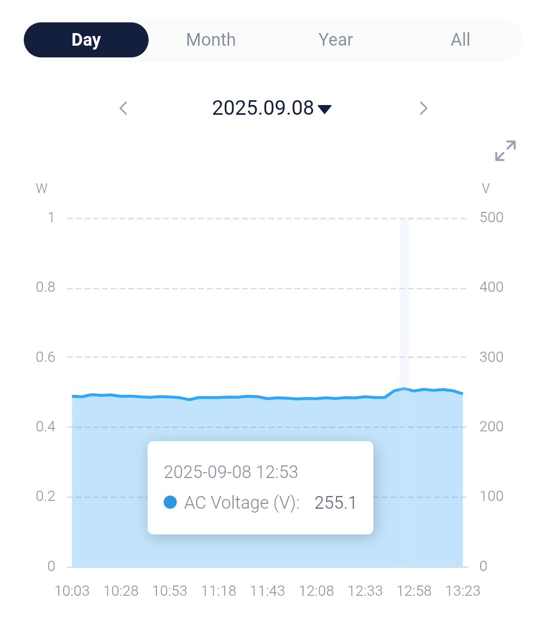

Beelbeebub Posted September 8, 2025 Author Posted September 8, 2025 So this morning my panels were charging my batteries at about 7kw, with around 500w going to my house. The grid voltage was low 240's, maybe 242, 245 etc. Then around 12.40, my battery hit 100% and the system switched to export mode. The DNO limited me to 3.7kw (I can see why) but even so.my voltage jumped well over 250, peaking at 255! It seems to be stabilising around 250ish now, but my connection seems to be a bit crap. I alps noticed they limited me to a 75a supply but I'm pretty sure we have a 100a fuse!
Dillsue Posted September 8, 2025 Posted September 8, 2025 7 minutes ago, Beelbeebub said: The DNO limited me to 3.7kw (I can see why) but even so.my voltage jumped well over 250, peaking at 255! That's the G98 limit that everyone has a concession to export. If your voltage is going over 253v and it's concerning you then let your DNO know and they'll sort it out for you.....they're obliged to if your sticking to 3.68kw of export.
Beelbeebub Posted September 8, 2025 Author Posted September 8, 2025 39 minutes ago, Dillsue said: That's the G98 limit that everyone has a concession to export. If your voltage is going over 253v and it's concerning you then let your DNO know and they'll sort it out for you.....they're obliged to if your sticking to 3.68kw of export. Yeah, they basically stuck me the bare minimum, and I suspect (given the voltage rise) they would have set it to zero if they were allowed. I"ll monitor the voltage and see if they can/will make the required adjustments. I do wonder, I'm in a long thin village and not too far from the transformer. But some other people, presumably on the same line will be a lot further. If the cables are a bit skinny it's possible they have to set the transformer voltage at the high end so the people furthest away aren't too low. If that's the case there may not be much room for adjustment. Oh well. It's not the end of the world, it would be nice to be able to get more export money but ultimately the better option would be to find another use for the spare capacity <starts scrolling through autotrader>

Beelbeebub Posted September 11, 2025 Author Posted September 11, 2025 Just following on, I think my local grid must be pretty rubbish. My voltage got as low as 234v this afternoon before shooting up to 255v repeatedly and tripping my inverter offline. I don't actually mind my export being curtailed, but kicking my I verter offline so I end up importing elec is annoying. 1
Dillsue Posted September 12, 2025 Posted September 12, 2025 14 hours ago, Beelbeebub said: I think my local grid must be pretty rubbish. My voltage got as low as 234v this afternoon before shooting up to 255v repeatedly and tripping my inverter offline. Let your DNO know and they'll have to do sort it out to keep within the 253v limit
Beelbeebub Posted September 12, 2025 Author Posted September 12, 2025 11 hours ago, Dillsue said: Let your DNO know and they'll have to do sort it out to keep within the 253v limit Cheers, I contacted the installer to have a chat as we had a few more spikes over 255v and periods where the 10min average exceeded 253v (which cause shutdowns) today. They said they'd pop round to check everything and also take a calibrated voltage measurement, which will be good because I can then confirm it isn't my inverter being a bit out of tolerance with the voltage reading (I don't think it is). They also said contact the DNO and they should be pretty quick about doing something, especially if it's a setting at the local transformer (changing which output taps they use I assume). So that's on my list for Monday. Anyway, right now I don't actually get paid for any export at the mo, but I've just sent off my Octopus Outgoing application so hopefully I'll start getting paid just in time for the sun to bugger off for the winter!
Dillsue Posted September 13, 2025 Posted September 13, 2025 14 hours ago, Beelbeebub said: I contacted the installer to have a chat as we had a few more spikes over 255v and periods where the 10min average exceeded 253v (which cause shutdowns) today. They said they'd pop round to check everything and also take a calibrated voltage measurement, which will be good because I can then confirm it isn't my inverter being a bit out of tolerance with the voltage reading (I don't think it is). If your trip voltage is configurable get them to raise it a couple of volts so you don't keep shutting down. Theres a pretty good chance that the voltage rise is just within your property and if you measured it at the point your cable connects to the grid it would be within tolerance. You can check by measuring the voltage at your neighbours incoming connection when you're exporting on a sunny day, assuming they'll let you! Get them to turn off any big loads when you measure the voltage.
Beelbeebub Posted September 13, 2025 Author Posted September 13, 2025 3 hours ago, Dillsue said: If your trip voltage is configurable get them to raise it a couple of volts so you don't keep shutting down. Theres a pretty good chance that the voltage rise is just within your property and if you measured it at the point your cable connects to the grid it would be within tolerance. You can check by measuring the voltage at your neighbours incoming connection when you're exporting on a sunny day, assuming they'll let you! Get them to turn off any big loads when you measure the voltage. I'm not sure if my neighbours are on the same "branch" as me. Ours is a newer build (as in built after 1900) and I seem to remember a power cable was dug in for it back down to the road because the existing one was too crap. I will get the voltage at the meter read and compare it with the voltage at the inverter just to check there isn't an issue in the connection between the inverter and grid or the internal voltage sensor isn't out of whack.
Beelbeebub Posted November 5, 2025 Author Posted November 5, 2025 Just to tie this up..... My DNO came out, they poked about, took some measurements and concluded they could change the tap on my transformer. This involved some backfeeding via links to other transformers and de-energizing my transformer, but there was no supply interruption and the change was seamless. Took a week or so to happen. They called to say they had done it. He mentioned they actually found a fault when they did the work which might have been making the spikes worse. Now my normal voltage is high 230's to low 240's and I don't think i've seen over 250. The only question now is: will this allow me to export more! 3
