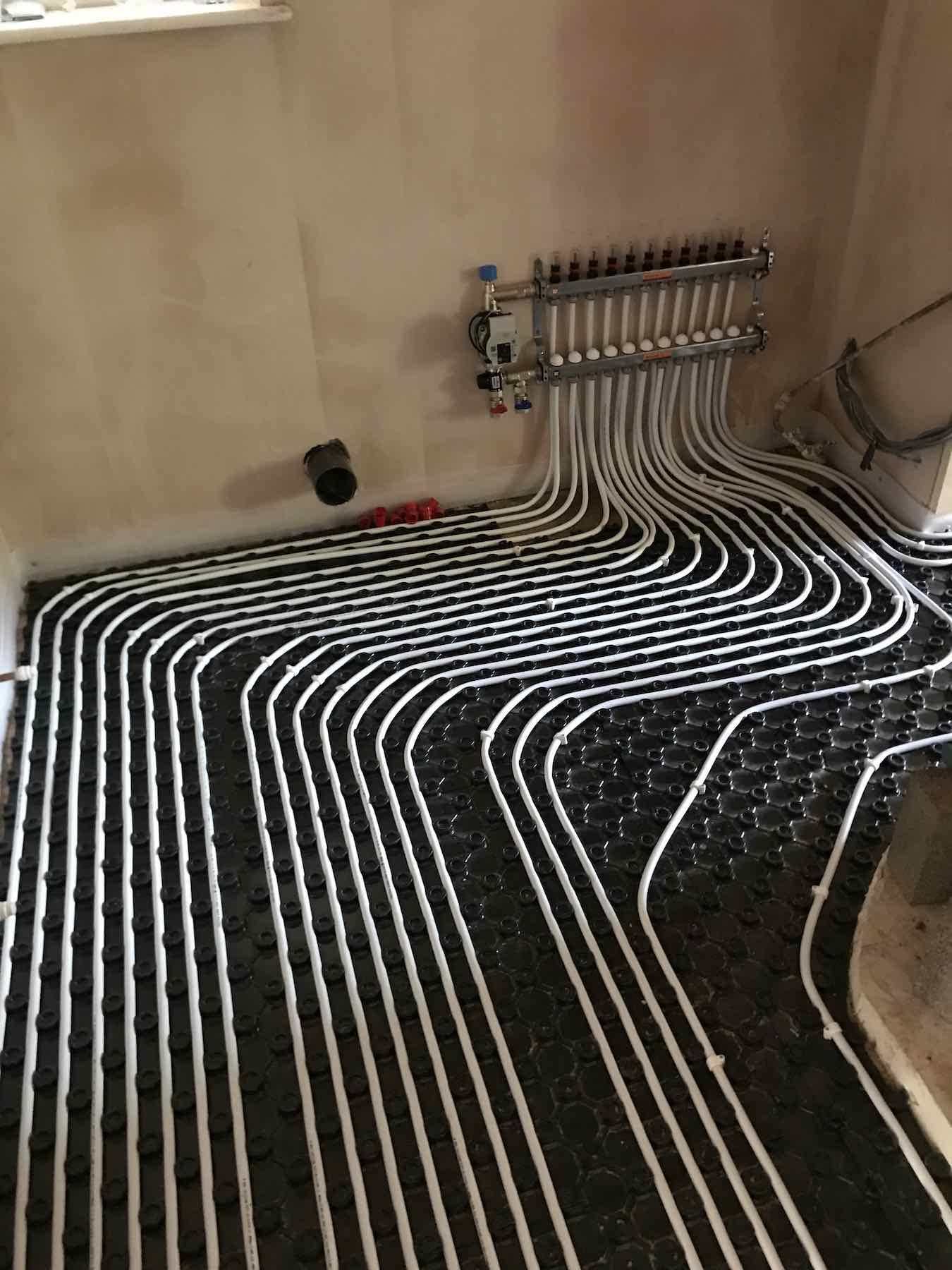

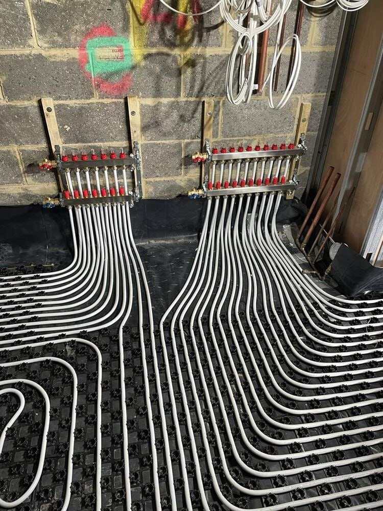

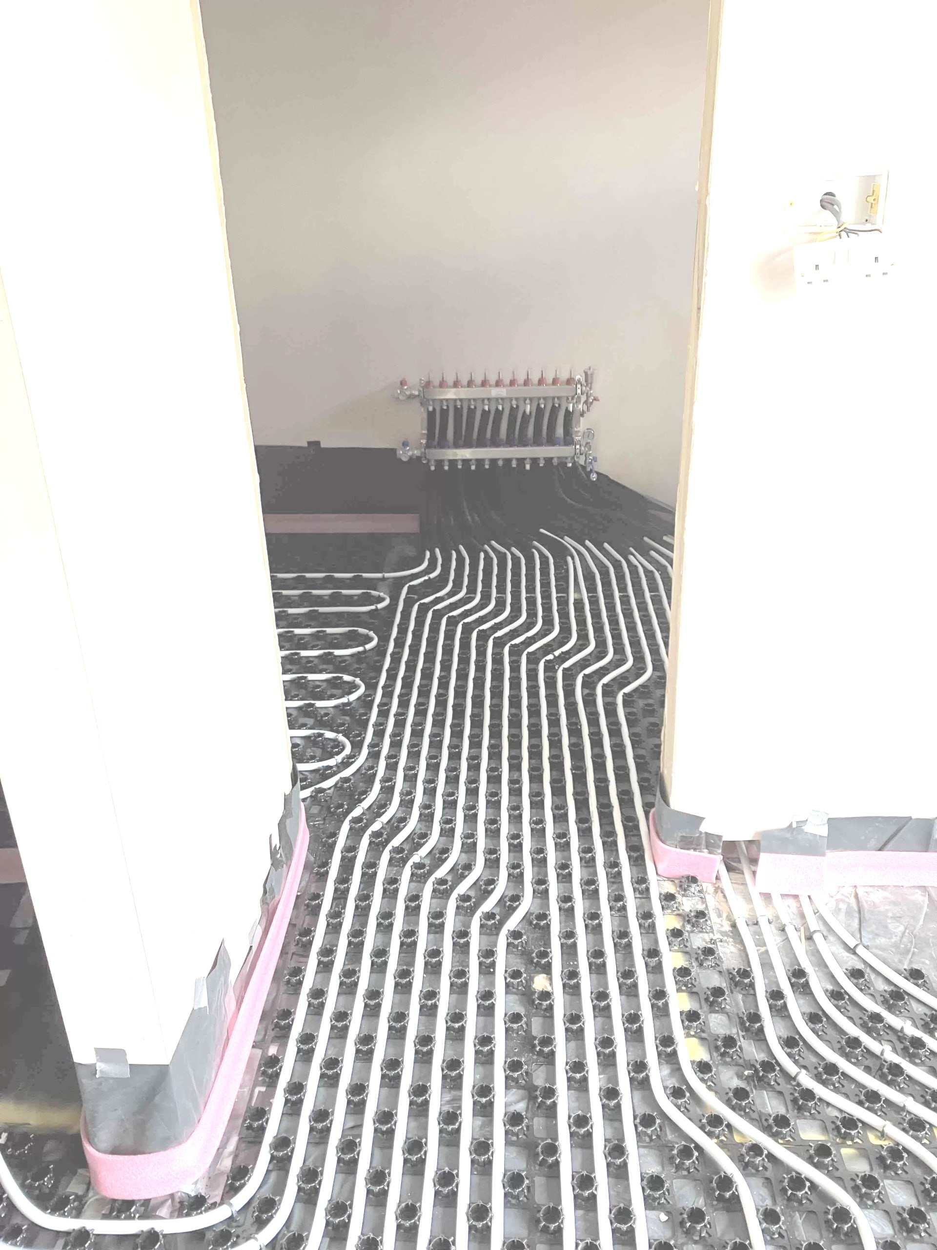

September 5, 20251 yr Author Here's some examples of masses of transition pipes at 50mm spacings, NOT sleeved. Must result in over heated areas above 27 to 29 degrees if the flow temps are set to achieve 27 to 29 in the rooms they are going to? Is my assumption correct, that if a flow temp and flow rate for a particular circuit to achieve a floor surface temp (top of screed) of N degrees (27, 29 etc.), then bunching up a load of transition pipes together with closer spacing, will result in a higher floor surface temperature? LoopCAD doesn't seem to model this; looks like it creates an 'average' floor temp (can't see an analysis view for hot spots 🥵) What about short-circuiting from flow to returns, at what is the extremeity of the circuit (hottest part of the flow, coolest part of the return)? I can't see how the floor temperature can be controlled in these areas 🥵. Surely will lead to much higher floor surface temperature, for whatever floor covering is going above (tile or brick slips would be fine, but carpet, wood etc. Edited September 5, 20251 yr by James of the North
September 5, 20251 yr 2 hours ago, James of the North said: Surely will lead to much higher floor surface temperature The temperature will be limited by the water temperature supplied, so it will just reach the maximum temperature of 27 to 29 quicker - it can't go higher than that. 2 hours ago, James of the North said: What about short-circuiting from flow to returns No problem; the hot water is still being pushed through the pipes, so the floor will warm up.

September 7, 20251 yr Author On 05/09/2025 at 22:20, JohnMo said: LoopCad does analyse the bunched pipes, our utility showed a huge overheat just by transiting pipes, I added insulation to the flow pipes the overheat went away. If you had a 4m wide room, with a bunch of transition pipes at one side only, LoopCAD does not highlight that as being a hot spot - all it does is show an average floor surface temperature for the entire floor (in that view). Beyond some distance (say 1m) from the bunch of transition pipes, there won't be any increased floor surface temp due to the transition pipes. I don't think the average for the floor would be correct either.
September 7, 20251 yr Author On 05/09/2025 at 21:25, Mike said: The temperature will be limited by the water temperature supplied, so it will just reach the maximum temperature of 27 to 29 quicker - it can't go higher than that. I disagree. If the flow temperature was say 40 degrees, what is to stop the floor surface temp increasing way beyond 27 to 29, where you have very close pipes in transition? The rest of the room where you have normal pipe spacings, yes, you design the flow rate to ensure 27 to 29 degrees, so an area of floor with much closer pipe spacing would lead to a higher surface temp. In this type of situation you essentially have two different set of parameters, which will ulitmately lead to two different floor surface temperatures.

September 8, 20251 yr On 07/09/2025 at 12:10, James of the North said: I disagree. If the flow temperature was say 40 degrees, what is to stop the floor surface temp increasing way beyond 27 to 29, where you have very close pipes in transition? Because @James of the North is asking about increasing pipe spacing in specific rooms, not 50mm pipe spacing near the manifold (where a somewhat higher temperature would occur).
