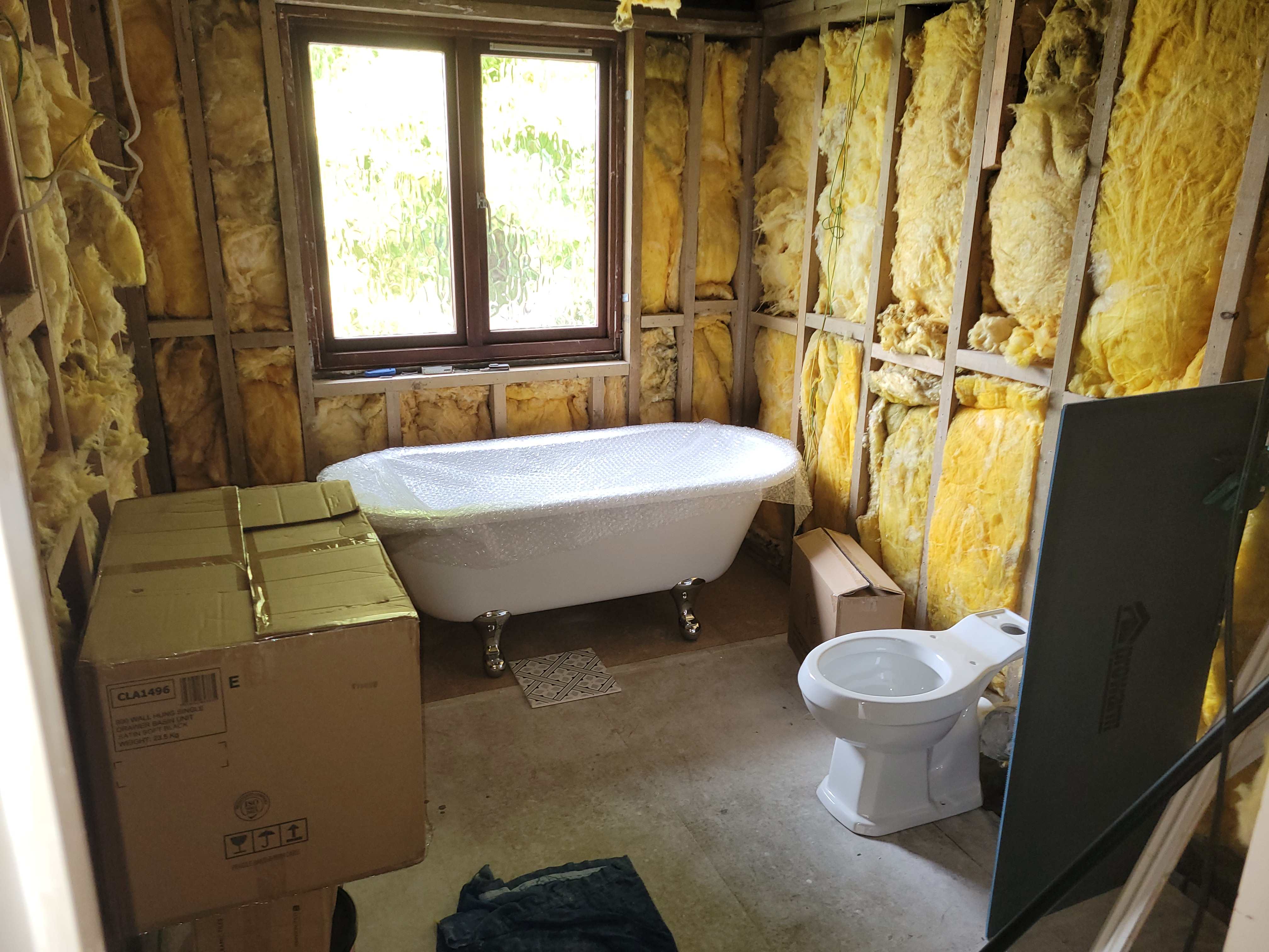

Iceverge Posted September 9, 2025 Posted September 9, 2025 Woah woah woah........ On 04/09/2025 at 10:18, pajw said: The outside of the frame there is cement render over a layer of ply and there is a waterproof membrane between the ply and frame. This sounds like the wall has an impermeable layer outboard of the timer frame. Any sketches or pictures of the build up please to help us understand? I very much doubt your membrane is a fancy low permeability one. In any case I very much suspect that the wall was drying to the inside rather than the outside. Putting PIR between the studs would trap the sheathing between two layer of low permeability which really is a no no. Pics please...

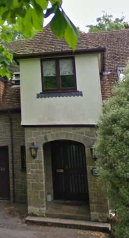

pajw Posted September 15, 2025 Author Posted September 15, 2025 Here are a couple of pictures to hopefully help explain what I am trying to do. Bathroom is above porch and has three external walls. Timber frame is made from 140x47mm timber, currently has 100mm of rockwool in the wall, Would like to improve insulation while I have the plasterboard off but not sure what would be best. External surface seems to render on ply with a waterproof membrane between the ply and timber frame. House was built in 1987 so not sure what the membrane (sorry if that is wrong word) is. It isn't roofing felt. Forgot to take a photo of it.
pajw Posted September 15, 2025 Author Posted September 15, 2025 I've only lived there since last year so have only experienced one winter and the bathroom didn't feel particularly cold. Had to take the plasterboard off as it was damaged removing the tiles. Just wondering if i should improve the insulation while i have the opportunity. OPtions I can think of 1) Do nothing, leave 100mm rockwool 2) Add 50mm rockwool to fill up gap without compressing rockwool. 3) Add 100mm rockwool (compressed into 140mm gap with original 100mm rockwool) 4) Remove rockwool and install 100mm PIR insulation board (leave 40mm gap) 5) install 100mm PIR and fill 40mm gap with rockwool I'm sure there are other options. Any advice about what to do would be gratefully received. Don't want to do something and end up with condensation and a rotten frame. Frame has no sign of damp after 40 yrs so don't want to cock it up. As Iceverge said in an earlier post the outer wall is probably impermeable so any moisture would dry to the inside.
Iceverge Posted September 15, 2025 Posted September 15, 2025 Firstly I'm not seeing any ventilation in the bathroom? I would make sure this is completed as part of the remodel. Get a Greenwood CV2GIP ( keep an eye on eBay for a cheap one). Get an appropriate hole in the wall/ceiling venting to the outside. In any case I would maybe remove one bay of insulation to inspect the plywood sheathing behind it. If it's in good condition I would replace the glasswool. I would buy another pack of it and fill any voids in the current insulation. Don't use PIR or something impermeable. You'll only make trouble. Then buy a variable SD airtightness membrane. Something like Gerband Vario, intello pro clima or Siga Marjrex. Diligently cover the walls with it, taping all joints and penetrations. Do the same on the ceiling and tape it to the floor also. The aim is to 100% ensure that any drafts cannot blow through the wall Via gaps and cracks in the structure. Tape the membrane to the doors and windows with airtighess tape. Next run 50x50mm battens horizontally over the studs at 400mm centres to create an insulated service cavity. Add extra blocking for any heavy fixings needed in the bathroom. Insulate with 50mm mineral wool. Add some marmox board of jackoboard to the window reveals and head. Plasterboard and tile/skim as needed. Wall u value will be about 0.25 but it's the Airtightness and lack of drafts will make it quite comfortable. ( Ensure the floor+ceiling is well airtight sealed and insulated underneath too). 1
saveasteading Posted September 15, 2025 Posted September 15, 2025 1 hour ago, pajw said: Do nothing, leave 100mm rockwool what you show was state of the art, but about 30 years ago. It's thin, irregular, and gappy. And there are old bridges from the room through the timbers to outside. Its a matter of balancing cost and benefit. Youll find much more previous dicsussion on here. I think, 1. keep what is there but straighten it out, and add an extra thickness... how much would it take? 20mm? PIR is best for insulation. Or replace what is there with PIR. BUT it is tricky to fit tight so maybe you'd end up pushing in the fibreglass again, or a boarded version. Then an insulating inner layer over the surface would kill the cold bridging.
