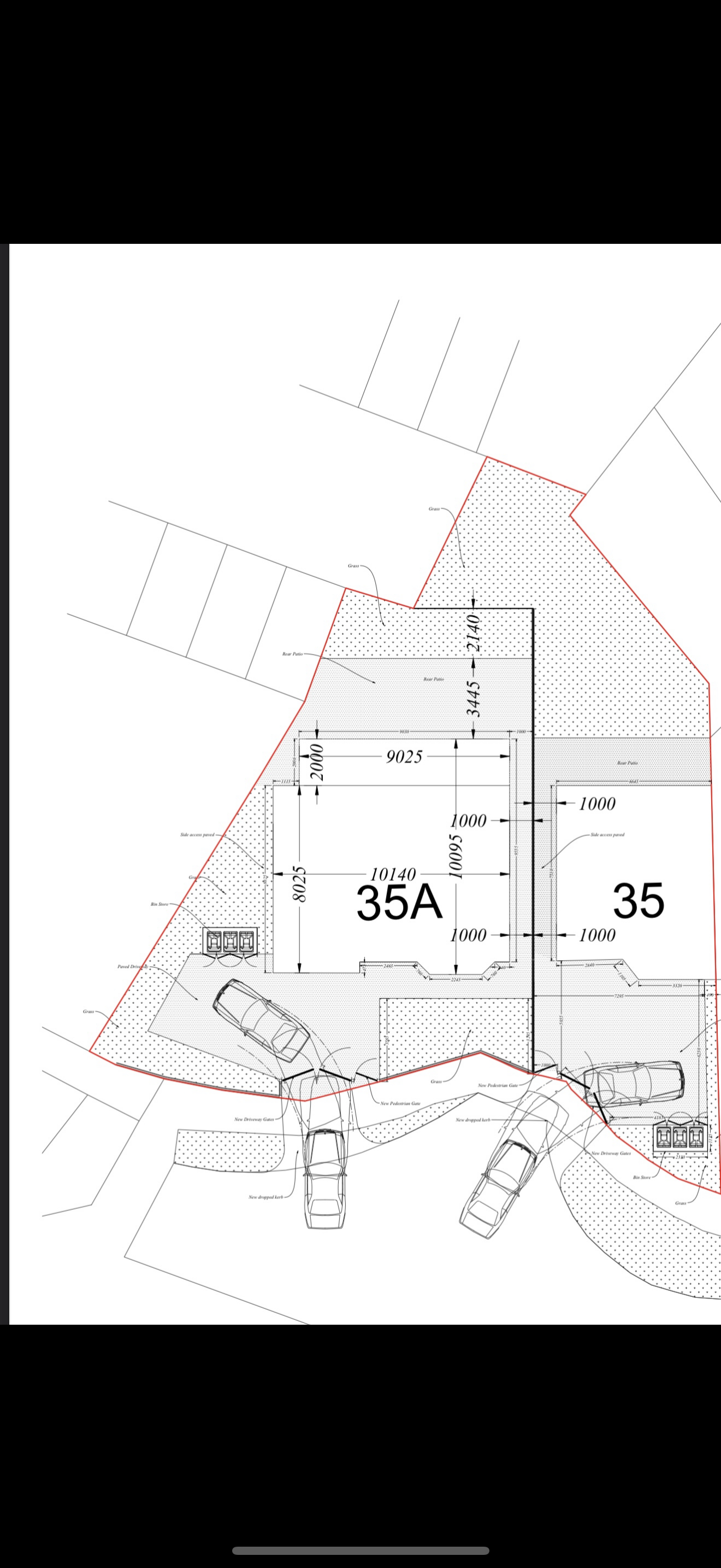

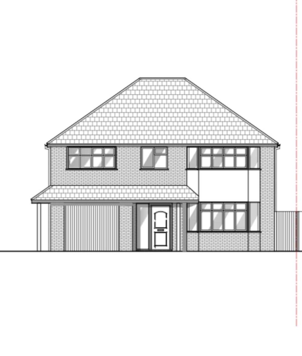

Bluebaron Posted Thursday at 12:07 Author Posted Thursday at 12:07 (edited) Thanks all, I’ve spoken with the LPA and they stated that overall there’s a good chance of success in planning. She stated that we failed to submit any updates following consultee concerns. Mainly the tree/highways reports requested clarification on a few points. it’s annoying as I pointed this out to my agent and he emailed them asking if they needed it pre deadline but received no reply. They also wanted a water neutrality statement, pre deadline, but again there was nothing to suggest this is a pre planning requirement and we assumed could be added as a condition of planning. (I have even had the report on my desk ready to go for 6 weeks). Regarding cramped and overbearing I’ve accepted I maximised the house but it similar in size and look to surrounding properties but I concede is a bit tight on the plot. (Didn’t help that again my agent added the wrong rear boundary line/division of plots) I suggested to my agent that we lose the front left top corner (see below) to soften it a bit leaving the footprint the same. This will add a lot to build costs though as more complex roof. the full report is due tomorrow so, as stated, above will be like a pre-app and provide more guidance on resubmission. i have a planning guy who wants to charge me £3200+vat to redo it but I’m wondering if its worth it as im so close already? Edited Thursday at 12:10 by Bluebaron

Conor Posted yesterday at 06:43 Posted yesterday at 06:43 I think you are too tight to the LHS boundary. Do you have access to the plot from the back? If not, once you have footings in, it's going to be hard to get materials and plant round to the back. Where are you going to store materials during the build? Site toilet etc etc? Need to think a bit about constructability.
Bluebaron Posted 22 hours ago Author Posted 22 hours ago Yes I have full rear access and own the plot next door. The LHS is bordered with a local park. 1
