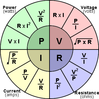

SteamyTea Posted September 20, 2025 Posted September 20, 2025 On 25/08/2025 at 07:35, Alan Ambrose said: Regarding current and cable size at low voltage - the whole point of LEDs is that they are much lower power than the old fashioned lights they replace But possibly a different resistance. So may be the square of the current.
