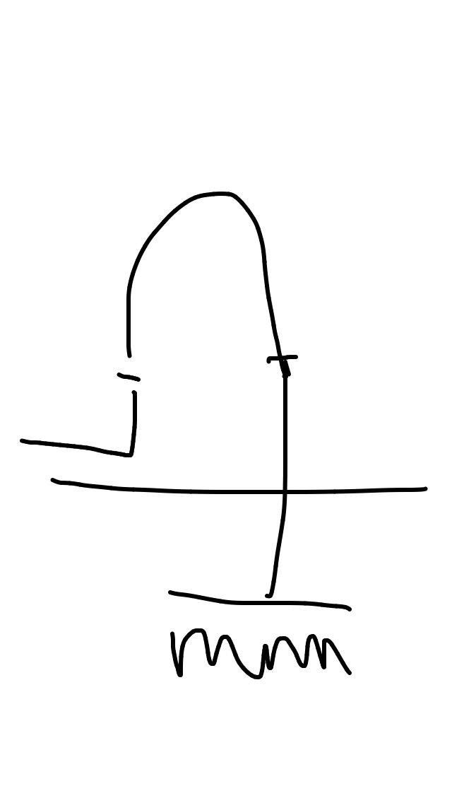

Onoff Posted May 29, 2018 Author Share Posted May 29, 2018 Playing around with a 500mm flexi pipe trying to envisage a rise and fall mechanism. Not looking promising as the pipe wants to twist as it rises. The worry is it would eventually loosen either the compression and to the copper or tap connector to the rainfall head. Link to comment Share on other sites More sharing options...
PeterW Posted May 29, 2018 Share Posted May 29, 2018 Turn the drawn bend 180 degrees and make it point upwards and parallel to the rise and fall but about 200mm away. A 600mm flexi will then allow it to rise and fall if it’s vertical in the loop plane Link to comment Share on other sites More sharing options...
Onoff Posted May 29, 2018 Author Share Posted May 29, 2018 52 minutes ago, PeterW said: Turn the drawn bend 180 degrees and make it point upwards and parallel to the rise and fall but about 200mm away. A 600mm flexi will then allow it to rise and fall if it’s vertical in the loop plane Good shout. Do you mean turn upward the far 90 or further bend the start of the passover and cut there? Link to comment Share on other sites More sharing options...
PeterW Posted May 29, 2018 Share Posted May 29, 2018 I’d just cut near the head and rotate 180. Link to comment Share on other sites More sharing options...
Onoff Posted May 29, 2018 Author Share Posted May 29, 2018 2 minutes ago, PeterW said: I’d just cut near the head and rotate 180. You're going to have to sketch it pls... Link to comment Share on other sites More sharing options...
PeterW Posted May 29, 2018 Share Posted May 29, 2018 16 minutes ago, Onoff said: You're going to have to sketch it pls... 1 Link to comment Share on other sites More sharing options...
