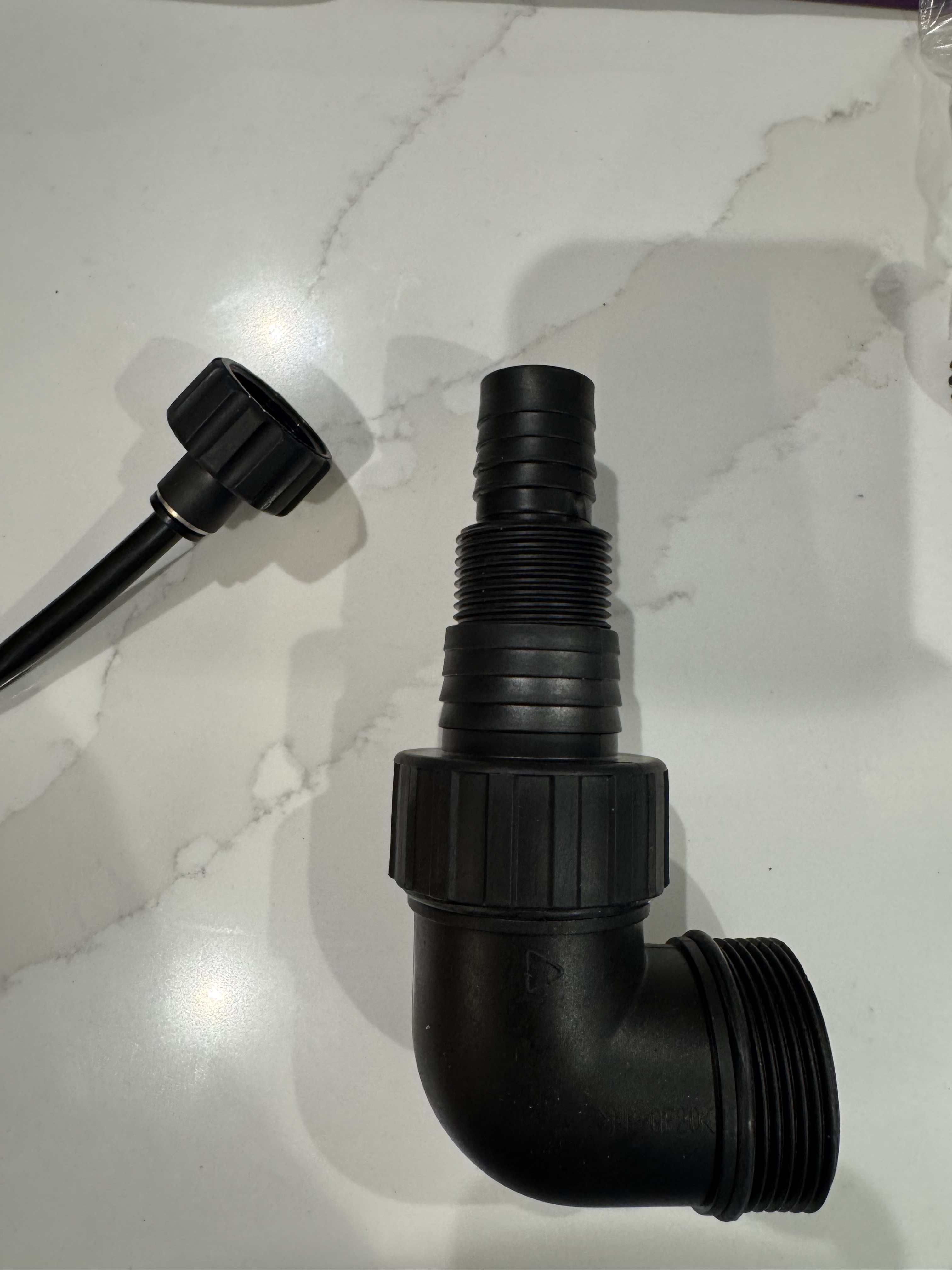

Pocster Posted August 19, 2025 Posted August 19, 2025 No matter how many ‘water’ fittings I have - never the right one . The sump connector output is barbed - way too big . My pipe ( on the left ) with a nice and easy tap connector on at the moment . Cant seem to find a suitable connector which ever way I try it .. What do I need here ??
ProDave Posted August 19, 2025 Posted August 19, 2025 The one on the right looks to be the connector that comes with a big submirsible pump. the multi barbed fitting is for connecting to different sizes of delivery hose. Where does the skinny pipe on the left fit into this? explain what you want to connect to what?
Gone West Posted August 19, 2025 Posted August 19, 2025 (edited) 41 minutes ago, Pocster said: What do I need here ?? The left hand tap connector looks as though it will fit on the small threaded part of the right hand connector, if the small barbed bit is cut off. Then what do you want? Edited August 19, 2025 by Gone West 1
Pocster Posted August 19, 2025 Author Posted August 19, 2025 Just now, Gone West said: The left hand tap connector looks as though it will fit on the small threaded part of the right hand connector, if the small barbed bit is cut off. Then what do you want? Won’t fit if I cut the barb off - thought of that 1 minute ago, Gone West said: Then what do you want? So many things . But for now a generic connect any size pipe to any other size pipe magic thingy
Pocster Posted August 19, 2025 Author Posted August 19, 2025 29 minutes ago, ProDave said: Where does the skinny pipe on the left fit into this? explain what you want to connect to what? That’s for a watering system - so has to be a skinny
Gone West Posted August 19, 2025 Posted August 19, 2025 4 minutes ago, Pocster said: Won’t fit if I cut the barb off So is the left hand connector a 3/4" BSP.
Pocster Posted August 19, 2025 Author Posted August 19, 2025 8 minutes ago, Gone West said: So is the left hand connector a 3/4" BSP. I think so . I only stuck that on to test with a threaded tap - so it’s not a requirement to have that .

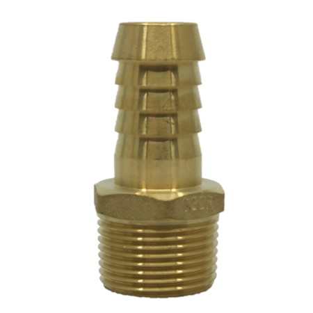

-rick- Posted August 19, 2025 Posted August 19, 2025 Stupid ugly quick option: Buy/find a short length of hose that fits the barb and a barb to male BSP adapter, ala: You could probably find a reducer that goes straight from barb to your tiny hose though if you look. What are you actually trying to do? Going from such a big outlet to the piddly hose suggests maybe need to go back to the drawing board.
Onoff Posted August 19, 2025 Posted August 19, 2025 https://www.thingiverse.com/search?q=1%2F2"+bsp+to+hose+connector&page=1 1
ProDave Posted August 19, 2025 Posted August 19, 2025 Can I enquire why you want such a tiny hose ultimately connected to such a big fitting. It seems very unusual to say the least.
Onoff Posted August 19, 2025 Posted August 19, 2025 Just find the two thread sizes and print a M/F adapter? Then do away with the barbed bit altogether.
-rick- Posted August 19, 2025 Posted August 19, 2025 (edited) If you can find a blank for that rather than a fitting (either male or female - assuming that right angle is the same diameter/thread at each end) you could always get one of these and tap the plastic (you'd need the tap too of course): https://www.airsupplies.co.uk/npt-male-stud Still, the question keeps being asked, what are you doing? If you are just using a big tank as a water source to feed a pumped irrigation system then don't bother with any of this just get a submersible pump and put it in the tank with the little hose attached. Or, see if you can't find a different outlet/drillable boss on the tank to use rather than this huge fitting. Edited August 19, 2025 by -rick-
