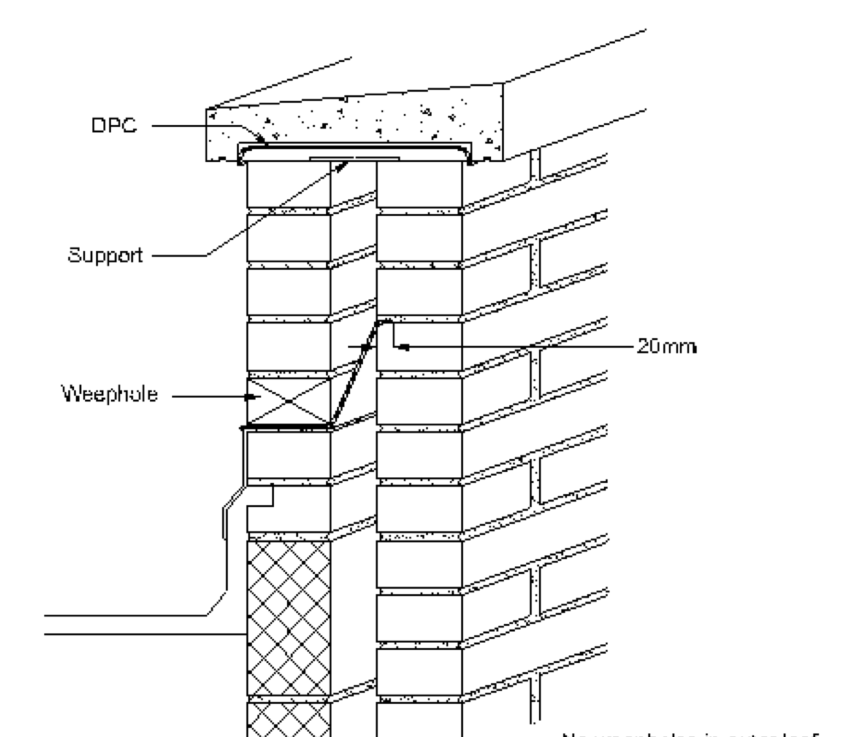

LnP Posted August 16, 2025 Posted August 16, 2025 16 hours ago, LnP said: Should there be a cavity tray below the coping in the parapet? I was building a flat roof very similar to yours with a parapet around the edge. The DPC was in place and copings had been installed but not yet pointed when we had a couple of days of very heavy rain. I had water dripping through light fittings in the room below. Water was getting past the copings because they hadn't been pointed yet and the DPC had not been installed properly. The builder had to take off the copings and a couple of courses of bricks to install the cavity tray with weep holes and sort out the DPC. It's belt, braces and a piece of string. It's quite likely the pointing will eventually fail so if you don't have the cavity tray, all you've got is the DPC. A cavity tray with weep holes is very cheap and easy to install during the build, not so easy to retrofit.

flanagaj Posted August 16, 2025 Author Posted August 16, 2025 3 hours ago, LnP said: I was building a flat roof very similar to yours with a parapet around the edge. The DPC was in place and copings had been installed but not yet pointed when we had a couple of days of very heavy rain. I had water dripping through light fittings in the room below. Water was getting past the copings because they hadn't been pointed yet and the DPC had not been installed properly. The builder had to take off the copings and a couple of courses of bricks to install the cavity tray with weep holes and sort out the DPC. It's belt, braces and a piece of string. It's quite likely the pointing will eventually fail so if you don't have the cavity tray, all you've got is the DPC. A cavity tray with weep holes is very cheap and easy to install during the build, not so easy to retrofit. I'll mention this. Thanks
