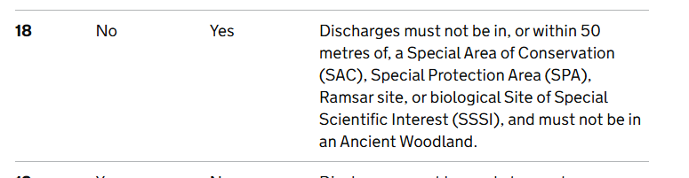

flanagaj Posted August 11, 2025 Author Posted August 11, 2025 (edited) I need to learn to read!! I have just given myself a great deal of stress and time completing the EA permit form. The Rules state Rule 18: make sure the discharge point is not in or near protected sites You cannot meet the general binding rules if the discharge will be in an ancient woodland or in or within 50 metres of any: special areas of conservation special protection areas Ramsar wetland sites biological sites of special scientific interest (SSSI) It states in an ancient woodland, not within 50 metres of an ancient woodland. Edited August 11, 2025 by flanagaj
ToughButterCup Posted August 12, 2025 Posted August 12, 2025 Where will the discharge (as opposed to the treatment plant) be? Better said where will the treated water exit the outflow pipe ? As written above, it appears to me that the problem might be solved by lengthening the discharge pipe by a few meters ( in your case at least 5 meters). Ours is 80 meters from the treatment plant.
flanagaj Posted August 12, 2025 Author Posted August 12, 2025 (edited) 31 minutes ago, ToughButterCup said: Where will the discharge (as opposed to the treatment plant) be? Better said where will the treated water exit the outflow pipe ? As written above, it appears to me that the problem might be solved by lengthening the discharge pipe by a few meters ( in your case at least 5 meters). Ours is 80 meters from the treatment plant. There is no problem. The rules state 'within' and ancient woodland. My drainage field is 43m away from the woodland. I just misread and thought the rules meant that you could not have a drainage field within 50m of an ancient woodland. Another EA document, words the statement with better clarity. Edited August 12, 2025 by flanagaj
