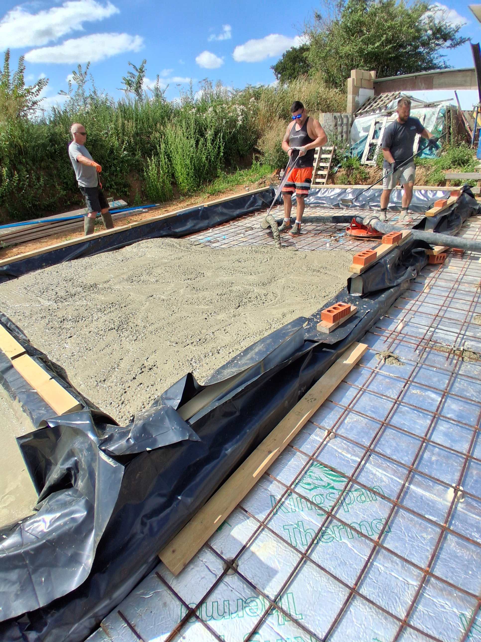

LSB Posted August 10, 2025 Posted August 10, 2025 A mortar question for you guys. I am laying Celcon 7.3n blocks using a mortar mix of 5 to 1 (measured out by eye on the shovel) with blue circle cement and building sand from Travis Perkin and an additive to help the mix. The problem that I am getting is after a week or so the strength of the joint is surprisingly weak with little effort or pressure required to break the block off usually with a neat break with the mortar “delaminating” from the adjacent block or concrete foundation. Where am I going wrong ? What do I need to do to get a stronger bond. We had concrete floors poured on Friday and there pump pipe knocked down 4 blocks as they went from area to area. The wall has gaps for doorways so is only 4 blocks, is it just that this is too few blocks for a very heavy pipe. Obviously, as it's built up it will be supported by lintels above the door ways. The blocks were laid weeks ago, prior to us preparing the floor ready for pouring.

JohnMo Posted August 10, 2025 Posted August 10, 2025 7 hours ago, LSB said: Celcon If you wet the blocks before cementing, they will stick together way better. The blocks suck all the water out of the cement and you are left with nothing to cure. Hence it being very weak bond. 1 1

Russell griffiths Posted August 11, 2025 Posted August 11, 2025 In this weather you can happily stand and soak the blocks with a hose pipe before laying, just soak the stacks of blocks while the mixer is getting loaded up. 1
