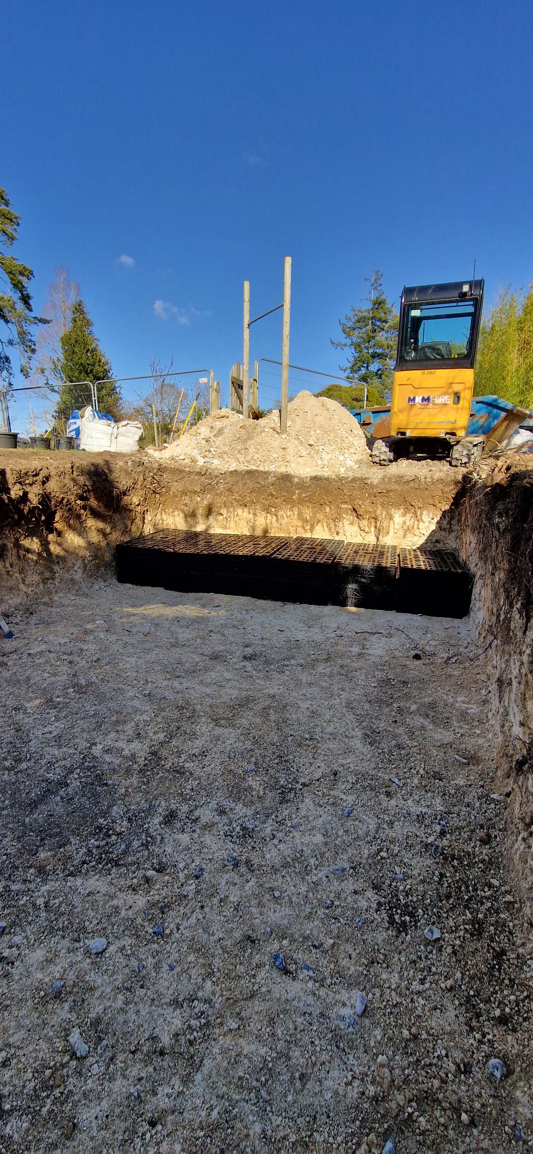

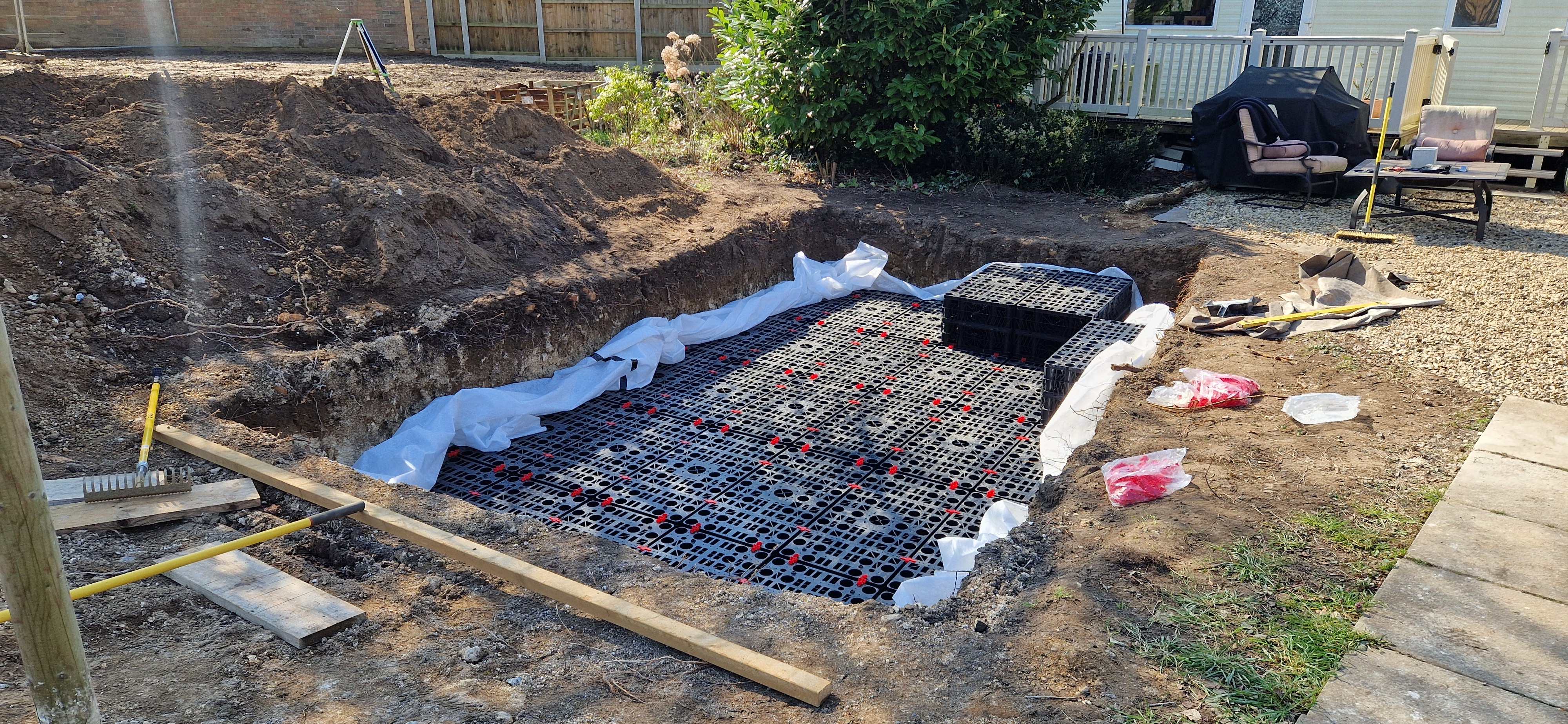

Anecdotally, if anyone is feeling frustrated by the amount of work needed for a Soakaway, know that this is what we had to have for our modest (200m2) 4-Bedroom house. 96 standard sized crates in 2 layers (though these are larger crates so there are *only* 60). Just under 20,000 litres. LOL.
Edited by Mulberry View
Yes I was surprised at how big a hole we were going to need if using crates. The problem we had was we are on a considerable slope so digging said big hole into the side of the hole wasn’t going to be easy or practical. I suggested terracing the slope into three wide terraces primarily to give us a bit more useable garden area which also afforded the long trench way of doing it in the middle terrace.
200 sqm house so maybe 150sqm of roof including a garage? How did you end up at 20 cube of soak away?
Because we're founded on hard chalk. Made for great foundations, but less so for water infiltration.
The bottom of this hole is like a bathtub, the soakaway was designed to potentially be half-full most of the time.
20m3 / 200m2.   100mm of rain. Best stay indoors.
