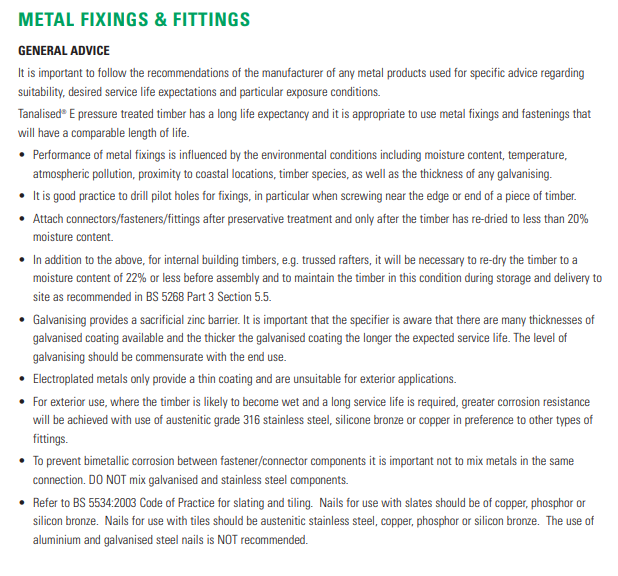

gavztheouch Posted August 4, 2025 Posted August 4, 2025 Hi I have some 47x50mm pressure treated battens (The green coated ones) My screws to attach the battens are 180mm heco-topix that hold on 60mm insulation too. They have a standard galvanised finish. Im worried that they won't last the hopefully life of the cladding about 50 years. apparently the copper in the pressure treatment will cause the screw to rust fast. A solution would be to use stainless screws (very expensive @ 180mm) or change to a non copper based treatment. batten. I have struggled to find decent battens at 50x50mm, most batten are made from crap wood. I guess I could have them milled from something naturally durable like larch but I assume there is a solution already out there or I am overthinking things again

saveasteading Posted August 4, 2025 Posted August 4, 2025 6 hours ago, gavztheouch said: battens at 50x50mm, most batten are made from crap wood. Yes they usually have lots of knots, because they only span 600mm. the price relates to that. ask your local timber merchant for better, quality. Tanalised is standard in 47 x 47 structural timber but it costs more. I think moisture is critical to corrosion, so internally should be no problem. Given what it say here, there should be fixings with extra galvanising for exposed conditions.

gavztheouch Posted August 6, 2025 Author Posted August 6, 2025 Thanks everyone a few good options here. Looks like it’s a sensible option to use stainless steel. just need to decide if I stick with the pressure treated spruce or ‘upgrade’ to thermopine. In theory the thermopine might be longer lasting but I guess it’s hard to prove without testing it myself for 50 years, which I can’t. My biggest worry was the screws rusting, I guess stainless helps there. @Duncan62 did you have any issues with the stainless screws snapping. im hoping for 50 years out of the larch cladding which I think is possible. Some of our shed doors at the farm are wood and still in good condition. Need to decide if pressure treated spruce can match the 50 year lifespan
