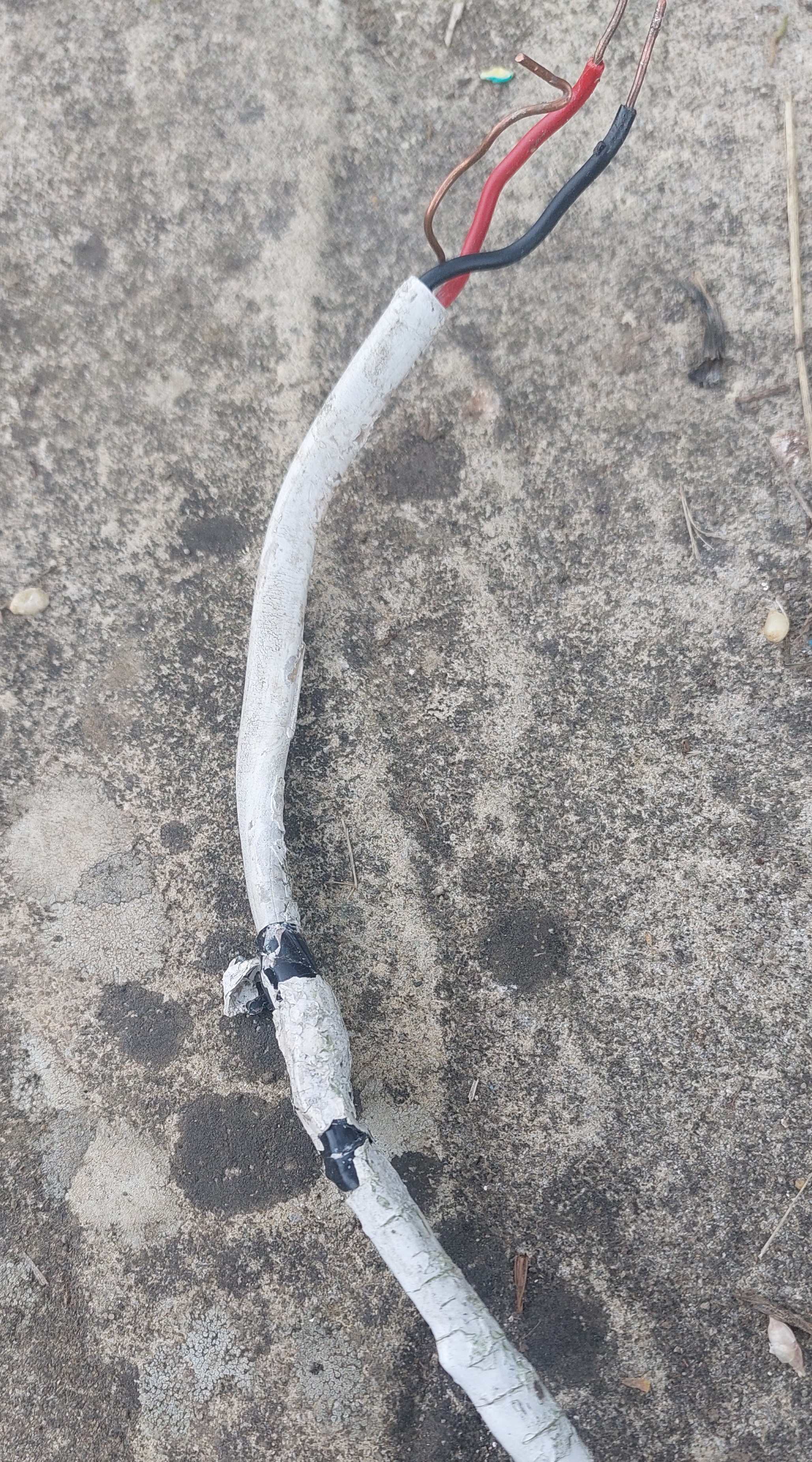

saveasteading Posted July 28 Author Posted July 28 Basics question. I turned off the circuit yesterday at the local switch in the house, and the relevant circuit at the consumer unit... I think it only supplies this one cable. I disconnected the box to change to a better one. That went well, and the metal gland is solid. No sparks or drama from the now exposed cable. Meanwhile, the primary rcd tripped in the house. How can that happen if the power is off?
SteamyTea Posted July 28 Posted July 28 19 minutes ago, saveasteading said: Meanwhile, the primary rcd tripped in the house. How can that happen if the power is off? Purely guessing here, but it it a safety feature of that RCD i.e. double isolation. Or it could be that some stray current from something in the house i.e. a capacitor in a charging circuit, put enough juice down the line. I think RCDs are omnidirectional, but as I said, guessing here. 2
Nickfromwales Posted July 28 Posted July 28 42 minutes ago, saveasteading said: Basics question. I turned off the circuit yesterday at the local switch in the house, and the relevant circuit at the consumer unit... I think it only supplies this one cable. I disconnected the box to change to a better one. That went well, and the metal gland is solid. No sparks or drama from the now exposed cable. Meanwhile, the primary rcd tripped in the house. How can that happen if the power is off? Neutral to earth got shorted. Unless you’re off an RCBO the phase to earth imbalance will trigger the earth protective device (30ma) but also will happen in the event of a neutral to earth ‘short’. An earth trip utilises a coil that is connected across L and N, and when in normal play the difference between those is zero. If you touch a live wire and start dumping some of that potential through your body, to earth, then the sum of that discharge is apparent across the L and N, so (roughly speaking) if you drew down >30ma then >30ma of current would flow through the coil. That would trigger the device so it ‘trips’. If you connect neutral to earth the floating potential in these cables (from EMF) does the opposite, and energises that coil, again causing a trip. 3
saveasteading Posted July 28 Author Posted July 28 so should i turn off that rcd, and/or the one in the consumer unit, before doing any more? I have stupidly forgotten to put the cable through the hockey stick. So not a lot achieved! If it was a straight pipe i might slice the length and insert the cable, but that wont work with the bend.
Nickfromwales Posted July 28 Posted July 28 9 minutes ago, saveasteading said: so should i turn off that rcd, and/or the one in the consumer unit, before doing any more? I have stupidly forgotten to put the cable through the hockey stick. So not a lot achieved! If it was a straight pipe i might slice the length and insert the cable, but that wont work with the bend. You can switch it off, or just tape over the earth whilst you’re pulling this in, just so none of the dead conductors can touch. That includes preventing the neutral hitting an earth connection/tag. That’s doable if you want minimal disruption.

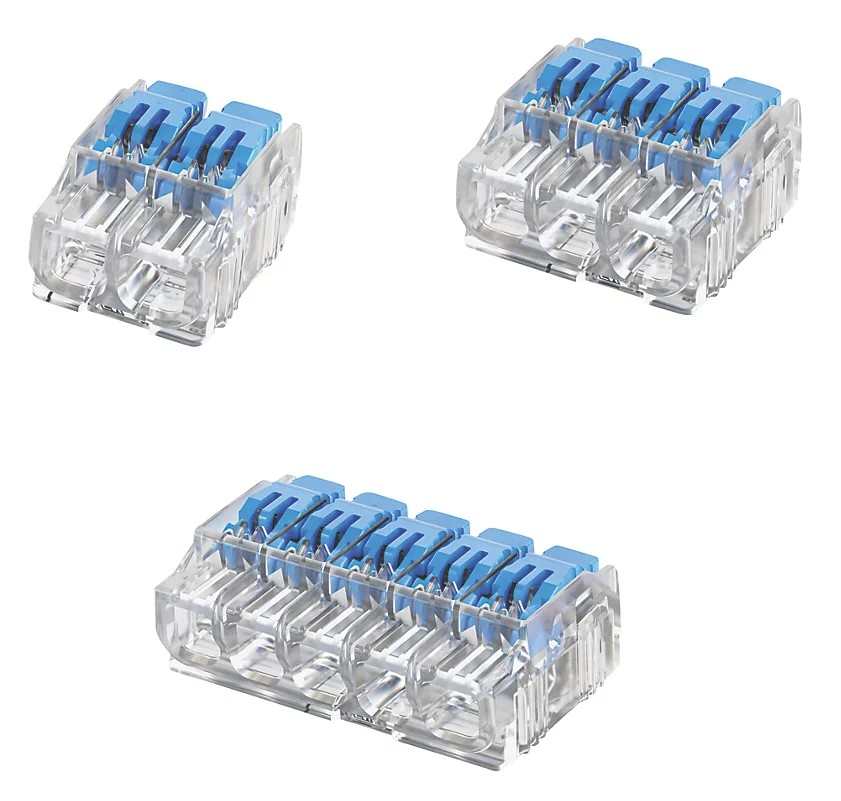

saveasteading Posted July 30 Author Posted July 30 Thanks Hubbers. That is now working. All I've done differently is cut some more old cable off and fed it straight (no bending) into an interim box, thence connecting the 2 boxes with a new and short length of T&E. Hoorah the gate works. I had 3 more occasions of the rcd tripping. "Obviously" with my new knowledge, when cutting the cable. Twice more I expect through touching earth to something even when I thought I had shrouded the wires. The problem appears to be as @ProDave suggested. Either from bending the old cable or at a fault in it. Perhaps this taped connection!!! It's amazing it lasted as long as it did but it was invisible under 10 coats of gloss. I've also decided that I don't like lever connectors. What a pain. The wire has to be dead straight, and stranded cable is a pain too.... I know: it needs an end crimp. 1
Onoff Posted July 30 Posted July 30 15 minutes ago, saveasteading said: I've also decided that I don't like lever connectors. What a pain. The wire has to be dead straight, and stranded cable is a pain too.... I know: it needs an end crimp. Just squeeze it straight with a pair of pliers. 2

Nickfromwales Posted July 30 Posted July 30 5 hours ago, saveasteading said: I've also decided that I don't like lever connectors. What a pain. The wire has to be dead straight, and stranded cable is a pain too.... I know: it needs an end crimp. You sir, have CLEARLY not made off enough choc blocks in your time to appreciate the 19th wonder of the world, the lever connector. I suggest you go and kneel on some pencils for such blasphemy, and repent. 2
Nickfromwales Posted July 30 Posted July 30 Oh, and you only use end crimps (aka bootlace ferules) with screw down connectors such as.....choc blocks. Stranded cable just gets a twist to straighten it up. 2
saveasteading Posted July 31 Author Posted July 31 1 hour ago, Nickfromwales said: CLEARLY not made off enough choc blocks in your time I used waco once then got a sparky to do the clever bit. He removed and changed them all. Then these as above this time. I think they are a bit small for the stranded armoured cable. I couldn't decide if I had to lift the lever or is that only for removal... holding that up was a nuisance. I will practice tomorrow and maybe get the hang of it.
Nickfromwales Posted July 31 Posted July 31 11 minutes ago, saveasteading said: I couldn't decide if I had to lift the lever or is that only for removal... holding that up was a nuisance. I will practice tomorrow and maybe get the hang of it. Ok. Hold the press, ffs. With a Wago, not his budget 2nd cousin, you lift the lever and it stays there. Then you insert the cable, viewing through the clear body to confirm that had arrived safely to the required insert depth, and THEN, you flick the lever over. Just so I can sleep tonight, what bit is the clever bit that the sparky did….? 1
Kelvin Posted July 31 Posted July 31 B&Q sell the cheap copies. I got some for free and didn’t like them so have stuck Wago. 2
Onoff Posted July 31 Posted July 31 5 hours ago, Nickfromwales said: Ok. Hold the press, ffs. With a Wago, not his budget 2nd cousin, you lift the lever and it stays there. Then you insert the cable, viewing through the clear body to confirm that had arrived safely to the required insert depth, and THEN, you flick the lever over. Just so I can sleep tonight, what bit is the clever bit that the sparky did….? Well...first you remove the wire insulation to the depth indicated on the back of WAGO... 😉 1
