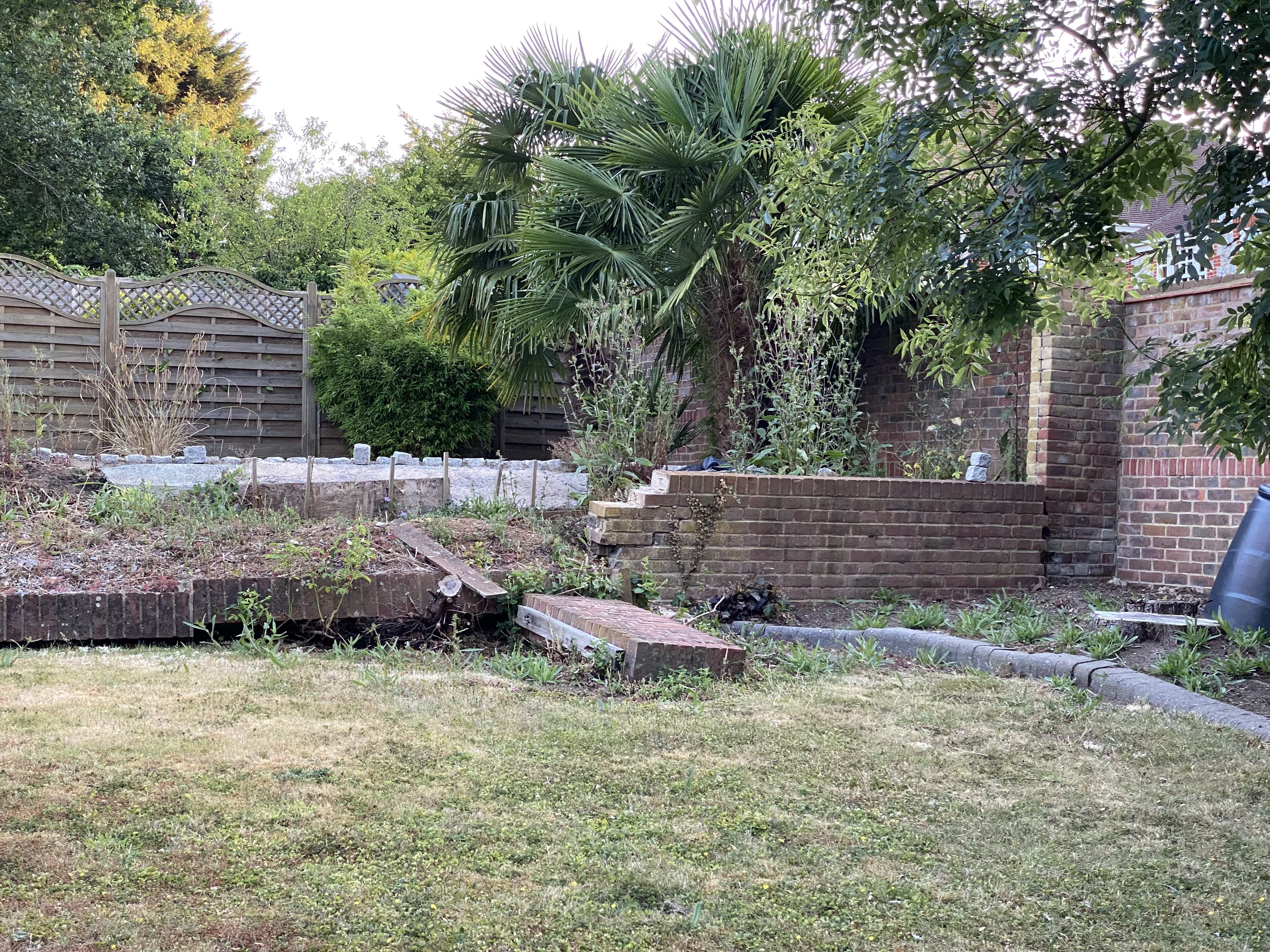

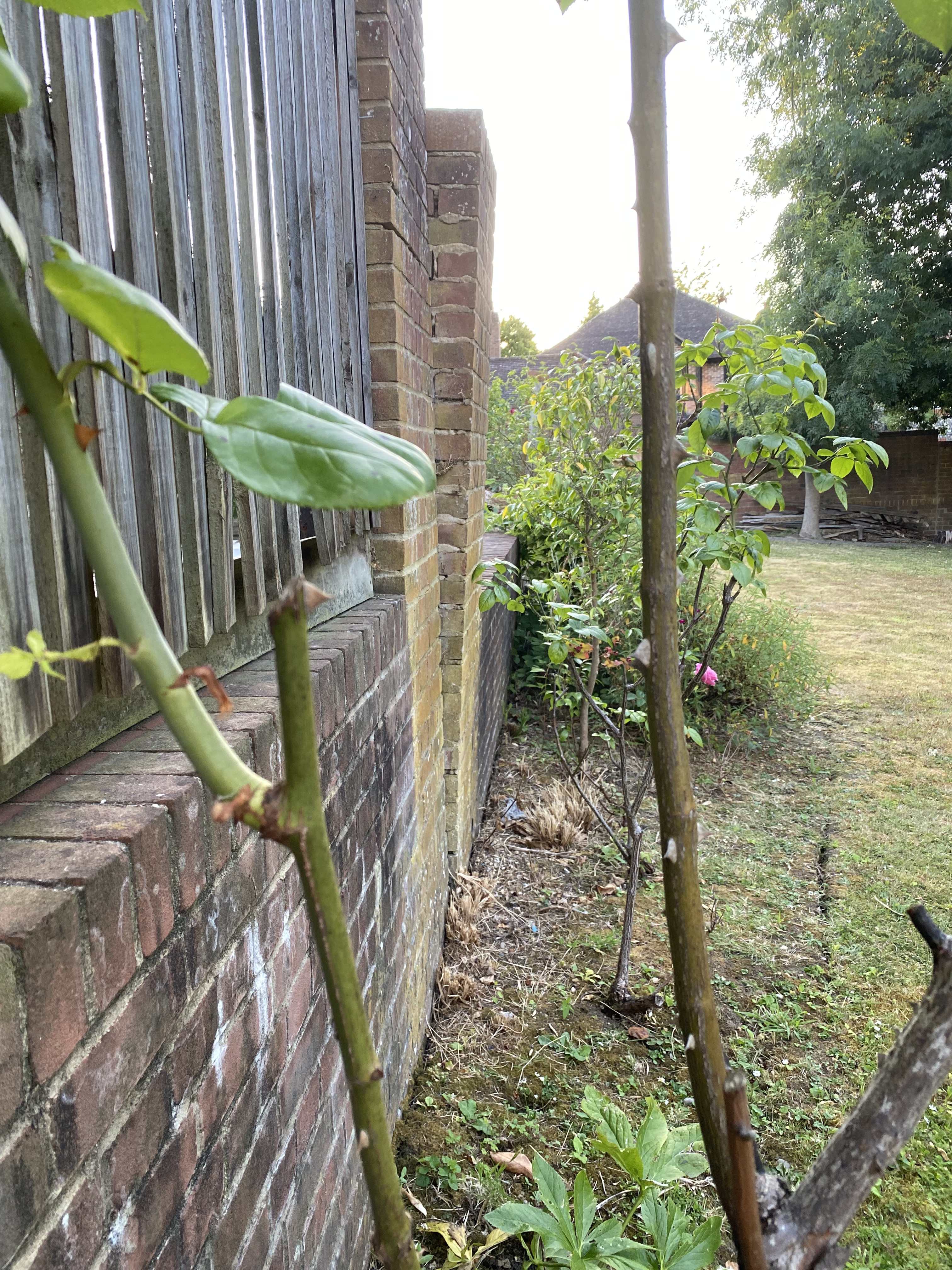

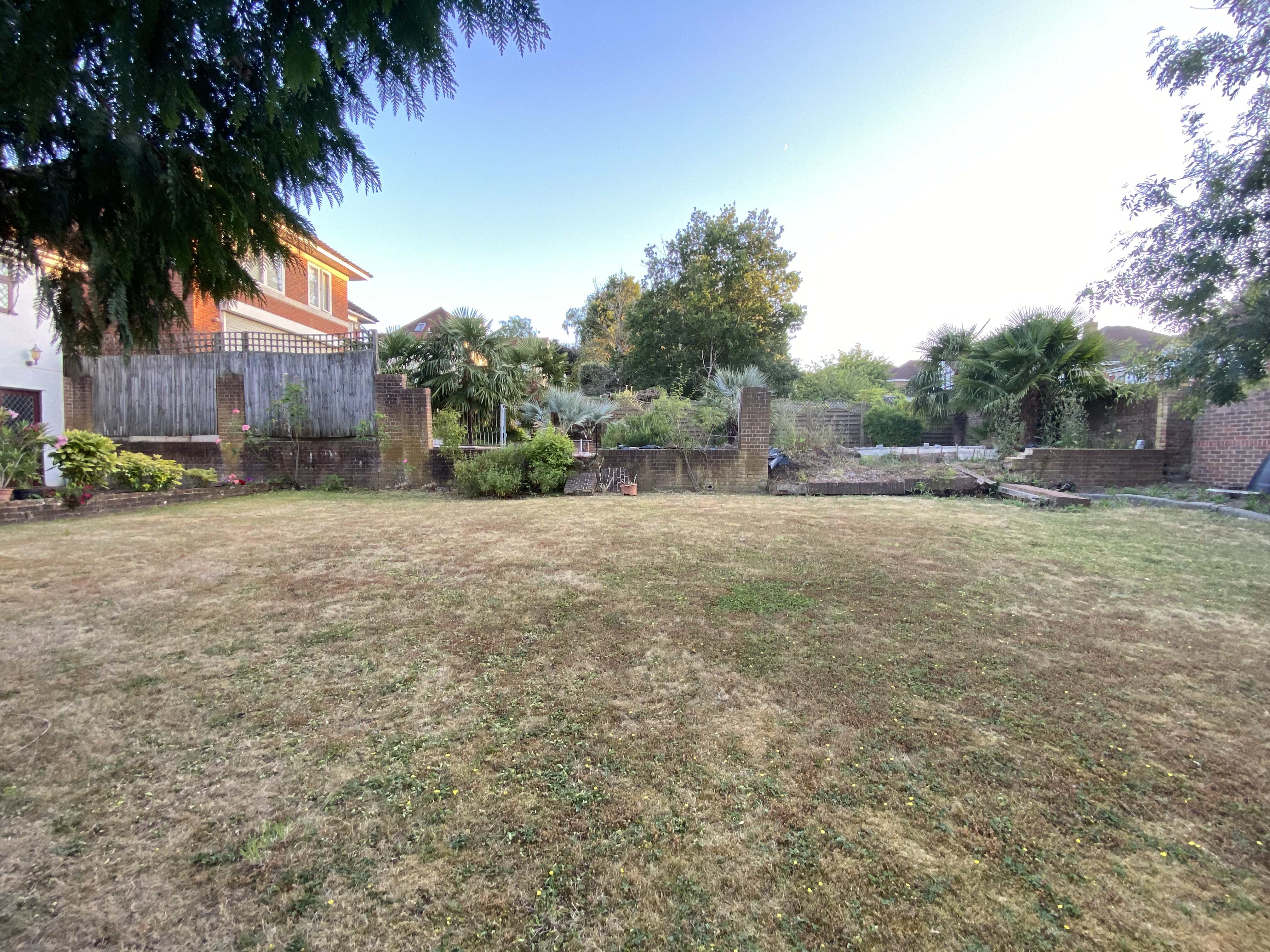

See pictures. The existing brick wall is on the border and is our wall on our land. We are excavating the existing wall. Then rebuilding as original. Then there will be a reinforced hollow concrete filled wall on the neighbours side up to his soil level as he needs to stop his garden from pushing our wall down again. His garden is 1 metre higher than ours. There will be a joint concrete foundation which will cross into the neighbours garden plus ours to build both walls on. Planning the foundation to be 800mm deep and about about 750mm wide.

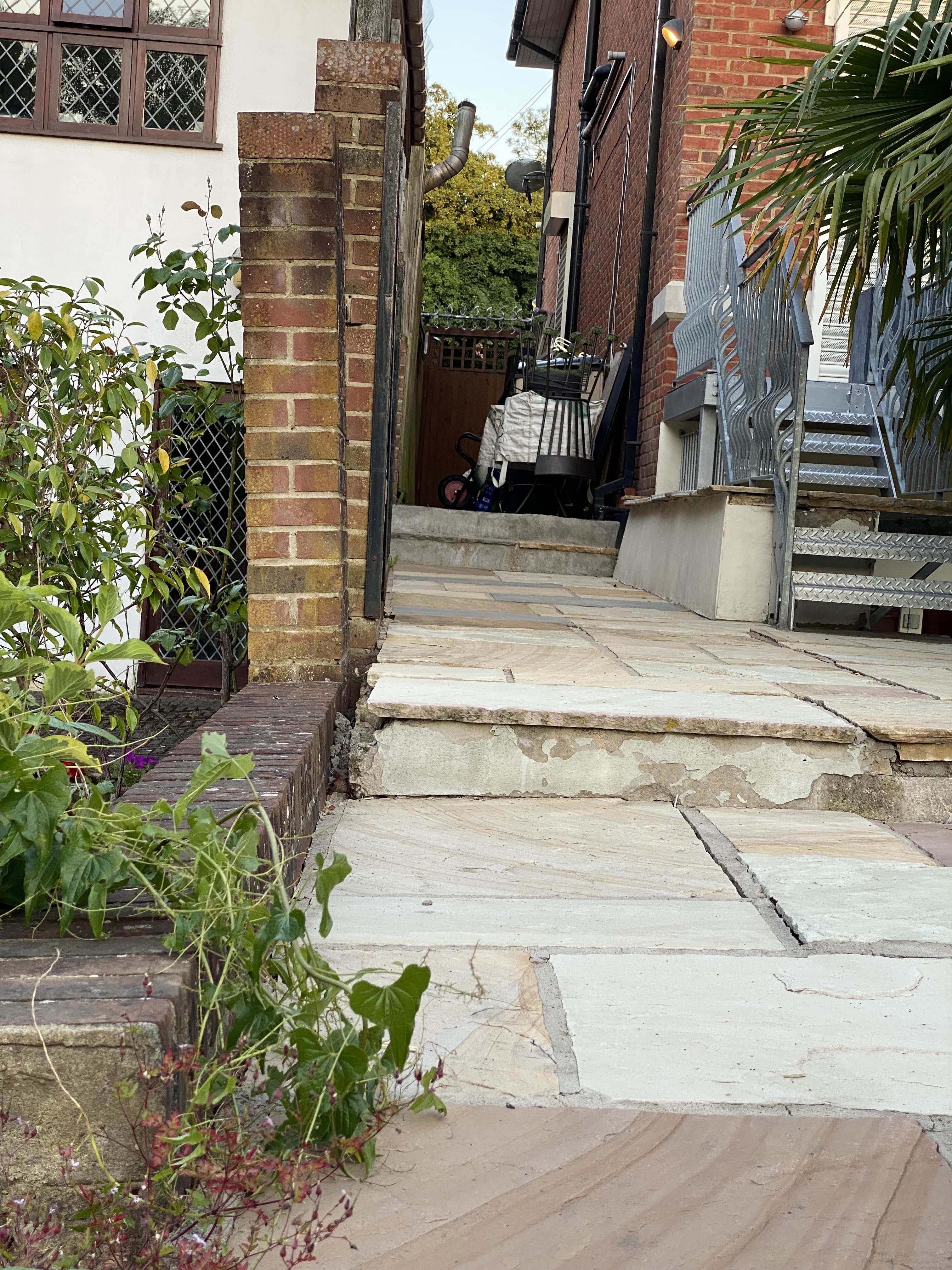

Here are some more pictures. The neighbours garden is sliding towards our wall. The soil is built up with old rubbish from when they knocked down the old house and dig a basement in the new house. They also rebuilt their patio right against our wall. There will is approximately 15metres by 1 metre high and then pillars which are 550mm x 1 metre.

Problem is this would not be reinforced as the neighbours reinforced hollow brick will be. Also a brick wall built this way would mean a) it’s our whole wall going into his border which I am not sure he would agree b) the brick wall can’t be reinforced ( and the horizontal pressure from the neighbours garden against our wall, especially when the soil is wet from heavy rain and water coming downhill generally as we live on a hill, is high. Our double brick wall has cracked from the middle to to horizontal pressure c) we might have problems accessing the neighbours garden in the future for repairs. d) the neighbours only want about 215 mm of the side of their garden dug to accommodate a hollow brick wall and drainage gravel behind it.
It needs to be designed by a SE, I think. If the walls are entirely separate, and not adding strength to each other, I have a feeling 225mm will not be enough. My 1200 - 1500 wall is 600+ thick at the bottom IIRC.

In any case it's a technically simple(ish) problem to solve. I'd remove the existing wall and footings, pour a reinforced concrete wall tied into a L or T shaped foundation. Then face it with whatever you want on your side.

I wonder when the neighbours paving was completed and if the sloping land was levelled at the time bringing the earth higher on the failed wall. Any builder would know that the wall without backing would fail....
