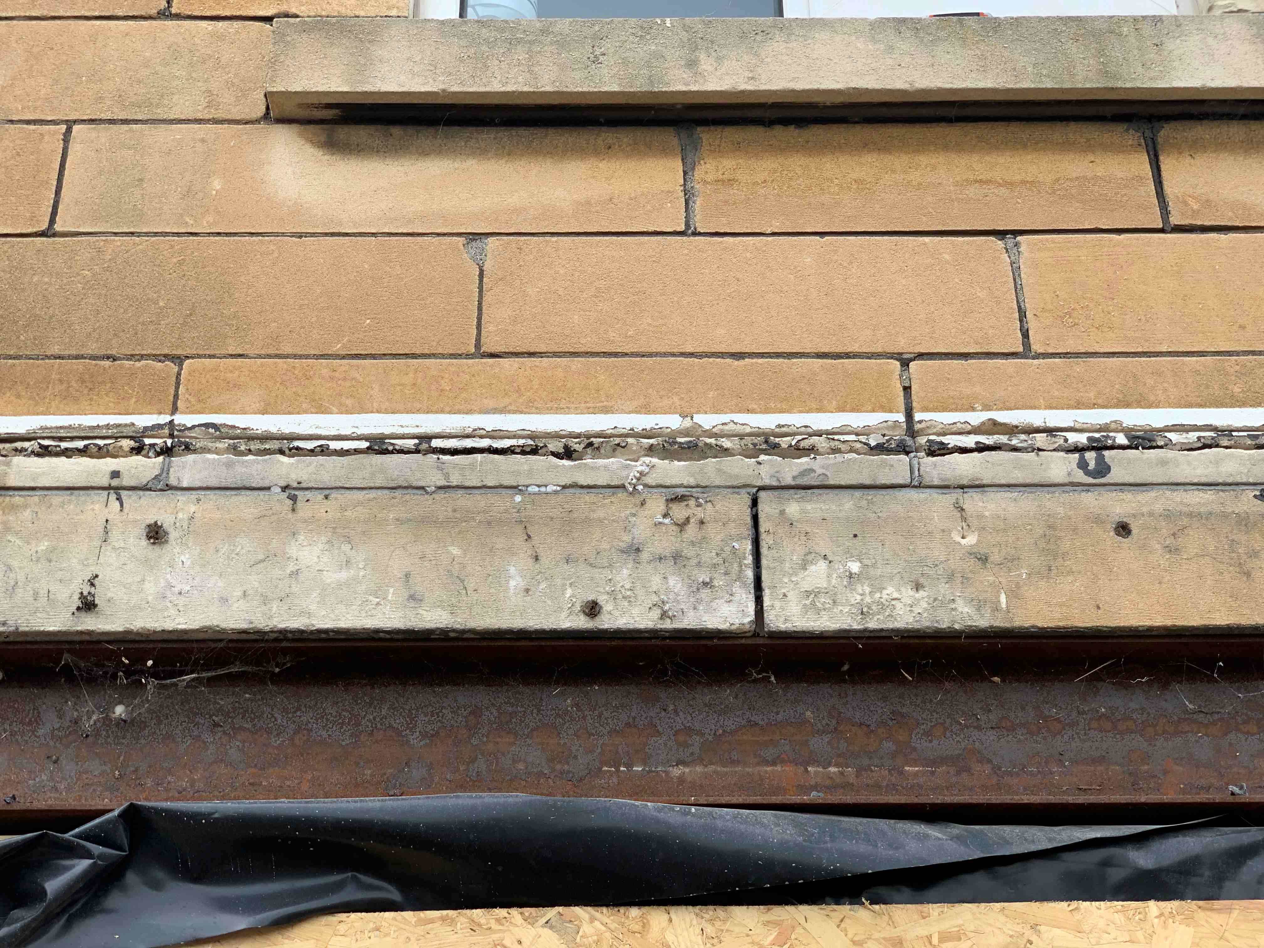

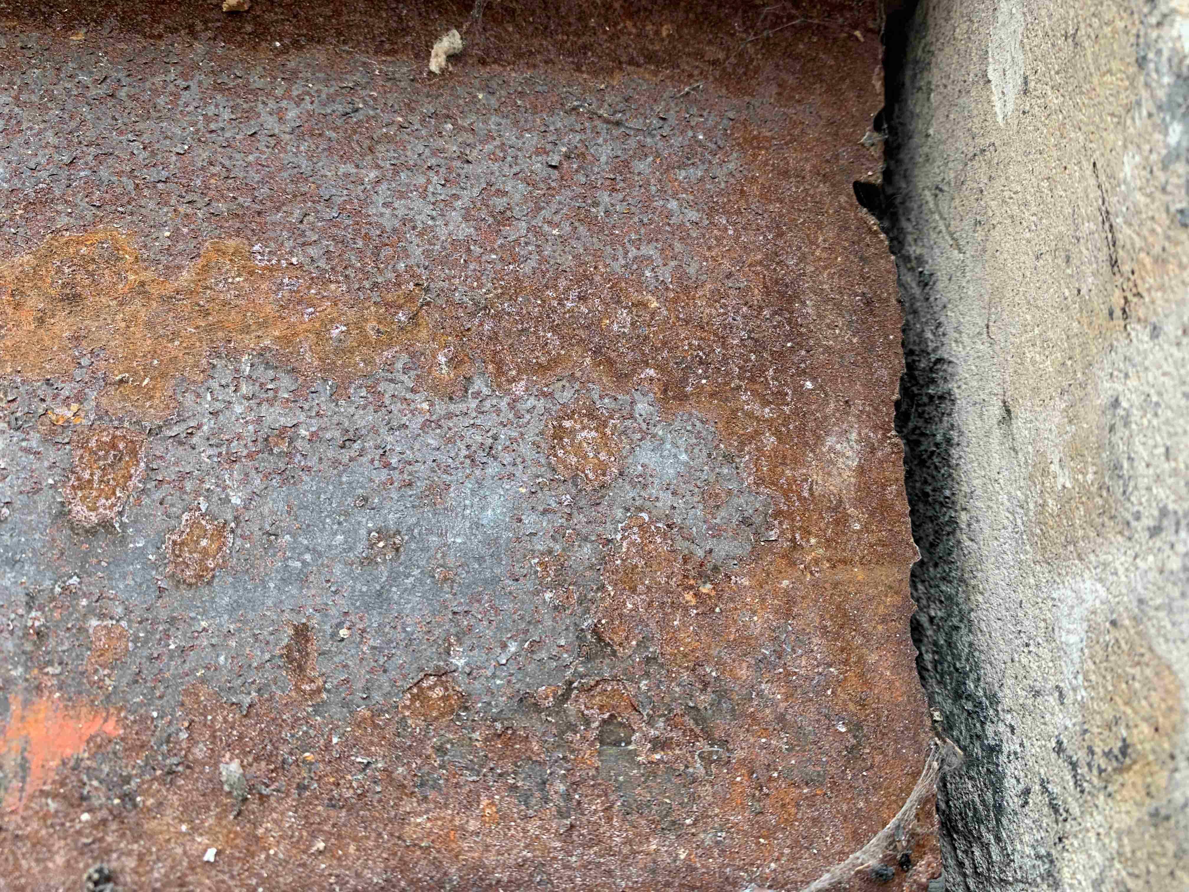

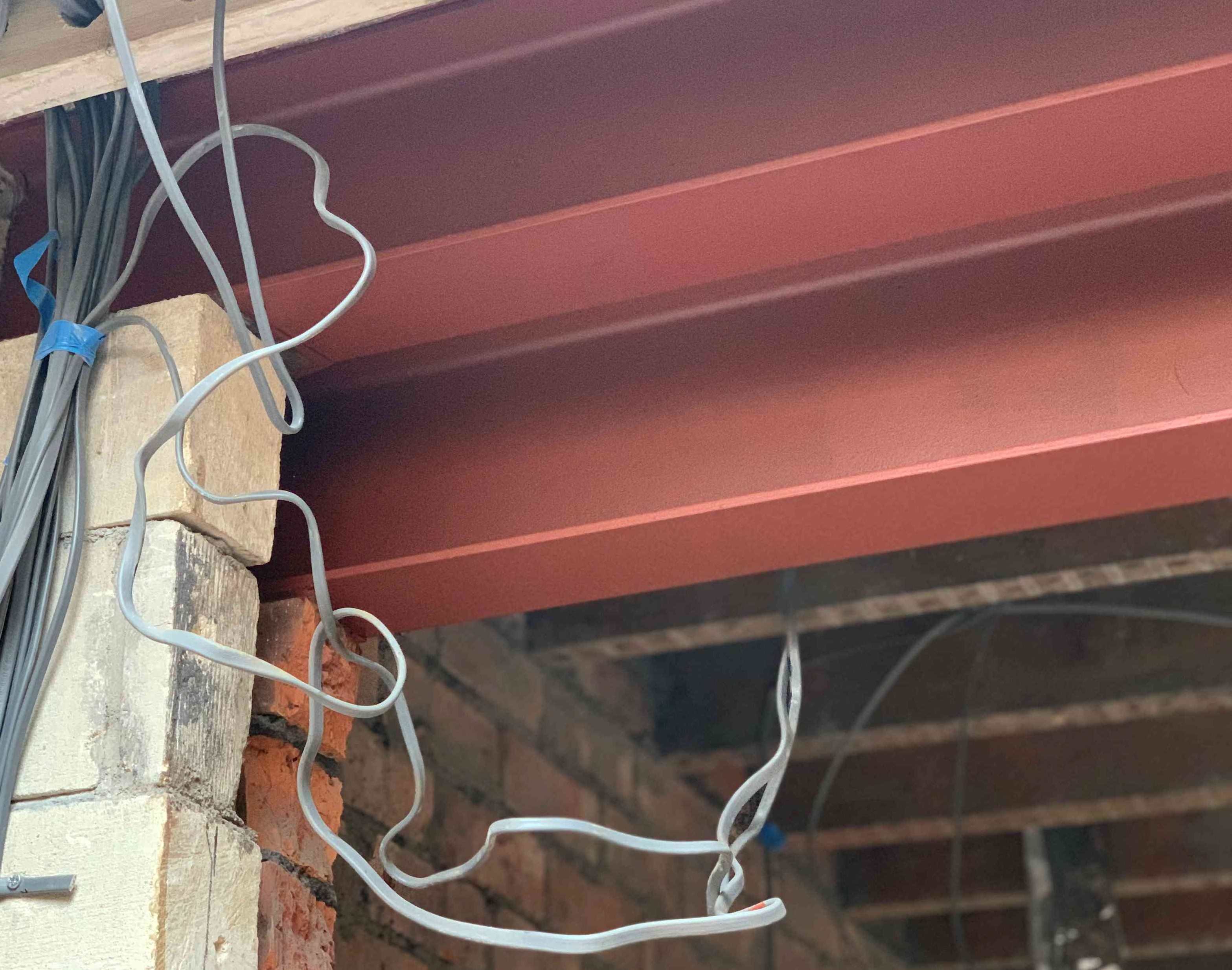

Spinny Posted July 21, 2025 Posted July 21, 2025 (edited) We had the same with steels that had been in place about 42 years (see pics). I had our structural engineer take a look, he gave them a good poke with a screw driver and said they should be fine for another 100 years, vigorous wire brush (as you propose) and treat. He suggested an intumescent coating paint, but when I got some delivered the skull and crossbones warnings all over the stuff made it seem you would die if you opened the can. So I went with vigourous wire brushing/drill attachment, then treatment with Neutrarust 661 (NATO approved rust convertor for use in ships, tanks etc - available on Amazon), then 2 coats of iron oxide paint. Photo shows the end result. Builder showed zero interest in doing anything to the steels so I had to do it myself. Edited July 21, 2025 by Spinny 2
