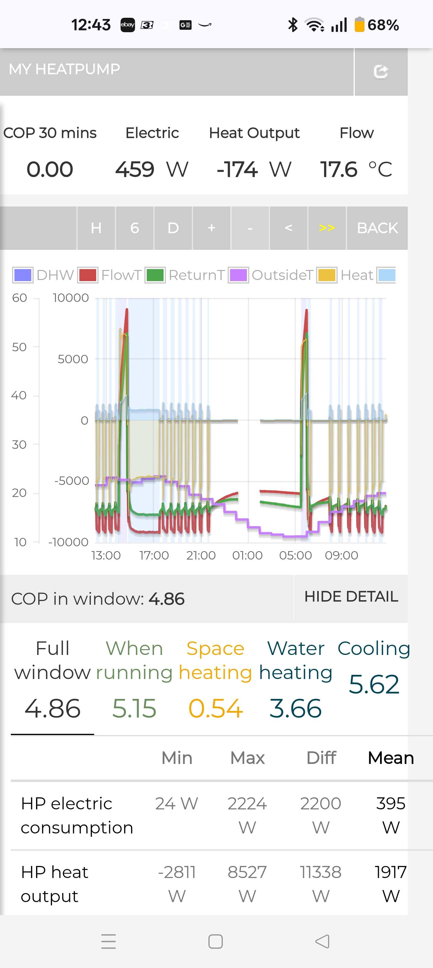

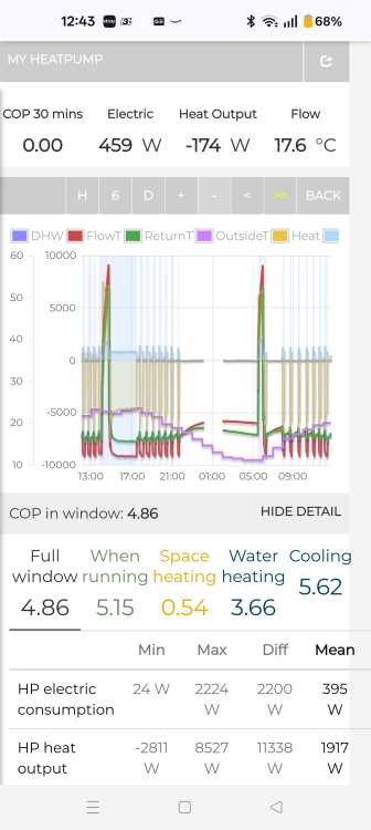

Your scheme over will yield at a best a CoP of below 3 and even less taking into account the additional electric boiler. On the other hand a simple single zone scheme a CoP of 4 and above including DHW.
This is ours running, the big peaks are DHW heating via a fixed schedule. The shaded areas are heat pumps actually running in cooling mode. Note after the first DHW how the heat pump runs longer, this is just due to heat pump having to run harder to manage heat loading. Ove time it has nothing to do so it switches it's self off. The numbers in different colours below graph are the average CoP in the window (24 hrs)
Screenshot_2025-07-19-12-43-45-18_40deb401b9ffe8e1df2f1cc5ba480b12.thumb.jpg.ea9690fbeeac400a3ff36a702708c28e.jpg
Similar is true in heating mode.

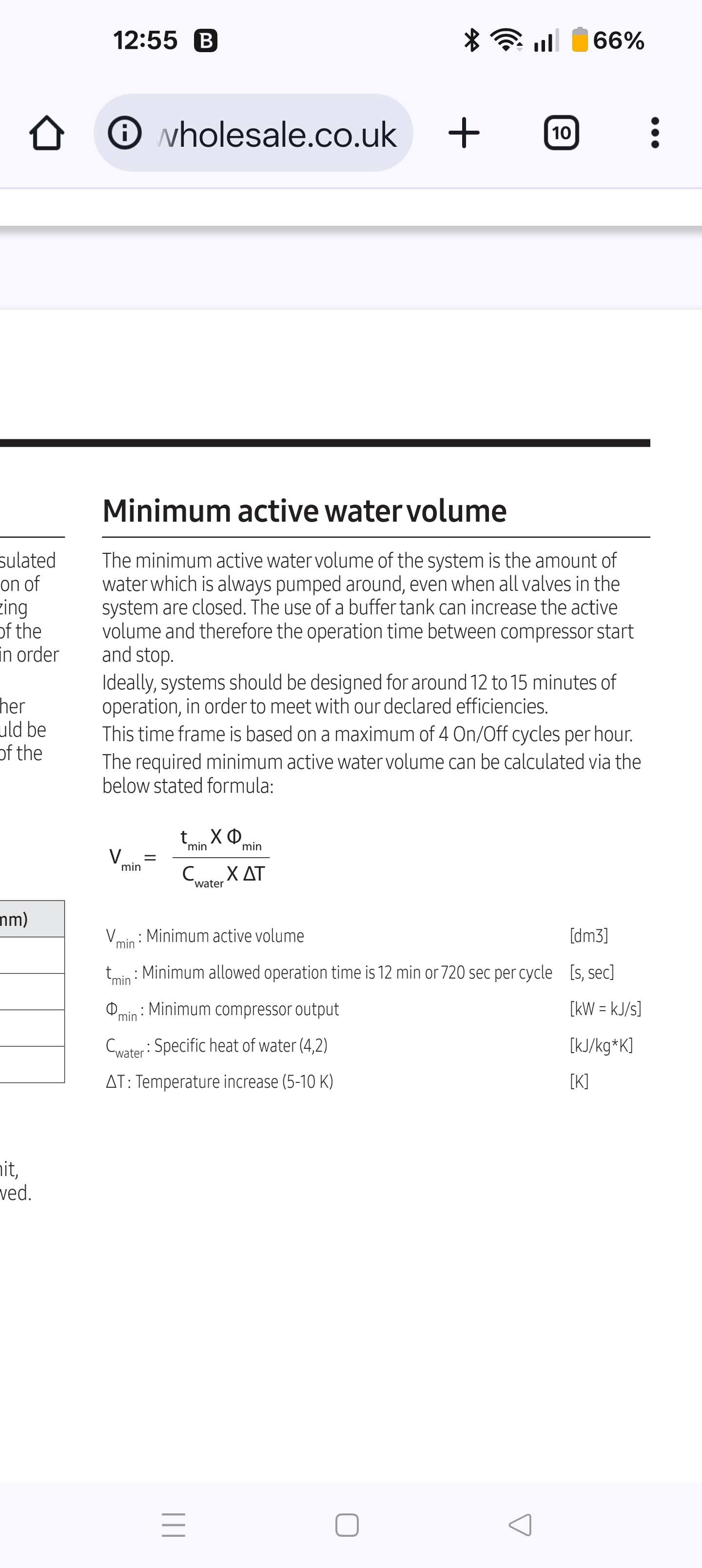

having a 50 ltr two port buffer
So will you have to an additional circulation pump? Is 50L enough to stop short cycling if zone 2 is only running?
My HP has integral pump but it will be several metres away from the house with about 15 metres of F&R pipework and I have been told I will need a second pump indoors to pump the water around the UFH. The pump on the HP isn't large enough to do everything.  The HP has a minimum water content of 30 ltrs so a 50 ltr buffer/volumiser is large enough to satisfy that requirement.  Whether it will be enough to stop short cycling I don't know, I haven't asked that question.  I don't intend to run it all the time when it is just the bathrooms where we want a warm floor, I intend to run it on a program so the floor is warm morning and evening when we are showering.  Running for a few hours each day I'm not expecting it to be an issue.
That number is defrost support only - not for cycling.
