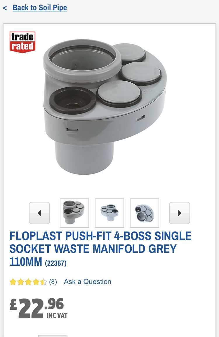

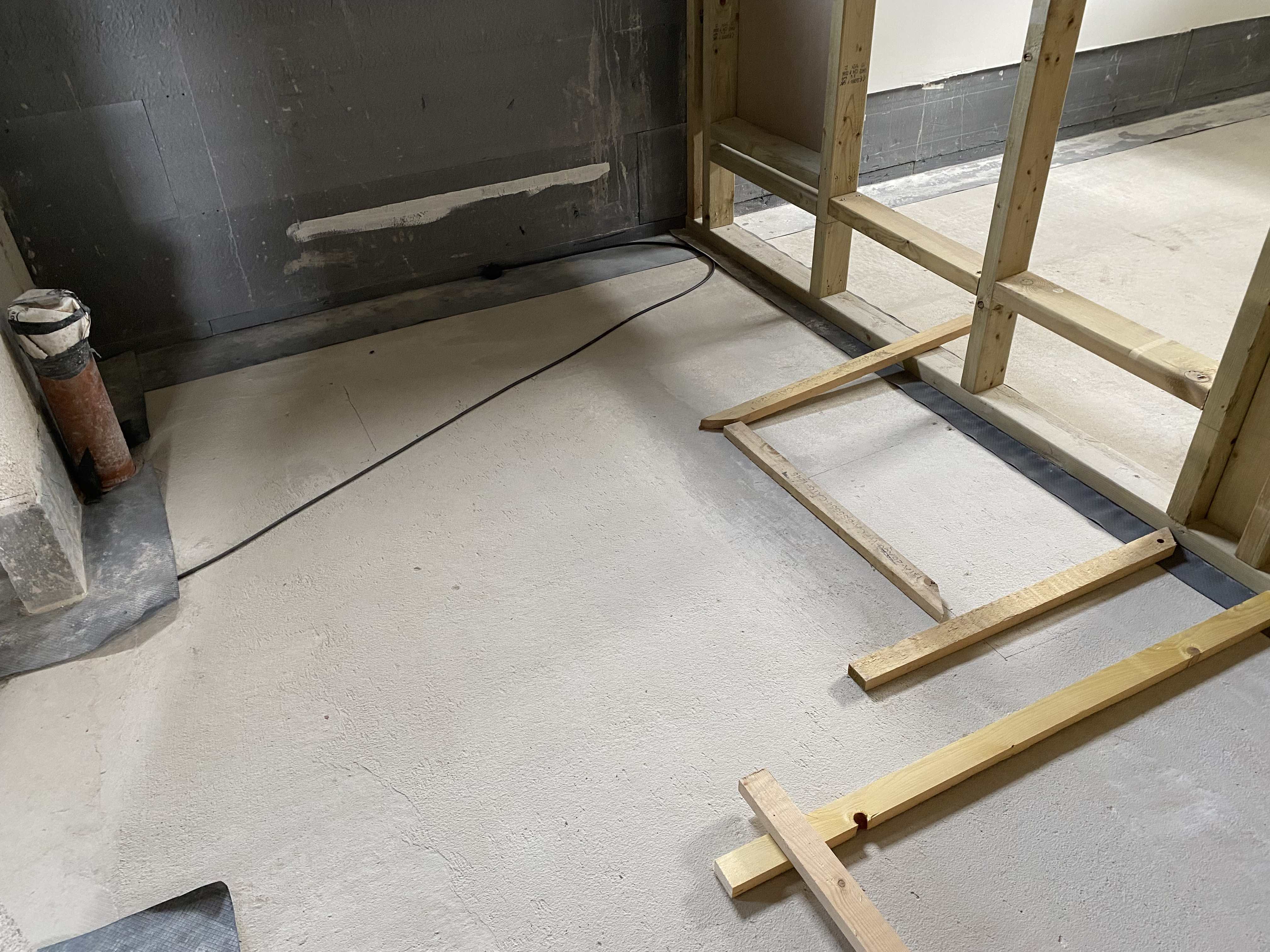

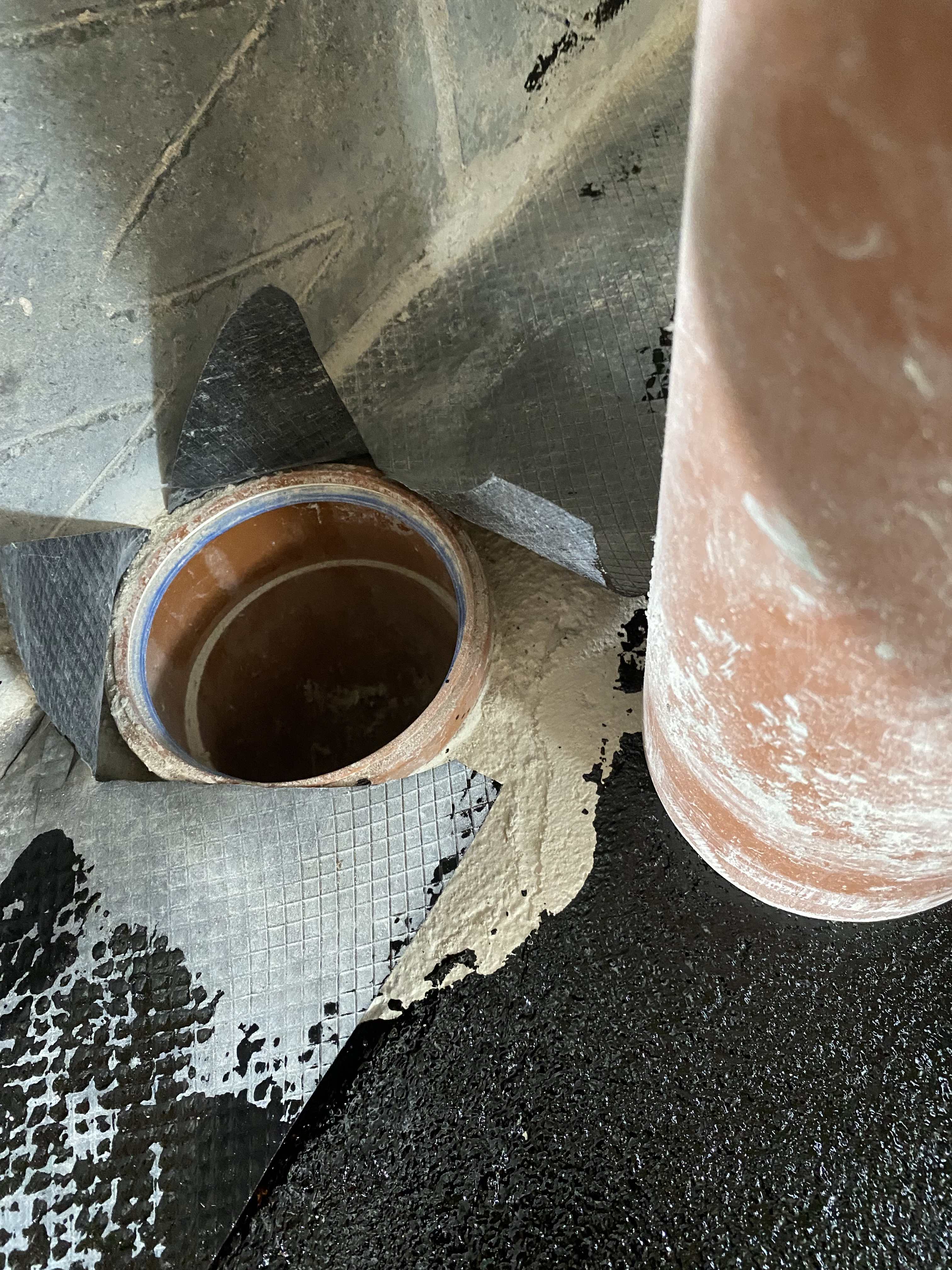

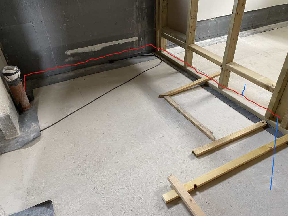

Susie Posted July 18, 2025 Posted July 18, 2025 I’m planning in advance of the floor insulation and screed how I’m going to connect my shower waste and sink waste into the soil pipe. The shower is marked out bottom right of image and will connect diagonally across room to the soil waste pipe. The wall hung basin marked out with its waste either going across room also or through stud wall into the plant room where a washing machine will be and it can join the waste from the washing machine following perimeter of walls back into bathroom and to soil waste pipe. My options are then 2 or 3 connections into the waste pipe. I found this whilst searching for waste couplers anybody any thoughts on this or alternatives.

Spinny Posted July 18, 2025 Posted July 18, 2025 30 minutes ago, Susie said: I’m planning in advance So presumably this is a ground floor with a concrete slab ? If that back black wall is an outside wall I'd have thought consider digging up a piece of slab next to it to run a drain out through that wall. Maybe do this in the plant room/laundry room and then run the basin and shower waste through the stud wall and across to reach a new drain next to the black wall. You could dig out a channel in the slab and/or raise the shower tray to cover the shower waste pipe. It is a hard thing, there is so much detail, but the more that is planned in advance of a build the better, especially M&E. 1
Susie Posted July 18, 2025 Author Posted July 18, 2025 I have 180mm insulation to go down and 55mm of screed minimum so I have worked out the 1:40 slope will get to the drain in the insulation layer but not sure about the coupler that I need.
BotusBuild Posted July 18, 2025 Posted July 18, 2025 Susie, What about inserting a swept T in the existing soil pipe and then extending the soil pipe through the 180mm insulation following the red line in the edited photo. Then run your basin and shower waste following the approximated blue lines? Your waste pipes from the plant room could also come through the stud wall into this soil pipe of course. Then you can go down to 32 or 40mm waste pipe for each "appliance"
BotusBuild Posted July 19, 2025 Posted July 19, 2025 (edited) That soil pipe suggestion i made is daft @Susie. Start with the swept T but just do a straight line to somwhere close to the basin and the shower with no other bends. Doh, what was I on last night? A show, a basin and a washing machine into that manifold should be far enough away from the toilet pan. Probability of all three being used at the same time i would think is small(ish) so I would use one Edited July 19, 2025 by BotusBuild 1

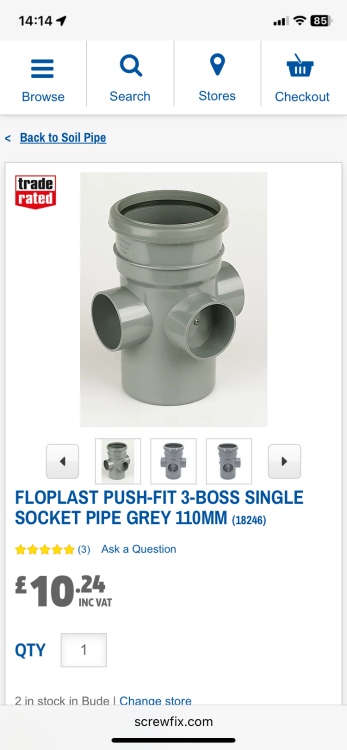

Nickfromwales Posted July 19, 2025 Posted July 19, 2025 (edited) @Susie You need one of these as low on the 110mm pipe as is possible. And then use the solvent inserts to 50mm pvc pipe, not the rubber bungs that are on the ‘elephants foot’ you posted an image of. Then take a pair of 50mm pipes, one to shower one to where sink waste is, reducing at each item; you’ll want a 50mm bend facing up out of the floor, and then when above ground you reduce to 40mm, then the 90° bend before the basin trap would be a 40mm bend with a 40/32 reducer in to outlet, then a short piece of 32mm between the bend and the sink trap. Depending on what shower trap you have, you can either go straight on to their supplied adaptor, or reduce to 40mm immediate before the trap. No need for air admittance or ‘Durgo’ valves etc as the inverted are all <1300mm. 👍. Edited July 19, 2025 by Nickfromwales Solvent, not spent....stupid fat thumbs and an iPhone that makes shit up as it goes along.... 2
Nickfromwales Posted July 19, 2025 Posted July 19, 2025 One of the boss outlets is open, the other 2 are ‘blind’ so you need to drill the second one out 1

Susie Posted July 19, 2025 Author Posted July 19, 2025 @Nickfromwales is that boss going at existing pipe? Perhaps should have said pipe is female coming out of slab with male just resting there for now. in which case is this what I get. I have the Impey linear 4 just arrived today and toilet and sink arriving Monday. Just so I can play around to get things dry fit, probably take me a month just to do the insulation in all rooms so plenty of time. Then box out all areas pipe will be and fit after the screed. thanks just noticed the <1300mm comment the shower waste to existing pipe is more like 2000mm.
BotusBuild Posted July 19, 2025 Posted July 19, 2025 Susie, Nick is right (as always) and I was on my way back to suggest same thing as that is what I ended up using as well. The push fit boss in your last post will do the same thing as what nick suggested. 1

Nickfromwales Posted July 19, 2025 Posted July 19, 2025 2 hours ago, Susie said: @Nickfromwales is that boss going at existing pipe? Perhaps should have said pipe is female coming out of slab with male just resting there for now. in which case is this what I get. I have the Impey linear 4 just arrived today and toilet and sink arriving Monday. Just so I can play around to get things dry fit, probably take me a month just to do the insulation in all rooms so plenty of time. Then box out all areas pipe will be and fit after the screed. thanks just noticed the <1300mm comment the shower waste to existing pipe is more like 2000mm. Yes, that fitting will do as long as stated the pan connector will go into it and be low enough to get onto the pan. Or, you just put that piece of pipe back in, cut it to leave 60mm of stub, and then glue on the one I posted. re 1300mm, see me last 1
Spinny Posted July 19, 2025 Posted July 19, 2025 Apols Susie, just couldn't see your makeup from the photo. Not seen studwork going down into the insulation layer before. 2
Nickfromwales Posted July 19, 2025 Posted July 19, 2025 3 hours ago, Spinny said: Apols Susie, just couldn't see your makeup from the photo. Not seen studwork going down into the insulation layer before. Defo not the norm, and usually on a kicker course of engineering bricks and Marmox breakers. I noted the low noggins, to catch the tail end of the plasterboards I assume(d), so thought they had this in check somehow.....we gotta pick our battles 1

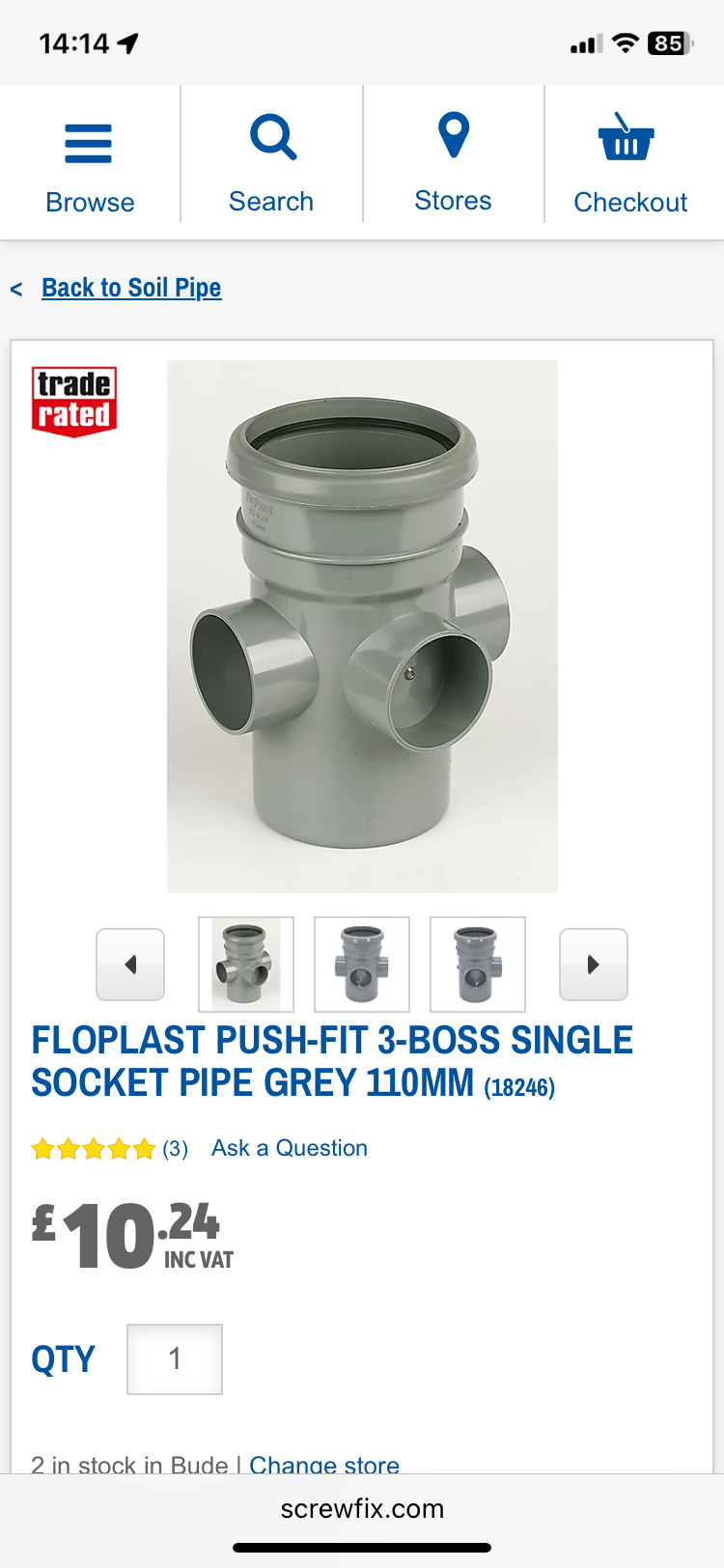

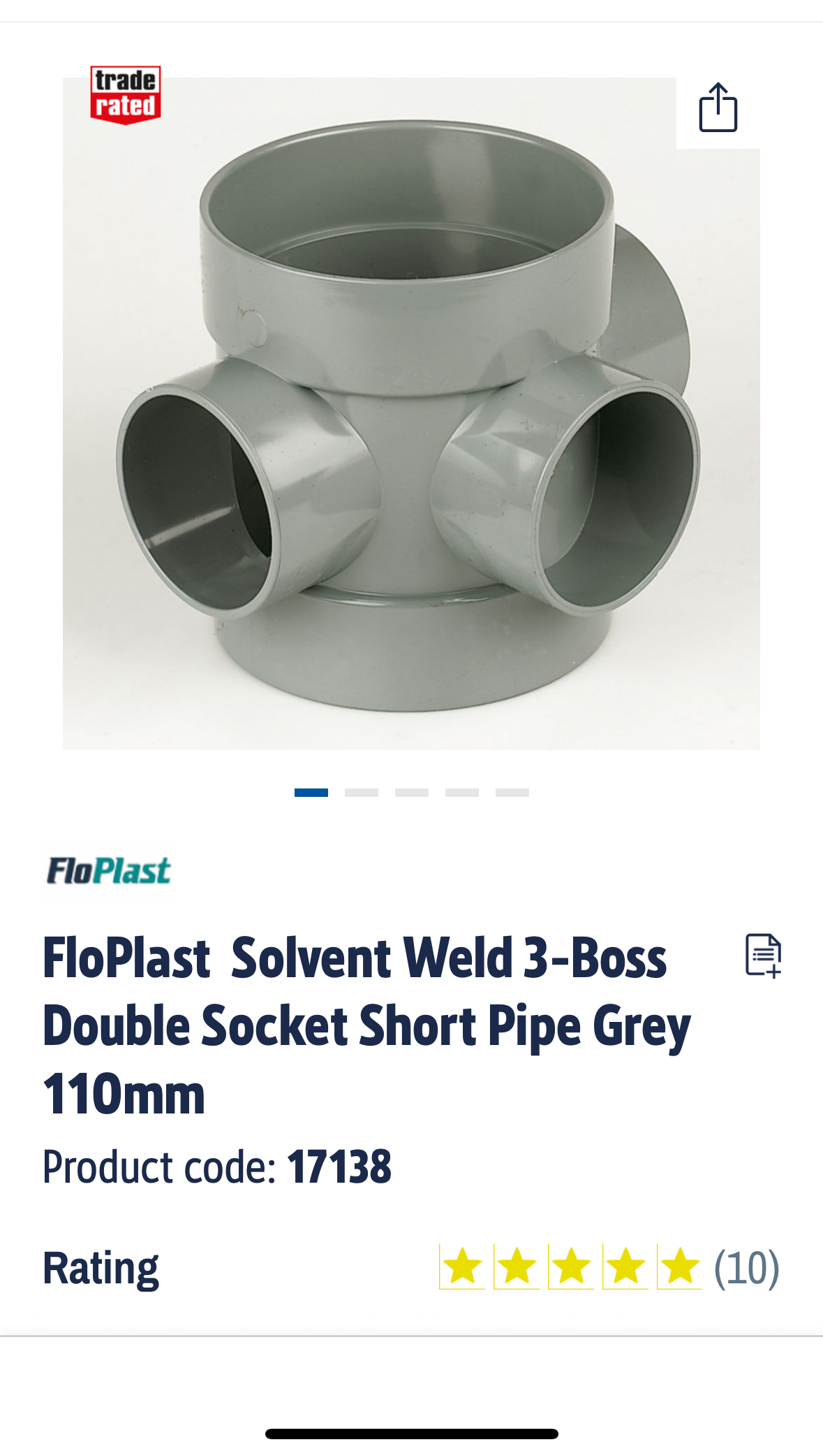

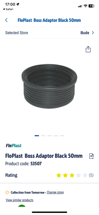

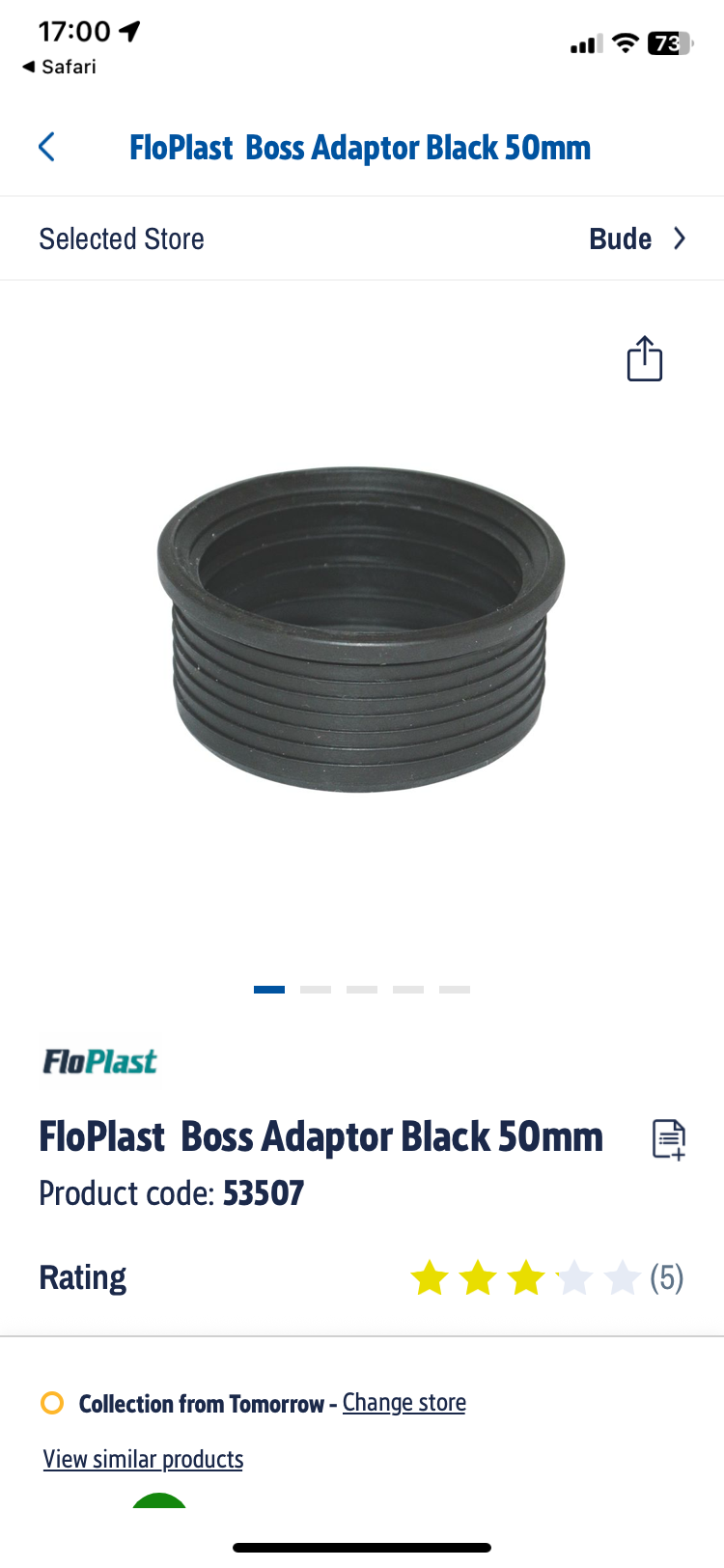

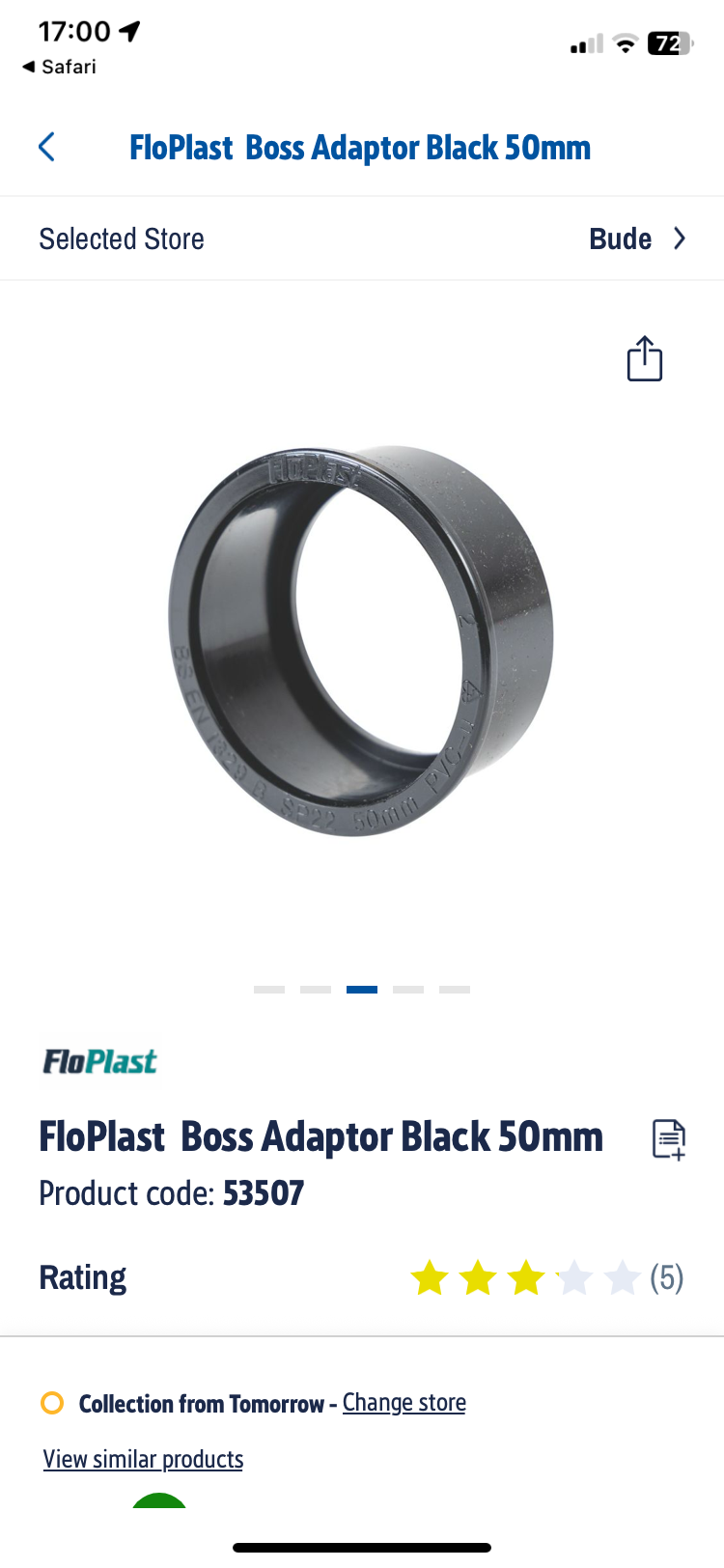

Susie Posted August 16, 2025 Author Posted August 16, 2025 Hi I’m back on this again and have a question about the boss adapters to use in the 3 way soil. There seems to be an image mismatch on the SF website I think floplast sp22 solvent weld is unavailable now and the alternative is a rubber bung but SF website and many others are showing both images incorrectly ie ABS version and rubber. is the rubber bung ok or would it be better to use a coupler instead and solvent weld. Still ok for me to play with the entry to 3 way soil not drilled out the blanks yet.
Nickfromwales Posted August 16, 2025 Posted August 16, 2025 Go to the store and ask them to fetch these to the desk. Then see what fits into what for the solvent weld options and make your purchase Prob one place where your fingers can’t do the walking, as this needs to be right.
Onoff Posted August 16, 2025 Posted August 16, 2025 On 19/07/2025 at 16:58, Nickfromwales said: Or, you just put that piece of pipe back in, cut it to leave 60mm of stub, and then glue on the one I posted. I didn't think the brown pipe solvent welded very well?
Nickfromwales Posted August 16, 2025 Posted August 16, 2025 18 minutes ago, Onoff said: I didn't think the brown pipe solvent welded very well? Yes, just needs to be scruffed up with some 40 grit.
Susie Posted August 17, 2025 Author Posted August 17, 2025 14 hours ago, Nickfromwales said: Go to the store and ask them to fetch these to the desk. Then see what fits into what for the solvent weld options and make your purchase Prob one place where your fingers can’t do the walking, as this needs to be right. Going to the store is much simpler for you than me, 20 miles round trip and they only have the rubber bung and can’t get the SP22 any more. I have sourced some white SP22, colour doesn’t matter once in ground who knows but obviously most people prefer black hence why only white is available.
