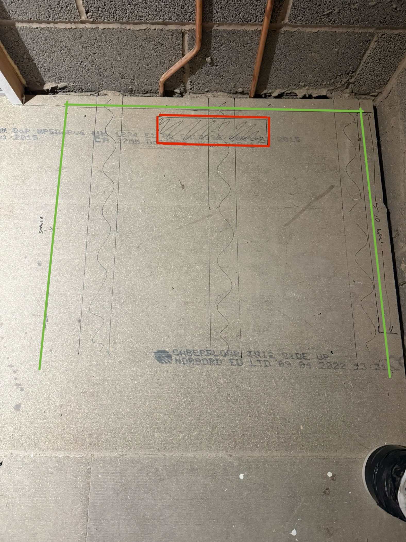

richo106 Posted July 16, 2025 Posted July 16, 2025 Hi All I am in need of some help if possible. Basically I am installing a new bathroom in my house and I am ready to order the materials for it and was just looking at the wastes etc.. But when i measured it out the waste for my shower falls perfectly on a joist. Please see attached photo, green lines being the shower and the red rectangle being the waste that is needed (if I go with that shower) The posi joists are PS9, 75x225mm @ 400 centres. My question is do I simply just have to a pick a different shower tray with waste that will fit between my joists? Or is there a way to 'engineer' this out so the top section of the posi joist can be removed to make way for my waste?(my preferred option as this with match all the other bathroom items) Any advice/information on this will be greatly appreciated, When looking on the internet its not looking hopeful i can touch my posi joists but would love to get a definitive answer Many Thanks
Gus Potter Posted July 16, 2025 Posted July 16, 2025 (edited) 1 hour ago, richo106 said: My question is do I simply just have to a pick a different shower tray with waste that will fit between my joists? Pick a different tray. If you muck with the joist then to get an SE will set you back say £ 600.00 quid.. they will add a bit for your stupidity. If you don't pay for an SE and get caught.. you are in bother.. or you floor may fall down! Get a tray with the hole positioned to avoid the joist. Spend your saving on something you see and get enjoyment out of, towel rail, tiles, higher quality sanitary ware. Edited July 16, 2025 by Gus Potter

dpmiller Posted July 17, 2025 Posted July 17, 2025 have you space to batten that side wall out an inch or two, and shift the tray over a bit? Does the selected tray's waste have multiple outlet points?
crispy_wafer Posted July 17, 2025 Posted July 17, 2025 Had the same issue - I ended up fitting a Kudos Connect2 tray to get me out of bother.
richo106 Posted July 17, 2025 Author Posted July 17, 2025 3 hours ago, crispy_wafer said: Had the same issue - I ended up fitting a Kudos Connect2 tray to get me out of bother. This is the exact one I have picked as a back up, are you pleased with it? As pleased as you can be with a shower tray anyway
