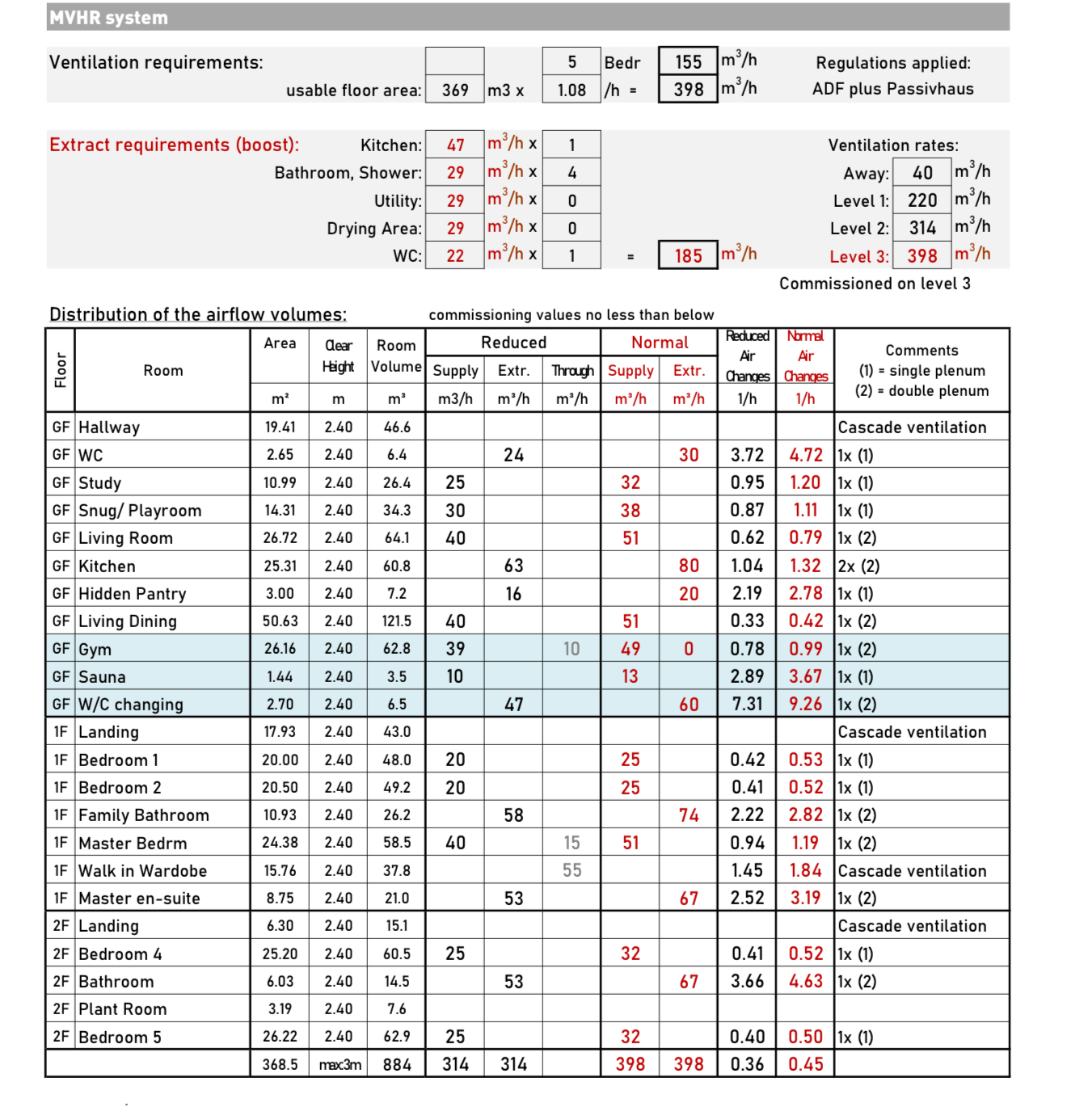

SBMS Posted Thursday at 19:03 Posted Thursday at 19:03 So we’ve got a fairly large sqm required for MVHR - circa 400sqm. A couple of other MVHR suppliers (including BCP) have suggested large units such as airflow and komfovent to shift up to 900m3. However Paul heat recovery has come back with the zehnder comfoair q600 with a much lower estimate required for airflow. Does the below look right? In particular it looks like they exclude the hallway and landing areas from their estimates (cascade ventilation)?

SBMS Posted Thursday at 21:20 Author Posted Thursday at 21:20 Same dilemma. And Paul heat recovery have over estimated mine as the top floor bedrooms are rooms in roof so not 2.4m high for the whole room…
SBMS Posted Thursday at 21:22 Author Posted Thursday at 21:22 The thing for me is the fact they’ve excluded the volume of the hall and landings as that is quite a bit of volume.

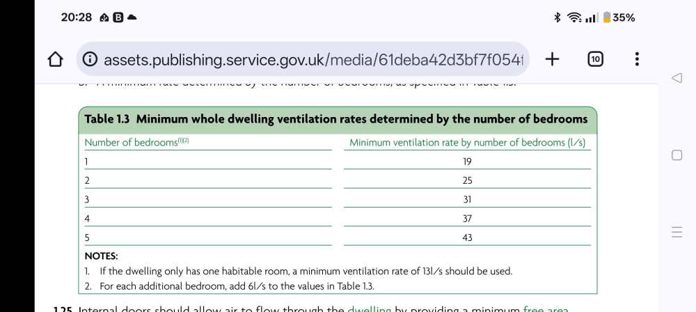

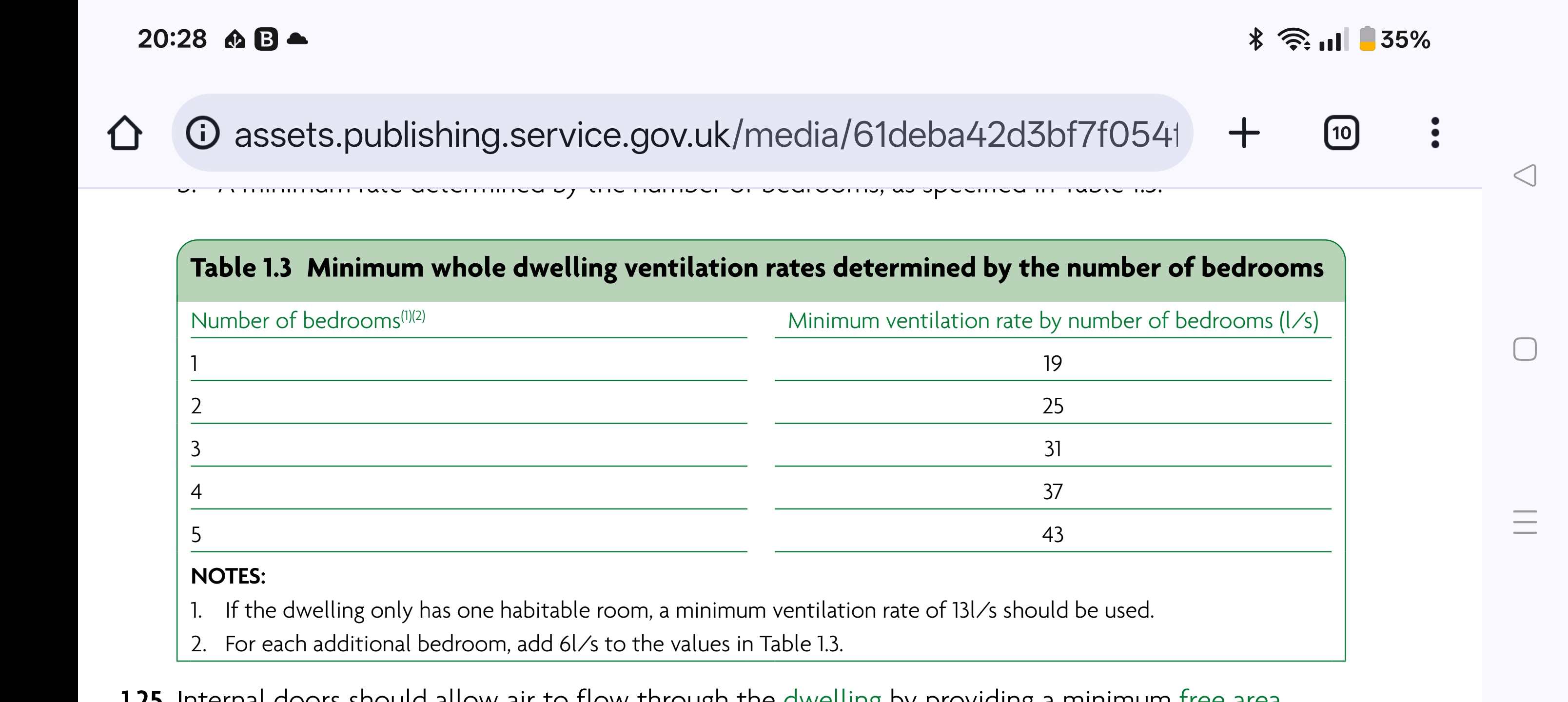

Nick Laslett Posted Thursday at 21:41 Posted Thursday at 21:41 (edited) 24 minutes ago, SBMS said: If ventilation is nothing to do with volume why do all the calculations and sizing reference volume and why do the units have sizing related to volume (genuine question as this repeatedly confuses me. If ventilation is to do with number of occupants generating co2 then shouldn’t mvhr units be based on number of people in the dwelling?) BR requirement for supply is based on no. bedrooms. That is what you see in the first line of the Paul quote. BR uses a different criteria for extract. There is possibly an “and/or” requirement in BR to satisfy the criteria. MVHR are not designed to satisfy UK building regs, but to give you a pleasant house environment (forgive gross oversimplification). But if you install the right MVHR unit it will comply with both Building Regs. The MVHR thread here does explain it, and the spreadsheet notes cover the calculations in detail. Just like the heat loss topic, you can do your own calculations. I will find the link. First post has the MVHR_sizing spreadsheet, and ventilation building regs document. This is what I posted in 2020 to help myself to understand the building regs requirements circa 2020. This was from the Vent Asia website at the time. Quote Take the total floor space x 0.3 l/s = Minimum Supply amount. Then add up the building regs minimum for the Extract rooms, e.g. Kitchen=13 l/s, Bathroom=8 l/s, WC=6 l/s, Utility=8 l/s. This is the Minimum Extract amount. The Extract amount must be at least equal to the Supply, but can be greater. Add the two together and this is the total l/s the MVHR must be able to supply to satisfy building regs. 0.3l/s equates to 1.08m3/hr per metre of floor space. As most manufacturers quote in M3/hr then it's probably easiest to use those units. Edited Thursday at 21:56 by Nick Laslett 1
JohnMo Posted Thursday at 21:49 Posted Thursday at 21:49 10 minutes ago, SBMS said: If ventilation is nothing to do with volume why do all the calculations and sizing reference volume and why do the units have sizing related to volume (genuine question as this repeatedly confuses me. If ventilation is to do with number of occupants generating co2 then shouldn’t mvhr units be based on number of people in the dwelling?) Because building regs tell you too. It's also based on number of people that could be living there. Passivhaus have a figure for single bedroom and a different one for double rooms. Wet rooms have have there own figures. BR sort of do the same.

JohnMo Posted yesterday at 07:01 Posted yesterday at 07:01 9 hours ago, SBMS said: Would You agree with Paul heat recovery’s assessment of the size of unit required or do you think the unit would run undersized? If the quoted unit is capable of 600m³ and it's being asked to sub 400m³ at boost I see zero issues. I would expect to drop to level 1 (220m³) once the house has dried out - unless there are 10 people living in the house. Also get a humidity sensor, in winter you don't want to drop below about 40% RH. 1
SBMS Posted 20 hours ago Author Posted 20 hours ago 11 hours ago, JohnMo said: being asked to sub 400m³ at boost I see zero issues. It’s coming out at around 650-720m3 according to the ChatGPT estimate… who knows which is right?!

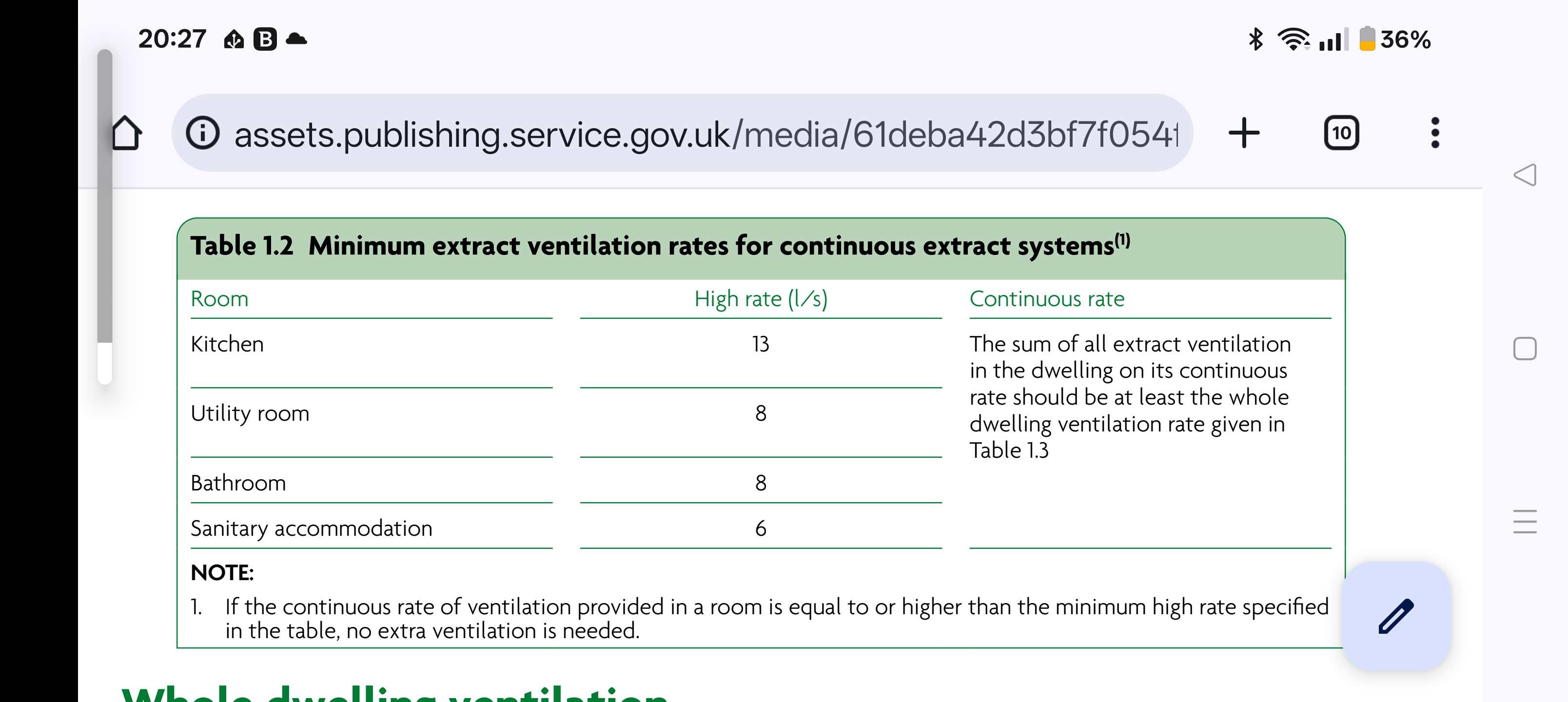

JohnMo Posted 18 hours ago Posted 18 hours ago 13 minutes ago, SBMS said: To be fair the AI calculated the BR value which I checked and it was correct (111l/s). The occupancy figure was around 120-130l/s. So fairly similar. as I said you need to read building regs, have assumed you are in England. Not sure where your figures align with what BR asks for? From building regs Mechanical ventilation with heat recovery Ventilation rates 1.67 For dwellings using mechanical ventilation with heat recovery, each habitable room should have mechanical supply ventilation. The total supply air flow should be distributed proportionately to the volume of each habitable room. 1.68 Mechanical supply terminals should be located and directed to avoid draughts. 1.69 The minimum total continuous rate of mechanical ventilation with heat recovery is the whole dwelling ventilation rate in Table 1.3 1.70 For dwellings using mechanical ventilation with heat recovery, each wet room should have a minimum continuous mechanical extract ventilation high rate as given in Table 1.2. Tables are
