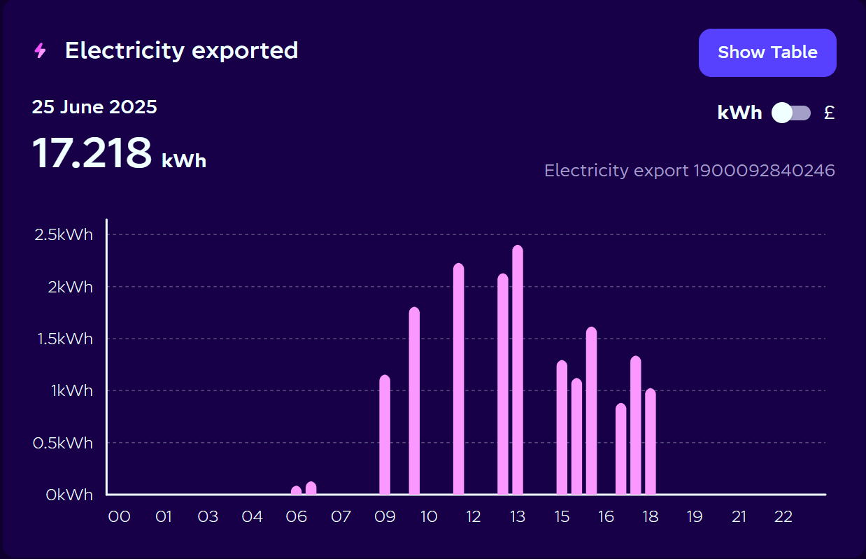

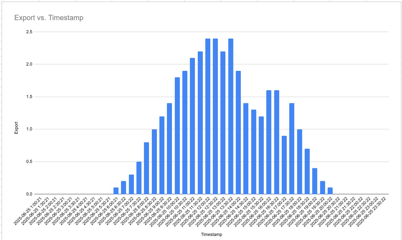

MikeSharp01 Posted June 28, 2025 Posted June 28, 2025 I was just running through our generation data this week and I noticed that the Octopus app was not showing me the same thing as the local inverter was for the 25th although the 26th and 24th are perfectly the same. Here are the two graphs for the 25th. I notice occasionally the Octopus takes time to show the readings, but I have never seen it only catch up part of a day. Anybody else seen this? I wonder how much back data our meter keeps locally? I will call Octopus on Monday to discuss or perhaps put this on the Octopus tech forum to see if anybody there has seen it if not seen here before. Here is what Octopus is showing for 25th. Here is what the inverter is telling me rounded to 2dp not three as Octopus.

MikeSharp01 Posted June 28, 2025 Author Posted June 28, 2025 1 hour ago, Temp said: I take it the inverter knows how much is exported not just whats generated. That graph is what the inverter thinks has been exported and it aligns perfectly with the Octopus graph but has no missing 30 minutes segments like the Octopus one has. 1

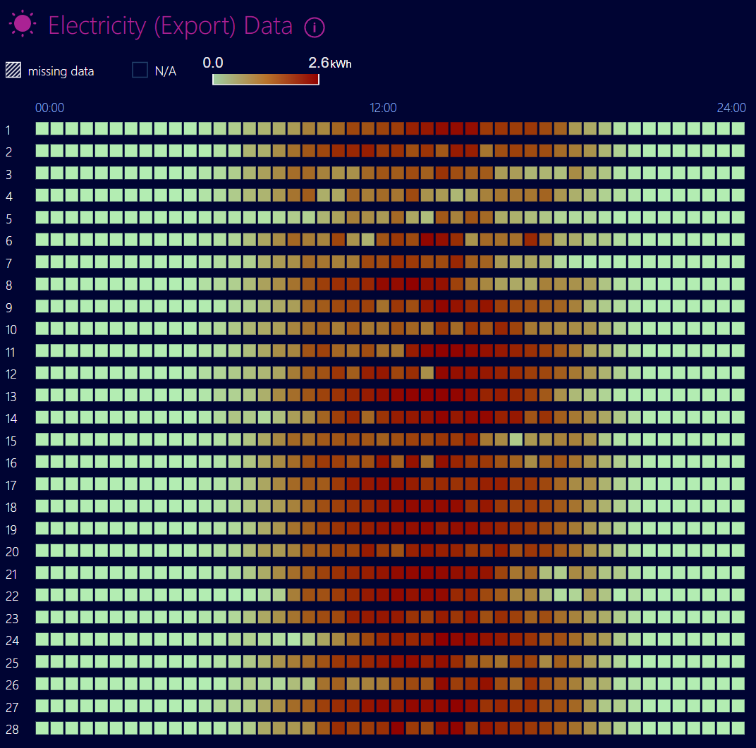

Rob99 Posted June 29, 2025 Posted June 29, 2025 On 28/06/2025 at 16:36, MikeSharp01 said: That graph is what the inverter thinks has been exported and it aligns perfectly with the Octopus graph but has no missing 30 minutes segments like the Octopus one has. You can sign up to Octoprice ( https://www.octopriceuk.app/missingData) using your Octopus API key and it will tell you whether there is any missed half hour data from your smart meters. It also has other useful stuff on tariffs.

MikeSharp01 Posted June 29, 2025 Author Posted June 29, 2025 3 hours ago, Rob99 said: You can sign up to Octoprice ( https://www.octopriceuk.app/missingData) using your Octopus API key and it will tell you whether there is any missed half hour data from your smart meters. It also has other useful stuff on tariffs. Did that and here is what I see: A bit patchy but no missing data and not unlike previous / subsequent days. No '0' (Zero) blocks in the main part of the day. So it must be a software glitch somewhere although it consistently shows the same missing blocks every time in the App and on the Website. Looks like this is is one for a call in the morning.

MikeSharp01 Posted June 30, 2025 Author Posted June 30, 2025 43 minutes ago, SteamyTea said: 11 hours ago, Temp said: welcome to Octohell How the mighty fall from grace. To be fair to Octopus they have not yet had the chance to respond to my query, I think I have all the evidence there is a problem, their own backend data shows that there is no missing data on the day and, judging by the colours in the 30 minutes slots, we were exporting more that nothing across the whole of daylight. I think this means there is a glitch in the software that is copying the data across. One can speculate on why that might have happened and it is likely that the scrape over from one to the other can be rerun, lets wait and see.

MikeSharp01 Posted July 15, 2025 Author Posted July 15, 2025 1 hour ago, sharpener said: did you get it sorted, and if so how? Is it going to be a permanent fix or something you have to watch out for for the rest of your days (sigh)? Yes we did and two things came out if it. Firstly the data was in the Octopus back end all the time as I could see it via the detail tool, it just was not copied across to the main viewing system. Secondly the way billing works on the simple Octopus export, not agile, is that they use the last meter reading of the month and so errors from intermediary readings don't matter a jot BUT if that one reading is wrong then the bill will be wrong! So I have added a line to my logger to record the total exported by the inverter at 10 seconds to midnight on billing day, and every other day actually, so I can check the bill readings.
