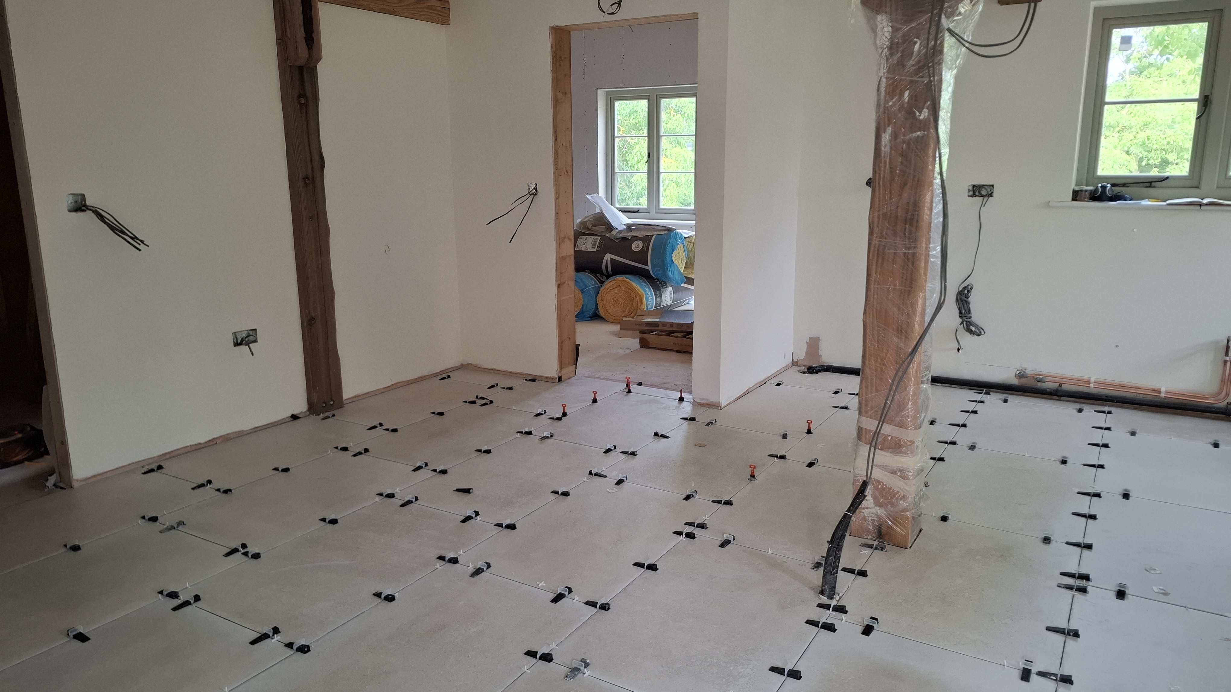

Post and beam Posted July 16, 2025 Author Posted July 16, 2025 Update. I got my Tiler to bring a pair of his moisture test box's. The procedure for these is exactly the same as mine. Fix to the floor for 24 hours and then 'sniff' the RHI%. No fault with the technique then. Both of these professional level probe style test box's read within 2% of each other but significantly they were at least 20 points lower than mine at 53%!! My tester is unduly pessimistic compared to the others. 1
