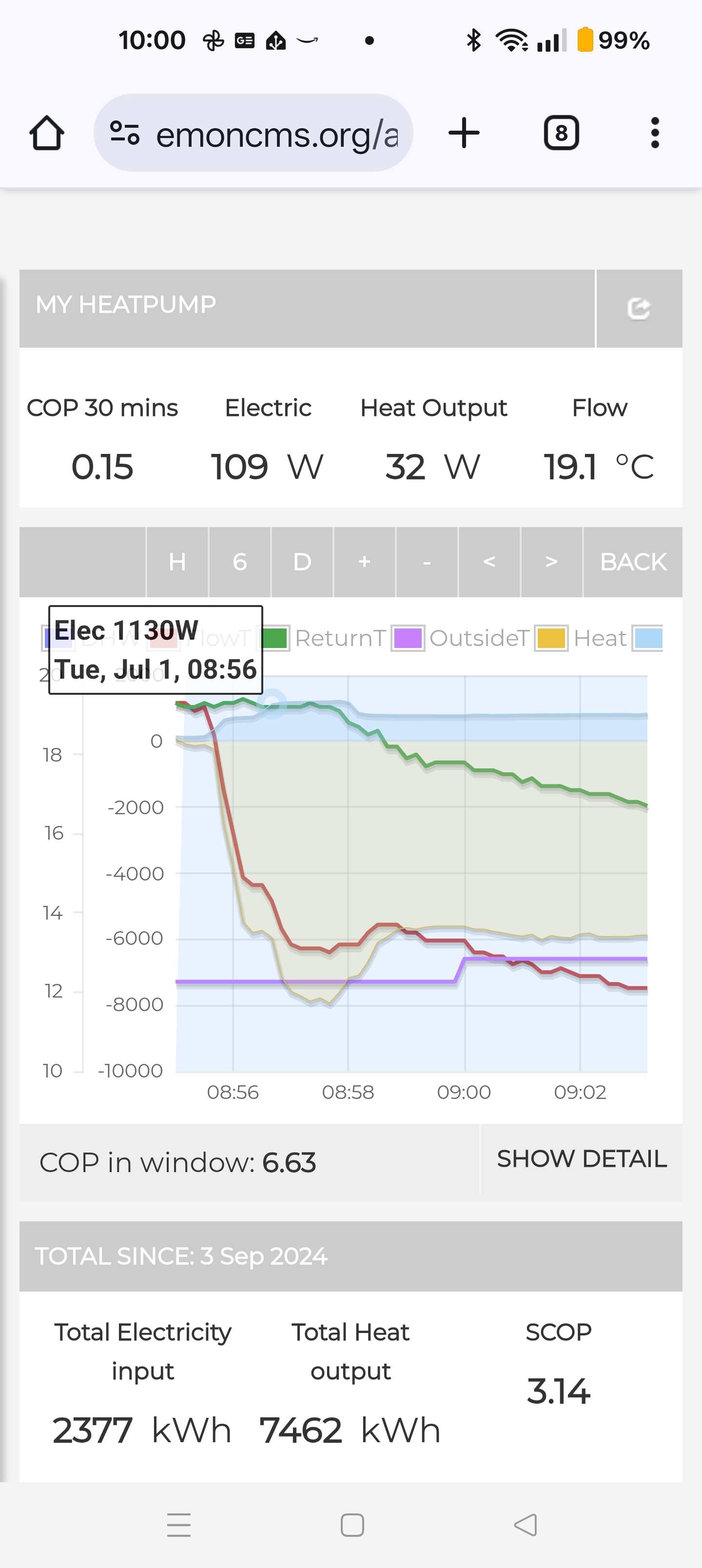

Nickfromwales Posted 7 hours ago Posted 7 hours ago On 28/06/2025 at 15:10, Alan Ambrose said: This is a bit of UKPN make-work. They focus on the HP and car charger as they’re the big loads. My contact actually asked for the make and model of the units. Just say ‘1 dwelling’ and make up appropriate numbers based on the max power / current for the units. Power is 230V x current in amps for this purpose. kVA and kW are ‘the same’ for this calc. No, of course they’re not, but power factors etc are way too much detail for this back-of-the-envelope nonsense. In practice 97% of the time, they’re going to give you either a single phase 100A supply or a 63A 3-phase. So, 23kW or 46kW. So, make the result come out at about 60% of one of those - so the thing makes sort-of sense to UKPN. The other 3% is for local areas that are close to their max supply limits. Ask them how much they can supply, and then magically come up with a number that is 80% of that. I'm sure it would be easier to say you're on gas, and omit the HP from the form. Let them install, and then fit it later with a retro-application. The issue here is that they just don't realise that a high performance dwelling that is ultra low energy use has a load for the HP lesser than clicking the kettle and the toaster on at the same time. Modern inverter HP's ramp up softly, so there's very little to worry about there, just the DNO assume huge motor loads and start up currents (from shunt resistance) and it's just not the case nowadays. They should just ask if it is definitely an inverter HP (soft start) and assume the load is negligible. As said, it's one supply or the other, but if you see what a 60a supply can actually run without popping the HRC fuse you wouldn't believe your eyes. Just think of how many folk get a HP installed to existing stock and the supply isn't upgraded. They'd be better off asking about the induction hob as that's way higher consumption, some are crazy big.
JohnMo Posted 7 hours ago Posted 7 hours ago 1 hour ago, Nickfromwales said: load for the HP lesser than clicking the kettle and the toaster on at the same time. Modern inverter HP's ramp up softly This is the energy chart for a 6kW heat pump, it's doing cooling but same power is used for heating. Over a 3 minute period it hits 1130W electric draw, then ramps down. Electric is the blue line at the top. So no big energy spikes at all. Our battery doesn't show any spikes either. 1
