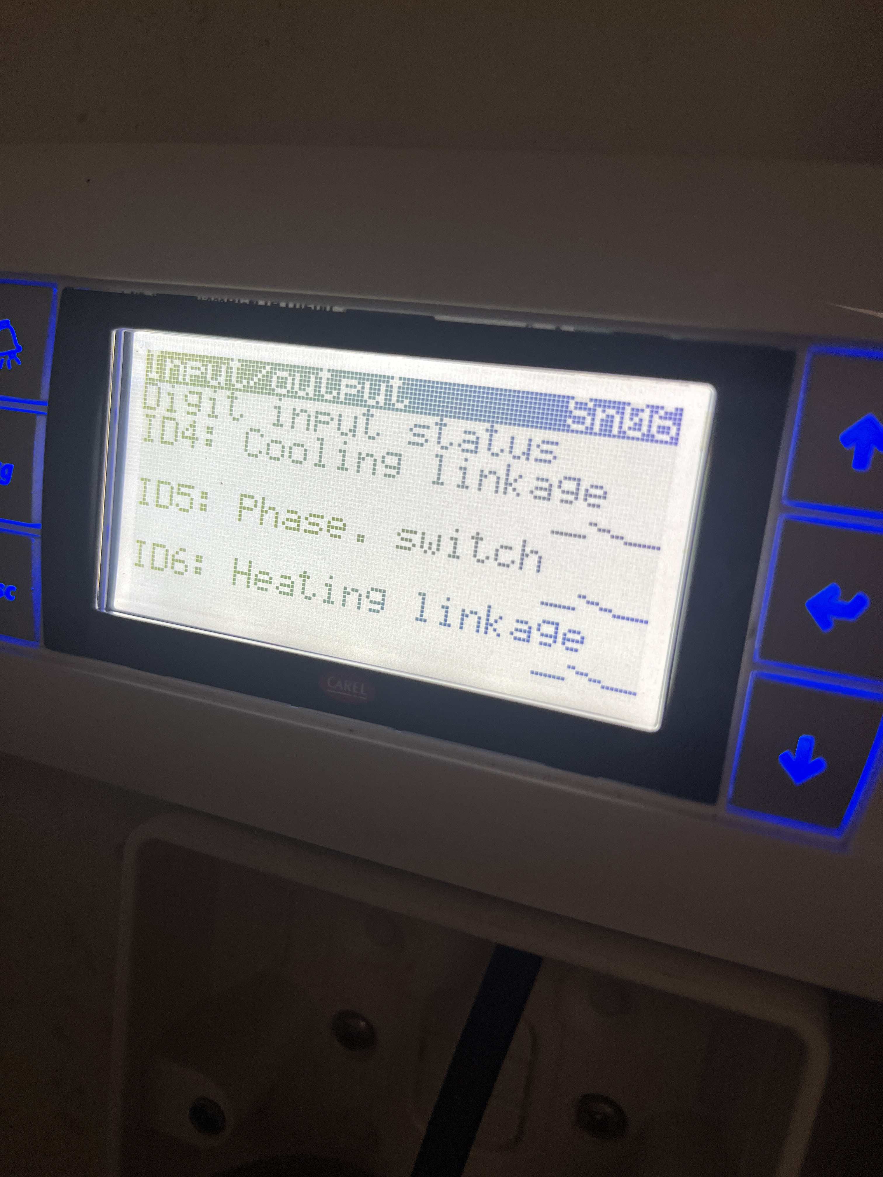

I’d like mine to have a little more options for cooling (dedicated cooling zone valve output for example, dedicated cooling call instead of a combined heat/cool call), but it does what we need
Hmm…. A dedicated call for cooling you say?IMG_0791.thumb.jpeg.980abe71cff797b7d1d4d66651ce4d71.jpeg
yep, that contact overrides the current mode set in User Mask, according to Chris...

Perfecto…. He’s at installer show this week so I’m not bothering him with questions.
So a/c linkage is a simple call for heat/cool with the ambient switching taking care of changing from heat to cool. The dedicated cooling call is just that and the same for heating call?
a/c linkage is simple startup yep.
