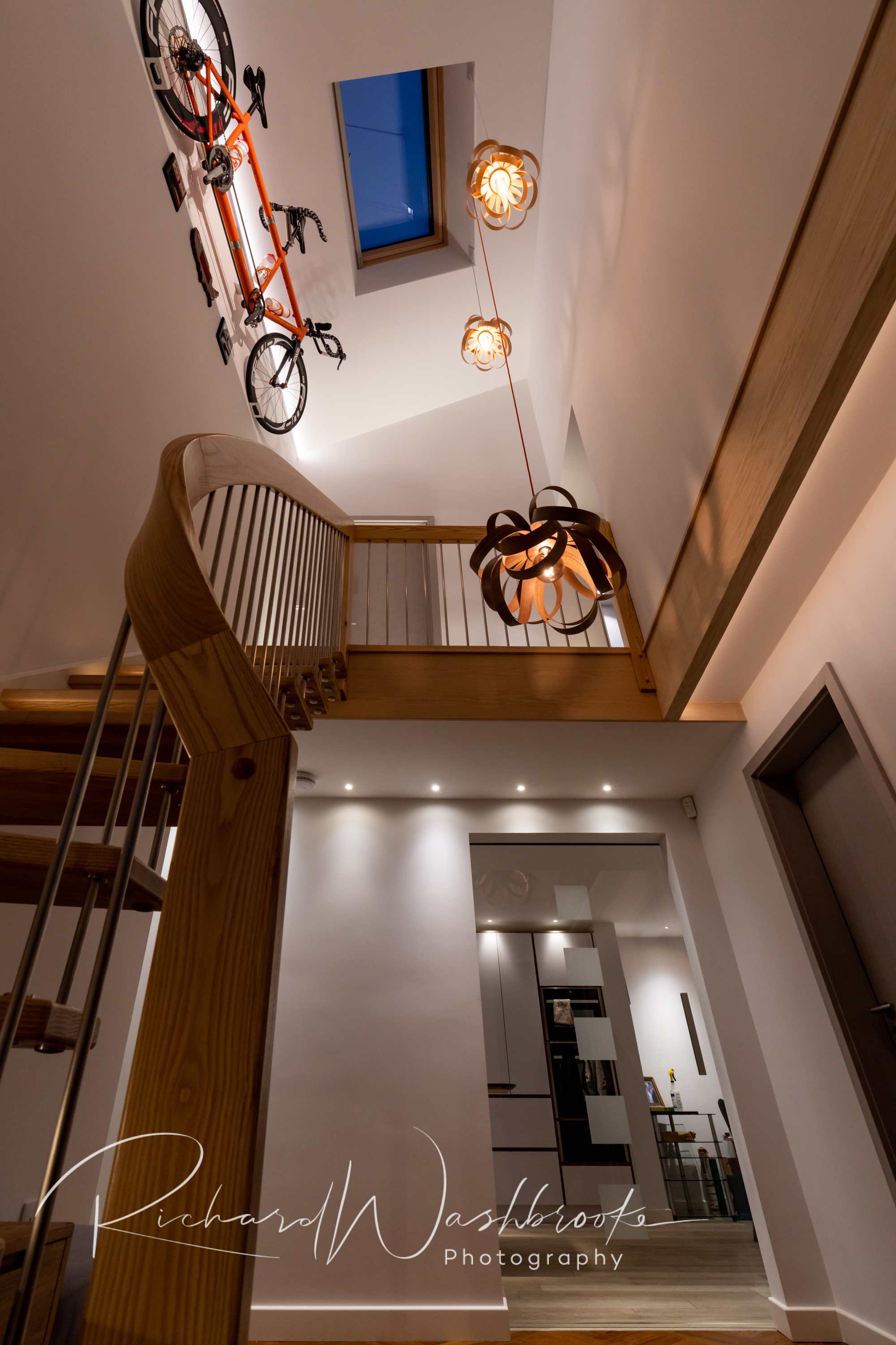

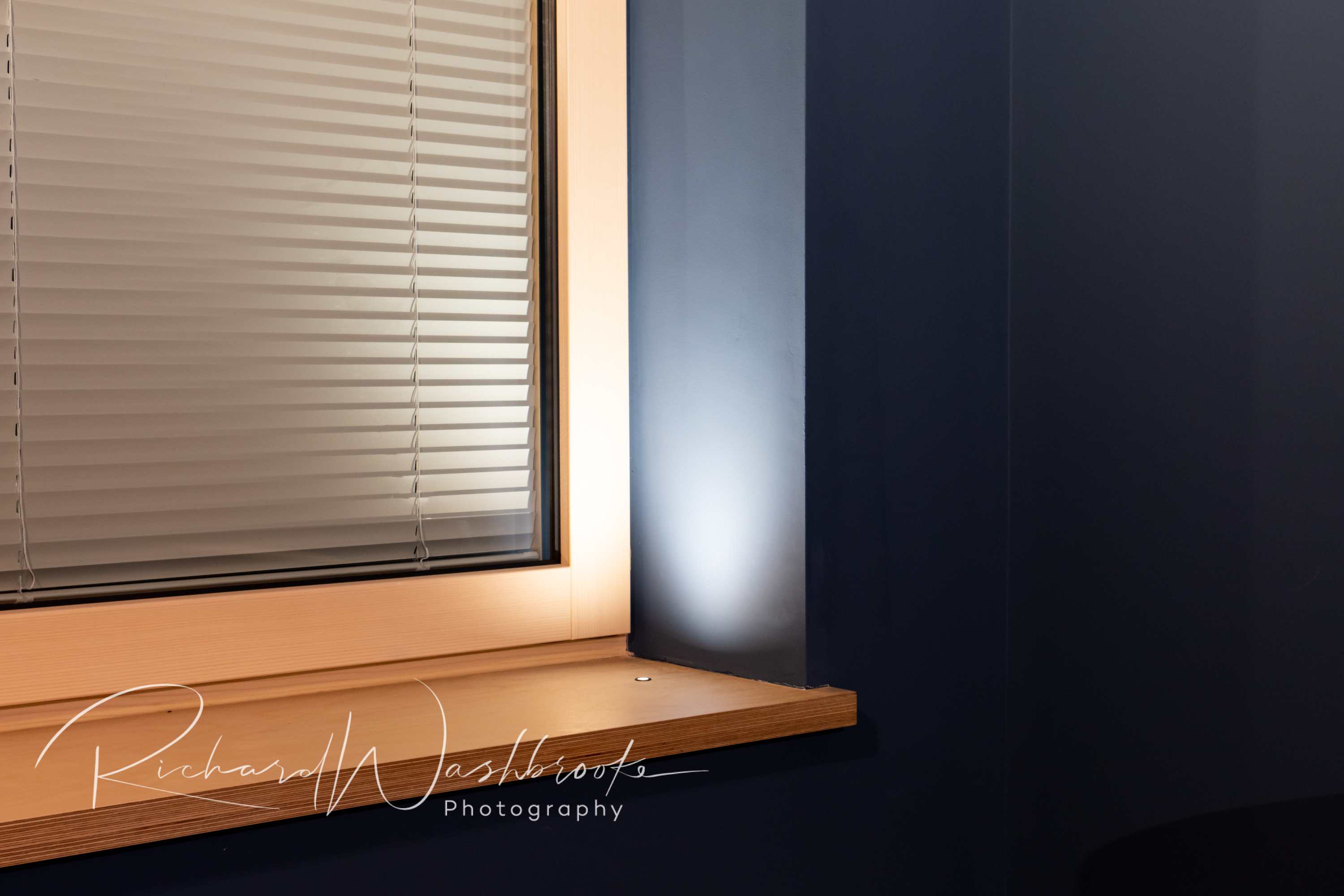

joth Posted June 11, 2025 Posted June 11, 2025 12 hours ago, SBMS said: I have been researching home automation and looks like loxone is a firm favourite. I’m moving on to look at lighting design. Would anyone (a) recommend getting a lighting designer and, if so, (b) have any recommendations. @jothand @Thorfun I seem to remember you used a lighting designer - any recommendations? My answer is very similar to @Dan F I'd already decided on Loxone, was originally desiging the lighting myself but my electrician thought I wasn't putting enough fittings in (from the usual one spot per 1.5m2 grid of approach lights school of thought) so I got a designer to review and then improve the design. The main benefit there is she modelled the lighting to determine if it was sufficient, the alternative would be over provision and dim. Also having loxone I wanted layers of lighting in main spaces, either for reflected atmospheric lighting or direct working lighting, and the designer helped a lot in details to make that work well - e.g. placement for fittings to give and optimal shaped "scallop" of light projected on walls, and suggesting details like small markers inside window reveals. She also had discounts on a few manufacture products she passed through, which against MRP probably paid the fees on its own. I'm really happy we went professional designer route, but it isn't for everybody 2 1
