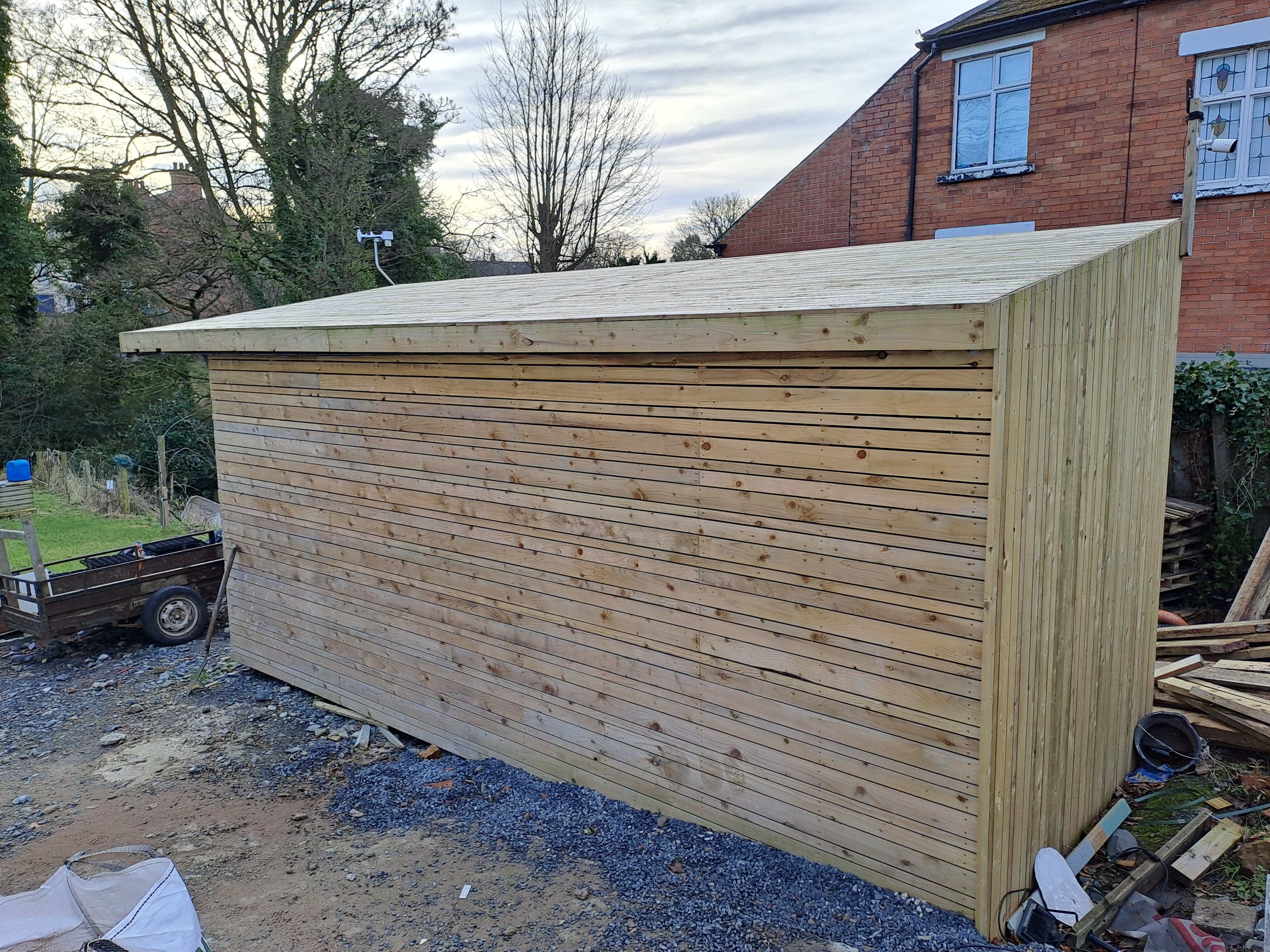

Conor Posted 13 hours ago Posted 13 hours ago I did my shipping container in planed 150mm fence boards. Ripped them in to different thicknesses, 100, 70 and 40mm I think. Still need to sand down and paint. Don't think it could be done cheaper. 1

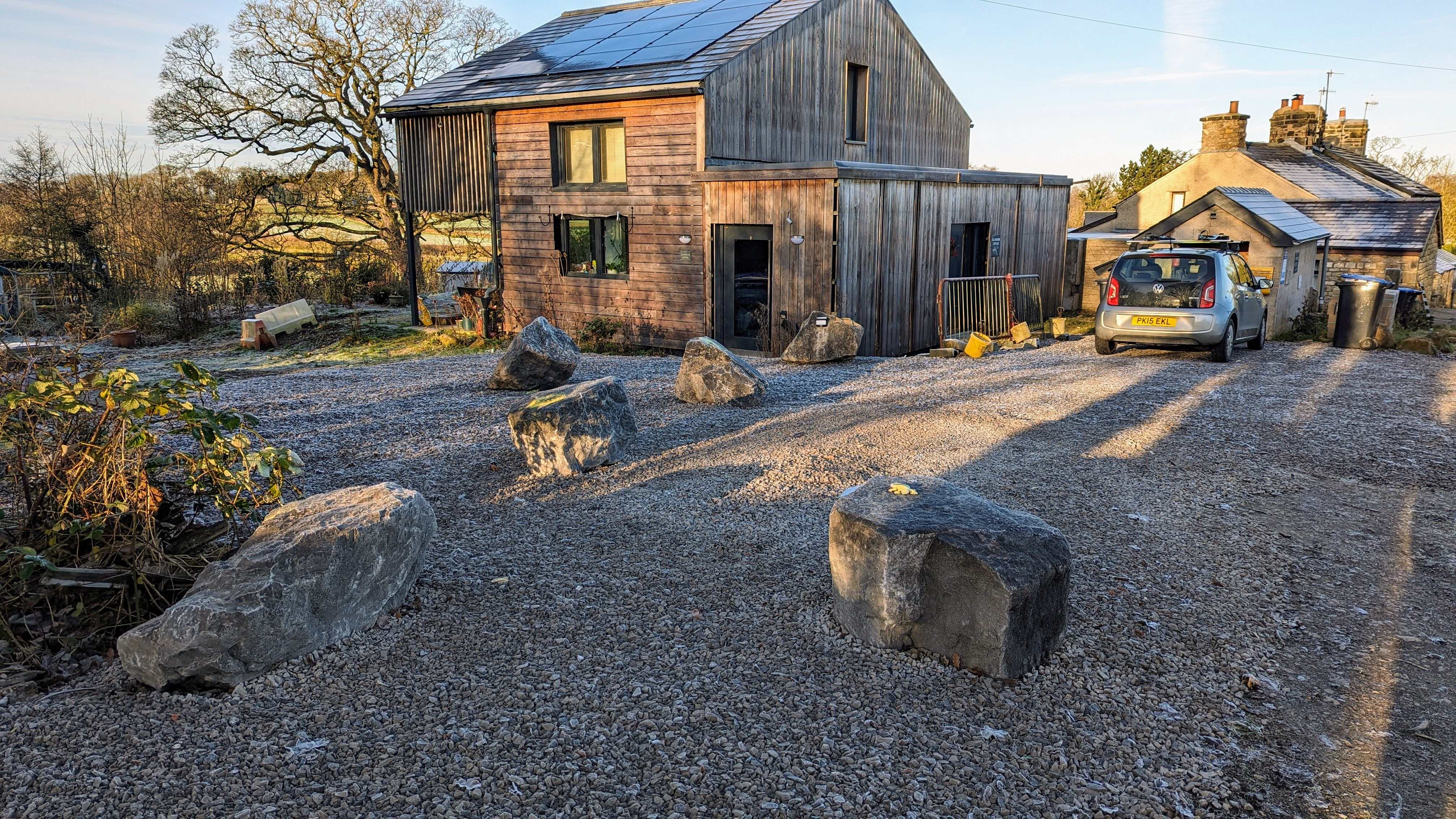

ToughButterCup Posted 11 hours ago Posted 11 hours ago Siberian Larch : starting to fade nicely. No treatment : 8mm shadow gaps (now often 10 or 12mm in some cases) @ProDave's detestation (above) is our preferred ' look ' Nowt so queer as folk eh? @Conor - your post above has just solved a problem for me. Thanks!

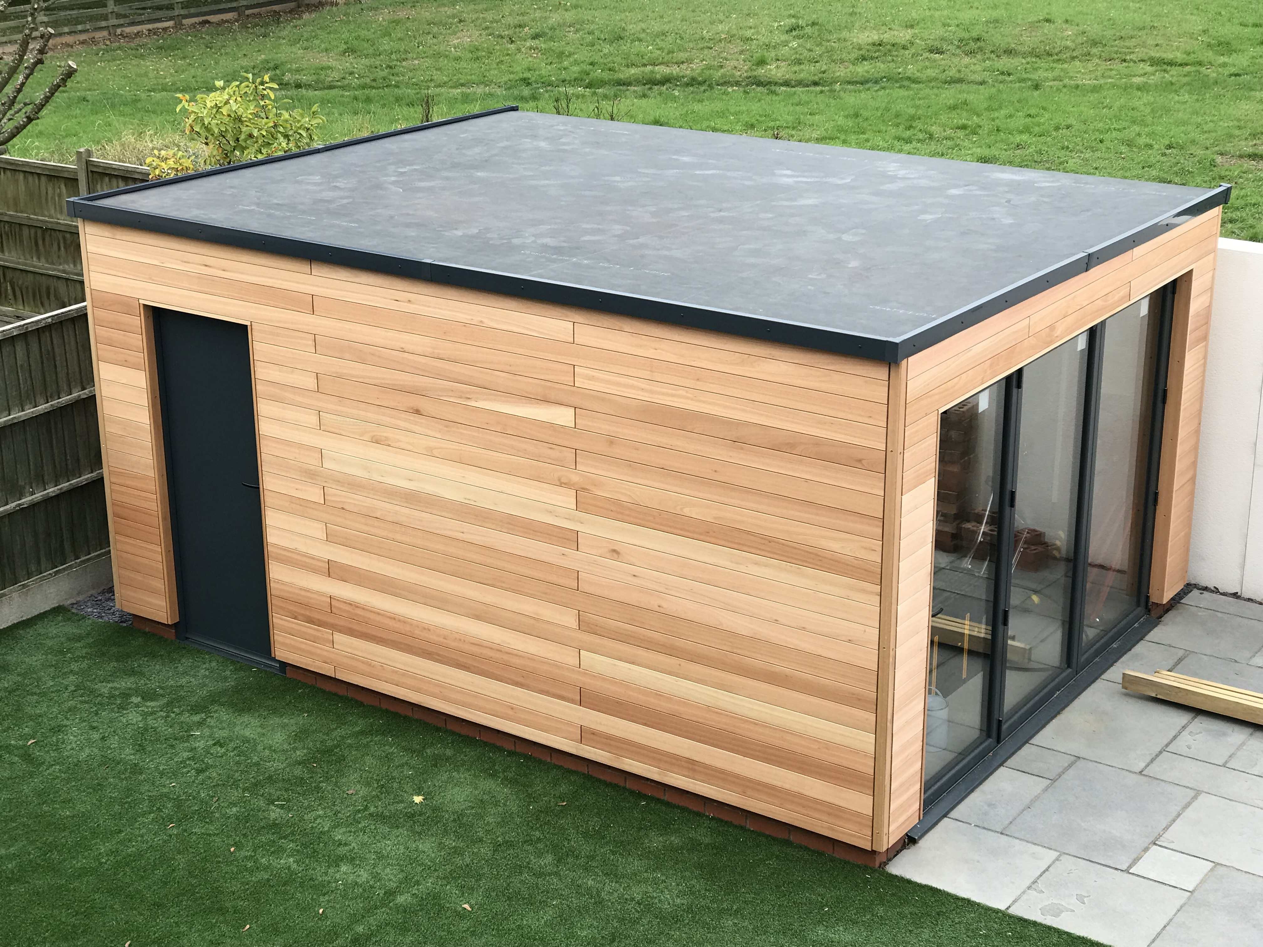

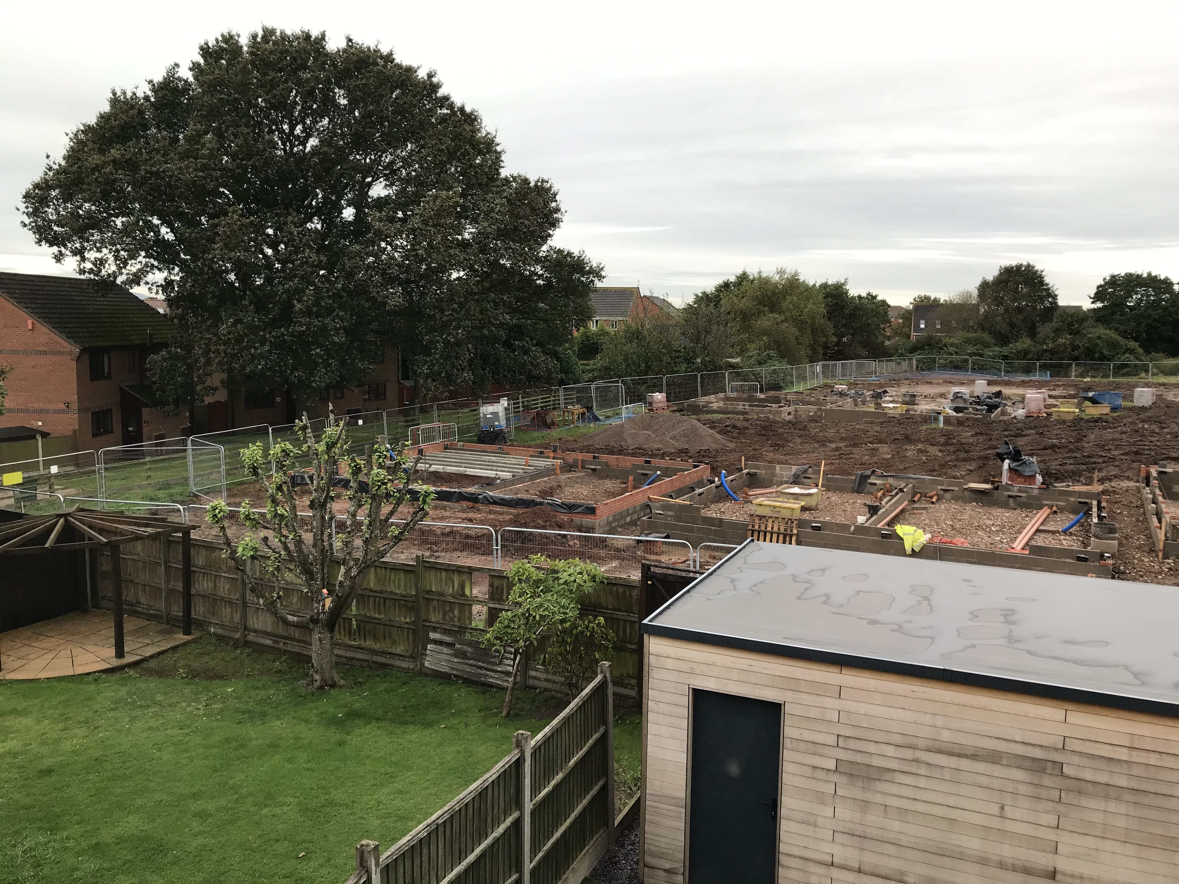

garrymartin Posted 11 hours ago Posted 11 hours ago We used Red Grandis on our garden room. Lovely material. https://co2grandis.co.uk/ The two photos are 2 years apart. The black staining on the second photo is just from the construction behind. The weathered look is best seen as the top boards before the roofline.
