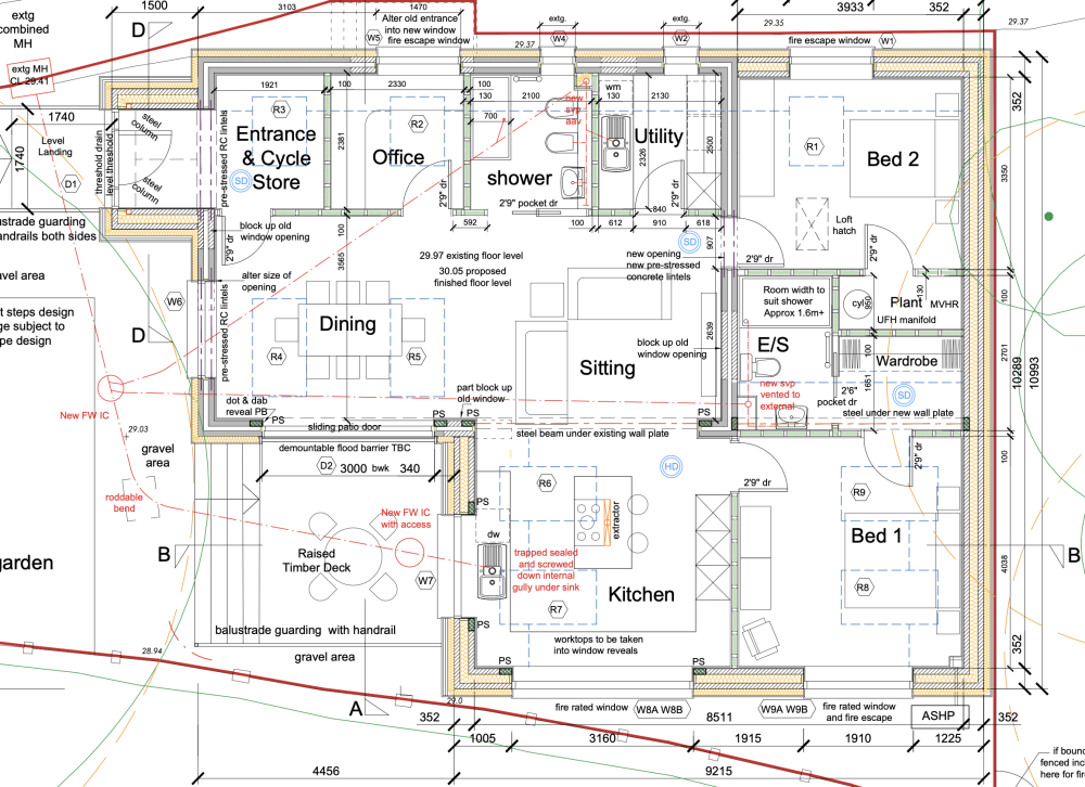

boxrick Posted June 3, 2025 Posted June 3, 2025 I am completely gutting my house, hopefully getting it quite airtight and installing a warm side ceiling void I have been quoted basically 7.5k + VAT ( design/ supply and commission without install ) and 8.5k+ VAT ( design and supply. No commission or install ) by 21 degrees and Paul Heat Recovery respectively, regarding MHVR install of a Zehnder Q350 + pipes + silencers and cooling battery. My first fix is looking to be around early July, and my final fix around late August. Simply put I am being quoted around 4-6 weeks for the design, when I am guessing I will need all my stuff much sooner than that. So my question is... whats my best option at this point? Do I just pay the deposit to one of these companies and hope for the best? Is a self guided route going to give me the same sort of performance and acoustics one of these companies is likely to specialise in? Any guidance or direction would be appreciated!
JohnMo Posted June 3, 2025 Posted June 3, 2025 17 minutes ago, boxrick said: cooling battery. Don't waste you money - read the many threads on here. At those prices I would be doing it myself and did. Your layout lends itself to a nice simple cascade system. First MVHR move away from bedrooms and install in cycle store. I would flow into dining and into office from there only. Dining flow will be most the house volume flow out of two outlets. Extract from all wet rooms and plant room. All other areas will be ventilated via cross flow or transfer flow.

JohnMo Posted June 3, 2025 Posted June 3, 2025 18 minutes ago, boxrick said: My plant room is located right next to shaded trees, surely it would be the best place for it? If my walls are insulated enough I shouldn't really hear it? What difference does the shaded tree make to plant room location? As I mentioned previously you can make install super simple, and reduce the number of ducts required etc. by moving the MVHR You can make the original location work, but you need to detail how the walks are built. If stud walls, you need 2x layers of 18mm ply on the full wall to dampen any vibration and high density insulation. Heat pump or boiler? Where are they located?
boxrick Posted June 3, 2025 Author Posted June 3, 2025 11 minutes ago, JohnMo said: What difference does the shaded tree make to plant room location? As I mentioned previously you can make install super simple, and reduce the number of ducts required etc. by moving the MVHR You can make the original location work, but you need to detail how the walks are built. If stud walls, you need 2x layers of 18mm ply on the full wall to dampen any vibration and high density insulation. Heat pump or boiler? Where are they located? Heatpump ( getting a heatgeek to design and install UFH / ASHP system for me ) , see blue for likely or red for preferred but unlikely ( depending on land swap with neighbour )

Nickfromwales Posted June 3, 2025 Posted June 3, 2025 2 minutes ago, boxrick said: Yea... as seen in other thread. Warm roof. Then you have plenty of options to route MVHR ducts, but the 2 companies you mention typically favour series run systems with galv distribution ducting, whereas I always use a radial setup with 92 or 75mm ducts; the aforementioned companies often specify systems which also require cross-talk and acoustic inline attenuators, which are a complete PITA to integrate into the fabric of a build. Would not be my first choice tbh, sorry. 1

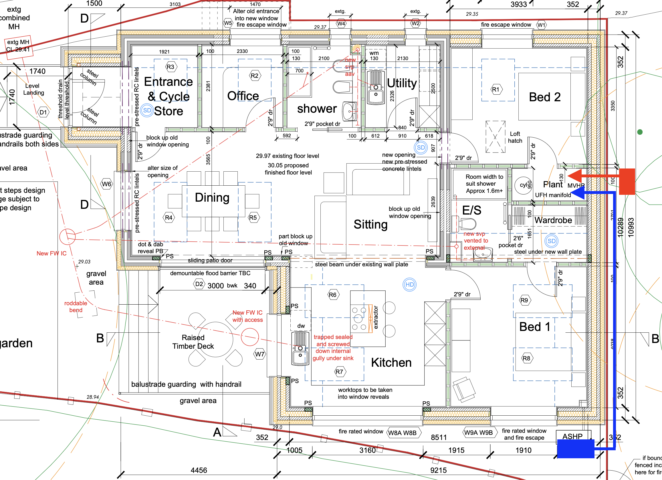

Tony L Posted June 4, 2025 Posted June 4, 2025 @boxrick, I think your blue ASHP is too close to the window; it should be 1m min. away.
boxrick Posted June 5, 2025 Author Posted June 5, 2025 16 hours ago, Tony L said: @boxrick, I think your blue ASHP is too close to the window; it should be 1m min. away. I'll move it closer to the border. Sadly looks like it's going to be the blue one now
JohnMo Posted June 5, 2025 Posted June 5, 2025 17 hours ago, Tony L said: @boxrick, I think your blue ASHP is too close to the window; it should be 1m min. away. 4 minutes ago, boxrick said: move it closer to the border. Sadly looks like it's going to be the blue one now The 1m rule only really applies to R290 heat pumps. R32 doesn't make much difference.
FarmerN Posted June 5, 2025 Posted June 5, 2025 On 03/06/2025 at 08:22, JohnMo said: First MVHR move away from bedrooms and install in cycle store. I would flow into dining and into office from there only. Dining flow will be most the house volume flow out of two outlets. Extract from all wet rooms and plant room. All other areas will be ventilated via cross flow or transfer flow. Are you suggesting no inlet ducts to the bedrooms or have I misunderstood?
