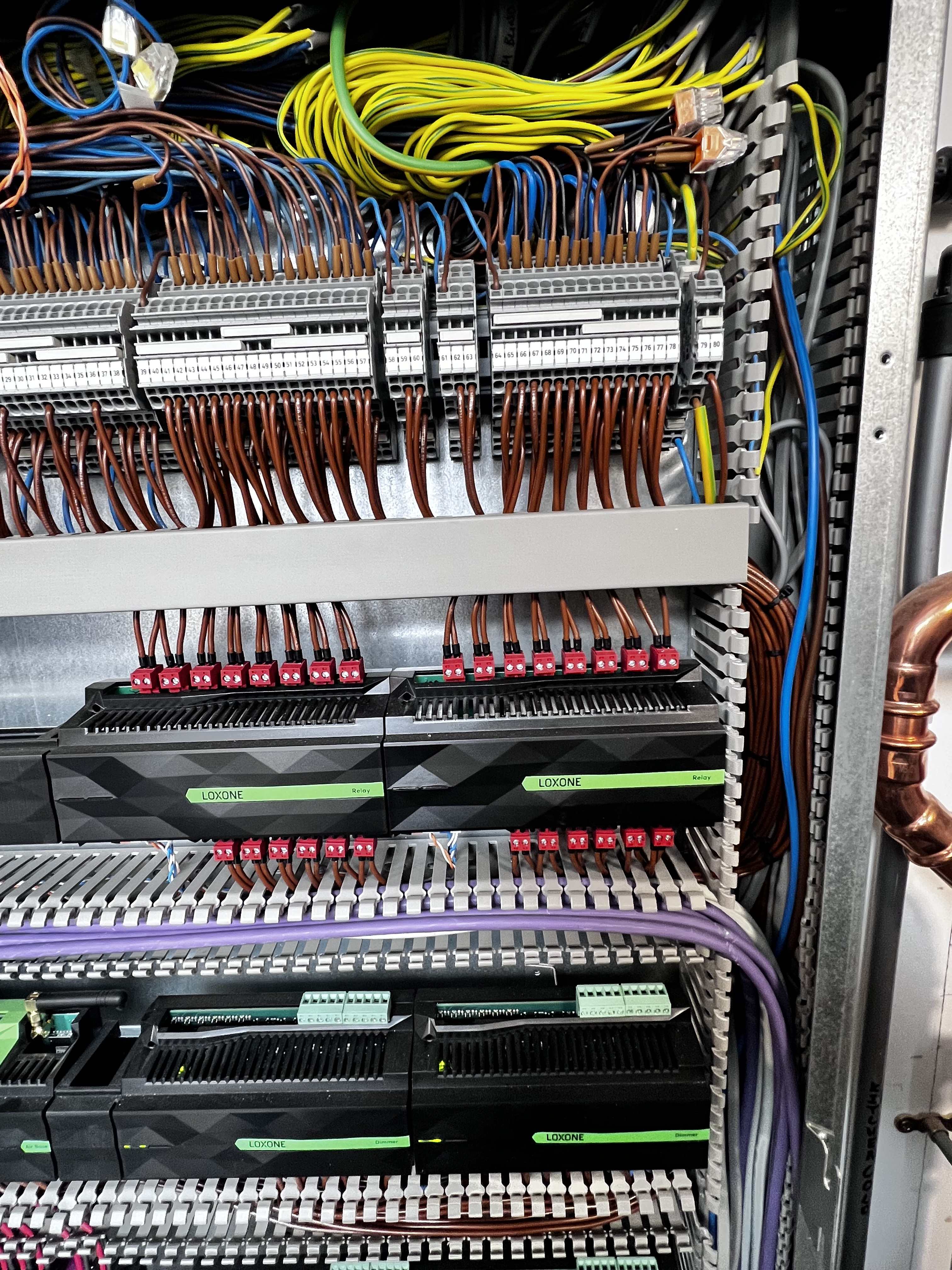

SBMS Posted June 1, 2025 Author Posted June 1, 2025 14 minutes ago, Kelvin said: The 16 downlights are wired as 4 separate groups of 4 and the others are also on their own circuits Thanks @Kelvin. Did you bring these back to your Loxone cab and then use 4x relay outputs from the mini server/extension? If that is the case - and get ready for a massive knowledge gap here in circuitry - how does that circuit receive power? So assuming there’s a T&E cable string coming back to your cabinet, how does that get wired (a) into the relay and (b) into mains power?
SBMS Posted June 1, 2025 Author Posted June 1, 2025 30 minutes ago, MikeSharp01 said: only one tweak and that would be to make sure you have enough ways (wires) to/from each switch to allow conventional wiring so if the switch would, in a conventional scheme, be a cross over then you need 4 ways plus earth or a change over then 3 ways and earth. I assume that if you ever needed to revert to standard switches, you put a standard switch in the wall and then make the connection between that switch and the lighting circuit in your central cabinet then (rather than at the switch itself?) Are these wires provided by CAT6, or are you running additional T&E from each switch back to the central cabinet and then using some of those wires for your Tree connections into the switches? Don’t suppose you have an example diagram to illustrate how to support both the Loxone switch and a potential reversion to a traditional setup if done later?

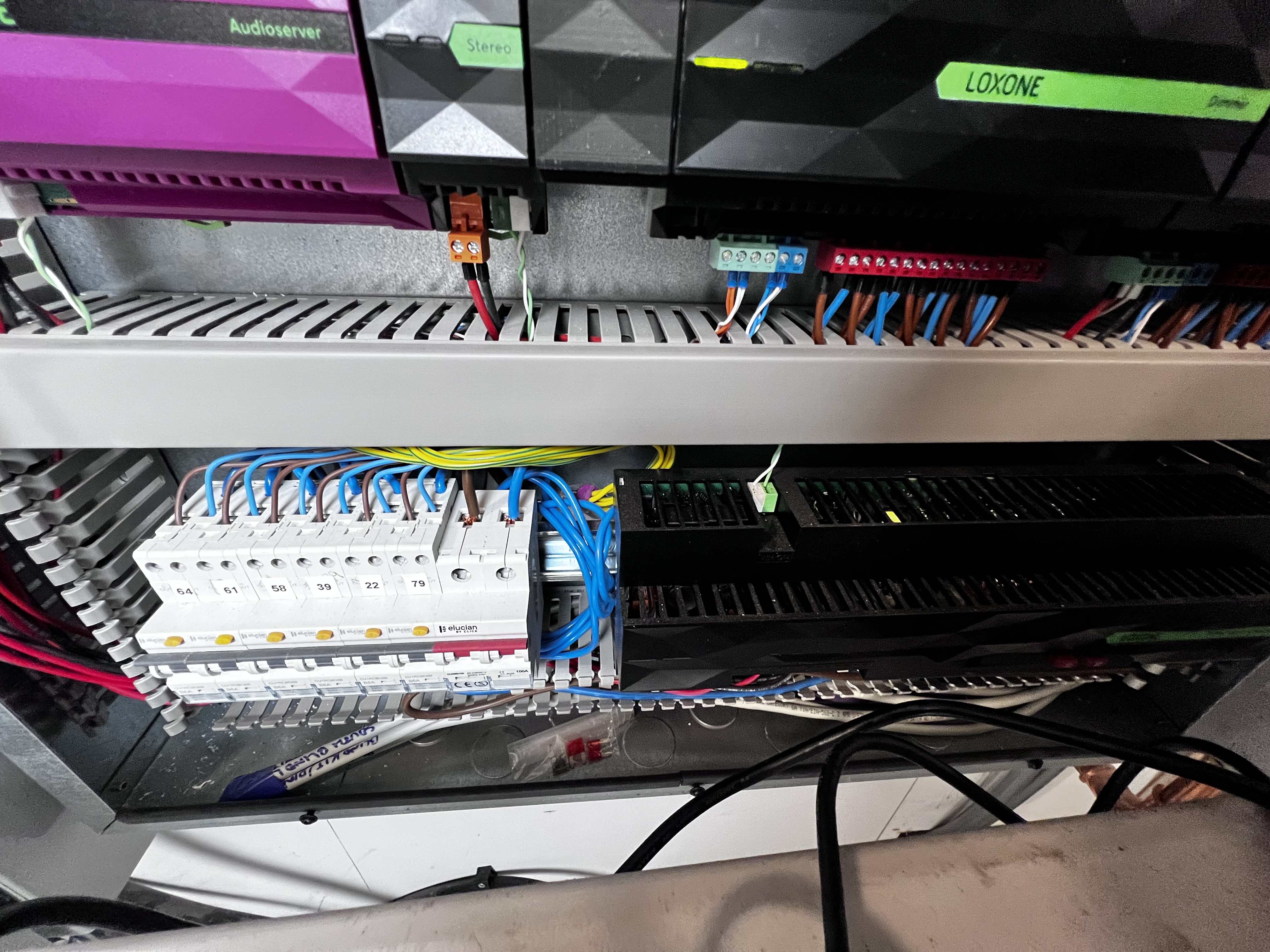

Kelvin Posted June 1, 2025 Posted June 1, 2025 9 minutes ago, SBMS said: Thanks @Kelvin. Did you bring these back to your Loxone cab and then use 4x relay outputs from the mini server/extension? If that is the case - and get ready for a massive knowledge gap here in circuitry - how does that circuit receive power? So assuming there’s a T&E cable string coming back to your cabinet, how does that get wired (a) into the relay and (b) into mains power? Like this. The lighting circuits come back to the panel and are connected to the either relay extensions or dimmer extensions. Power comes from your CU into the panel protection and whichever PSU you decide to use. I used the rather expensive Loxone PSU there are cheaper more flexible ways to do that.
SBMS Posted June 1, 2025 Author Posted June 1, 2025 1 hour ago, Thorfun said: Mike from Whitewing is now offering mains relays How would the loxone be able to control the white wing mains relays? Is this via the dmx extension (ie does the mains relay present the channels to the loxone via dmx)?
SBMS Posted June 1, 2025 Author Posted June 1, 2025 1 minute ago, Kelvin said: Like this. The lighting circuits come back to the panel and are connected to the either relay extensions or dimmer extensions. Power comes from your CU into the panel protection and whichever PSU you decide to use. I used the rather expensive Loxone PSU there are cheaper more flexible ways to do that. So does power go into the loxone PSU then into the relay? So when the relay is activated it is providing power to the lighting circuit (rather than simply closing a switch)?
Kelvin Posted June 1, 2025 Posted June 1, 2025 3 minutes ago, SBMS said: So does power go into the loxone PSU then into the relay? So when the relay is activated it is providing power to the lighting circuit (rather than simply closing a switch)? The Loxone PSU is powering all the 24V Loxone devices. The lighting circuits are 230V.
SBMS Posted June 1, 2025 Author Posted June 1, 2025 6 minutes ago, Kelvin said: The Loxone PSU is powering all the 24V Loxone devices. The lighting circuits are 230V. Think I’ve got it. So each relay out output has 230v live fed from the CU and then the live from The lighting circuit is fed into second relay contact?
Kelvin Posted June 1, 2025 Posted June 1, 2025 Yes pretty much. In my case I’m using the dimmer extensions for a few of the rooms where dimming makes sense and relay extensions for everything else. Mains dimming has its limitations but I only need three settings: full bright, dimmed (about 60%) for more ambience, and night (about 30%)
