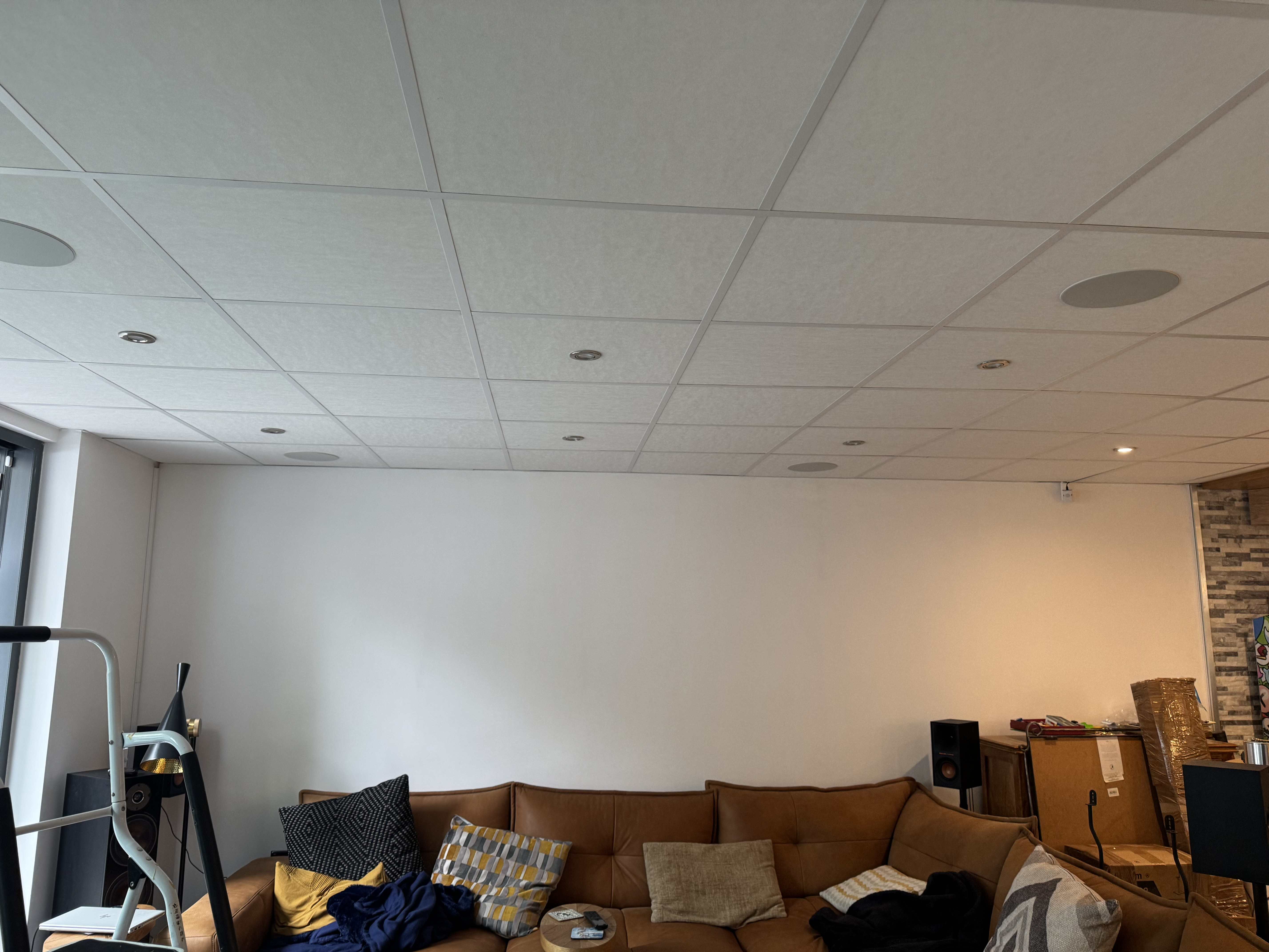

Kelvin Posted 10 hours ago Posted 10 hours ago Open backed speakers like these typically should be mounted so that they are enclosed. It improves the bass, and reduces sound from travelling to whatever is above them. There’s also a fire regulation depending on what is above them. I fitted all mine inside a fireproof hood and the difference in sound quality vs just having them open was significant. 2
Pocster Posted 8 hours ago Author Posted 8 hours ago (edited) 2 hours ago, Kelvin said: Open backed speakers like these typically should be mounted so that they are enclosed. It improves the bass, and reduces sound from travelling to whatever is above them. There’s also a fire regulation depending on what is above them. I fitted all mine inside a fireproof hood and the difference in sound quality vs just having them open was significant. I did read that . I assumed they don’t actually output a lot in atmos ? . Beam and block above so not really worried about sound transfer. Did look at ‘official ‘ sound backing boxes - ridiculously expensive. Link to yours ? . Fire regs 😂 - off a (expletive deleted)ing speaker in an underground house 🤣🤣🤣🤣 - don’t think I’ll worry about that one . Back boxes though for better sound ….. yes please Edited 8 hours ago by Pocster
Kelvin Posted 7 hours ago Posted 7 hours ago (edited) The fire regs aren’t to do with the speaker going on fire. You’ve cut a big hole in your ceiling and if there’s a fire in that room it can spread more quickly as the speaker is made of plastic mostly. I have two in the kitchen which has a bedroom above it for example. Depends on the room and what’s above it. I fitted them to improve the sound though. They do output quite a lot. Take your pick. You can size it to your speaker. You will need to cut it to fit. They are a pia to fit but with your 1980s office ceiling it will be easy for you. https://ceilingspeakerworld.co.uk/collections/fire-hoods-for-speakers?srsltid=AfmBOoqVbinaygWtUK1gX5ktvnSE2RlAqI6H7o1ggxG4MQ4MJBKM-nDB Edited 7 hours ago by Kelvin 1
Pocster Posted 6 hours ago Author Posted 6 hours ago 1 hour ago, Kelvin said: The fire regs aren’t to do with the speaker going on fire. You’ve cut a big hole in your ceiling and if there’s a fire in that room it can spread more quickly as the speaker is made of plastic mostly. I have two in the kitchen which has a bedroom above it for example. Depends on the room and what’s above it. I fitted them to improve the sound though. They do output quite a lot. Take your pick. You can size it to your speaker. You will need to cut it to fit. They are a pia to fit but with your 1980s office ceiling it will be easy for you. https://ceilingspeakerworld.co.uk/collections/fire-hoods-for-speakers?srsltid=AfmBOoqVbinaygWtUK1gX5ktvnSE2RlAqI6H7o1ggxG4MQ4MJBKM-nDB Yeah but it’s like 50 quid for 1 and I need 4 ! I’ll install as is . Then it can bug me “ would it better with an audio hood ? “ for a bit In this open plan room I’ve just counted 35 lights / sensors etc that are all holes in the ceiling 😊- so I take your point ; but I ain’t worried about that . The leak will put the fire out anyway 🙄😂.
Kelvin Posted 6 hours ago Posted 6 hours ago In a previous house I made MDF acoustic boxes lined with acoustic foam. Knock something up. 1
Pocster Posted 6 hours ago Author Posted 6 hours ago 13 minutes ago, Kelvin said: In a previous house I made MDF acoustic boxes lined with acoustic foam. Knock something up. Will I really tell the difference audibly ? . I suppose I could make 1 and try content with and without it installed I suppose . So just bolt a lined box over the speaker essentially?
Kelvin Posted 6 hours ago Posted 6 hours ago (edited) Speakers are fitted into enclosed boxes for a reason other than to stop them falling on the floor. The difference it made to mine was very noticeable. Edited 5 hours ago by Kelvin 1
