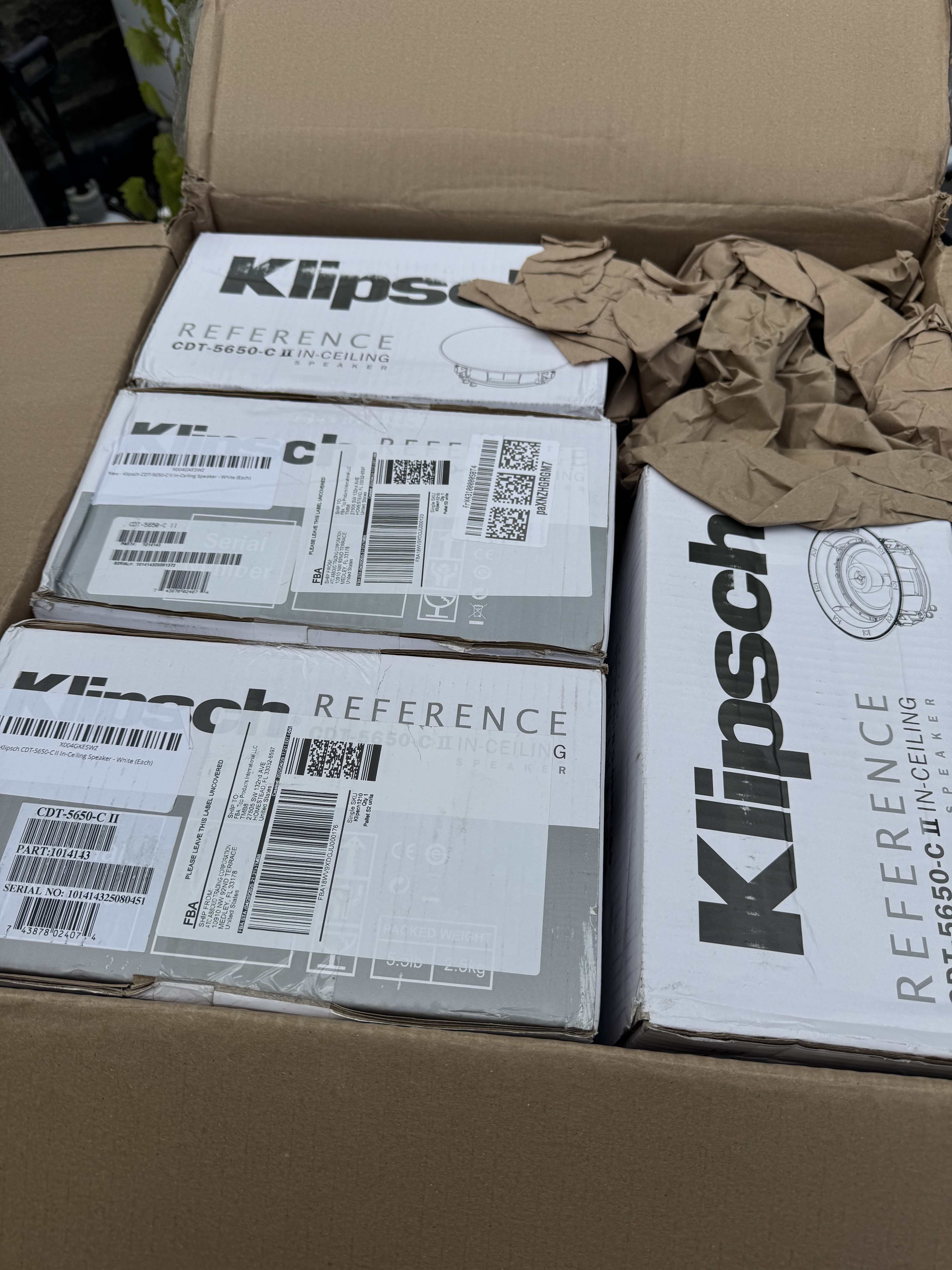

Pocster Posted 23 hours ago Author Posted 23 hours ago 28 minutes ago, Kelvin said: I have full HDR full resolution etc so it works fine. I’ve also had two monitors plugged into both ports the main TV and a shitty old TV with no problems. I guess it is just pot luck then . Too many variables !! . Denon apparently are ‘aware’ of the potential issue but don’t publicise it . If only by default it was on single monitor then the problem would be largely avoided . Still , I’m confident it’s fixed . The projector has always given an incredible picture in a light controlled room . Now the audio is ‘correct’ e.g getting Dolby atmos pushed through where before just didn’t . I am happy ! . Atmos ceiling speakers due anyday now …. 1
