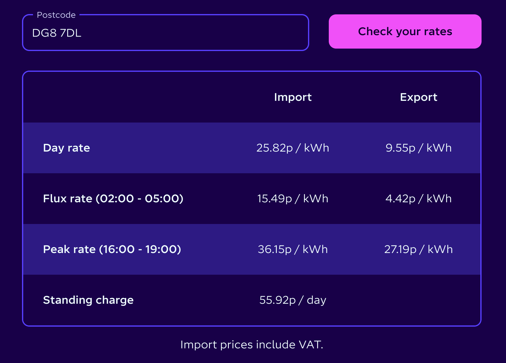

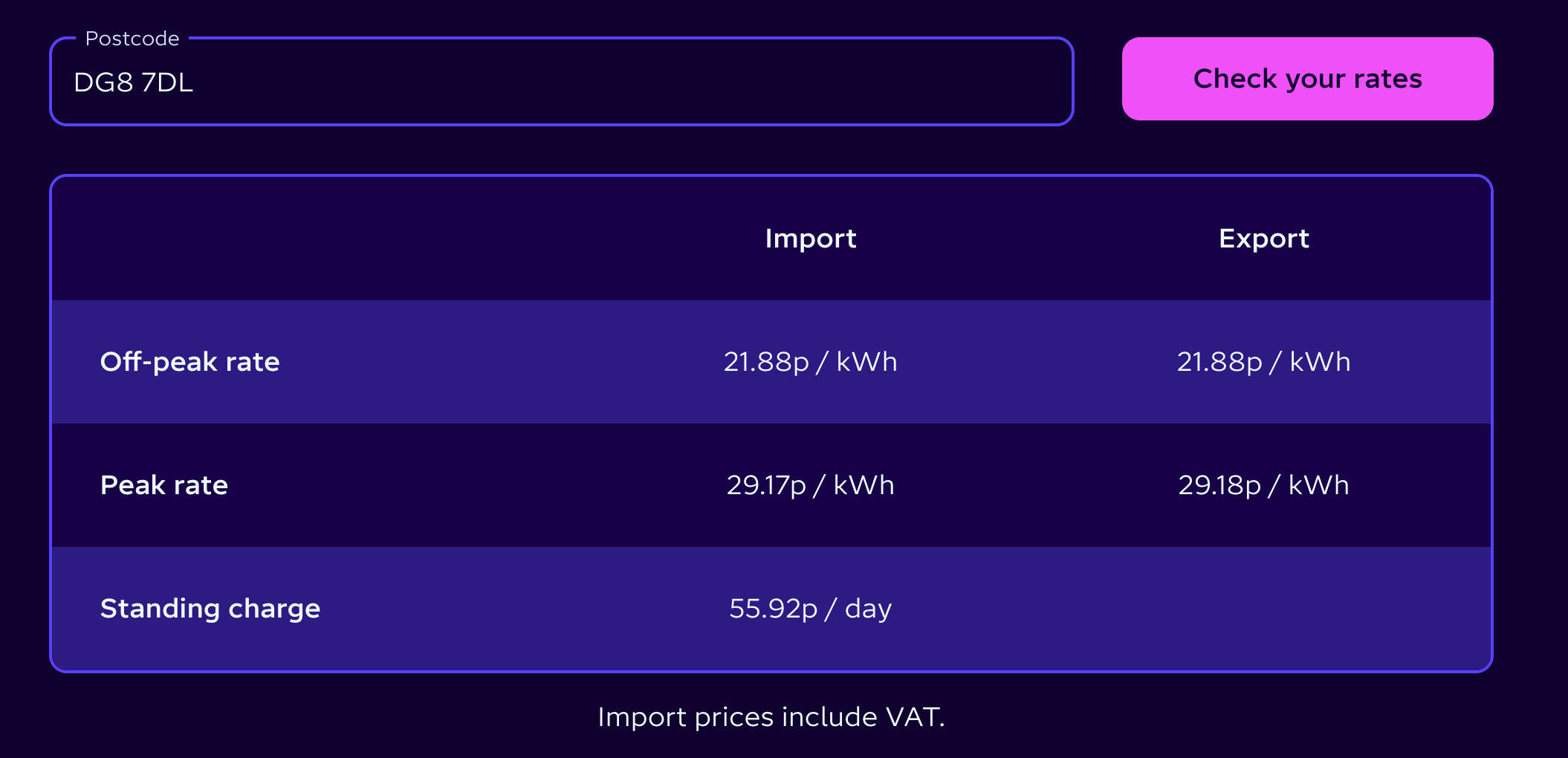

scottishjohn Posted June 7, 2025 Posted June 7, 2025 43 minutes ago, JamesP said: Hi John, Can you confirm your figures above. just go on octopus site and look for flux intelligent you have to enter youtr postcode so it might be different where you are just looked and i,m telling you lies import+export normal hours is same at 21.88 import+export atpeak times 4-7at night 29.18 for my postcode 1
scottishjohn Posted June 7, 2025 Posted June 7, 2025 (edited) found a screen shot octopus sent me a month ago for both flux and flux intelligent first one is flux lower one is flux intelligent Edited June 7, 2025 by scottishjohn 1
