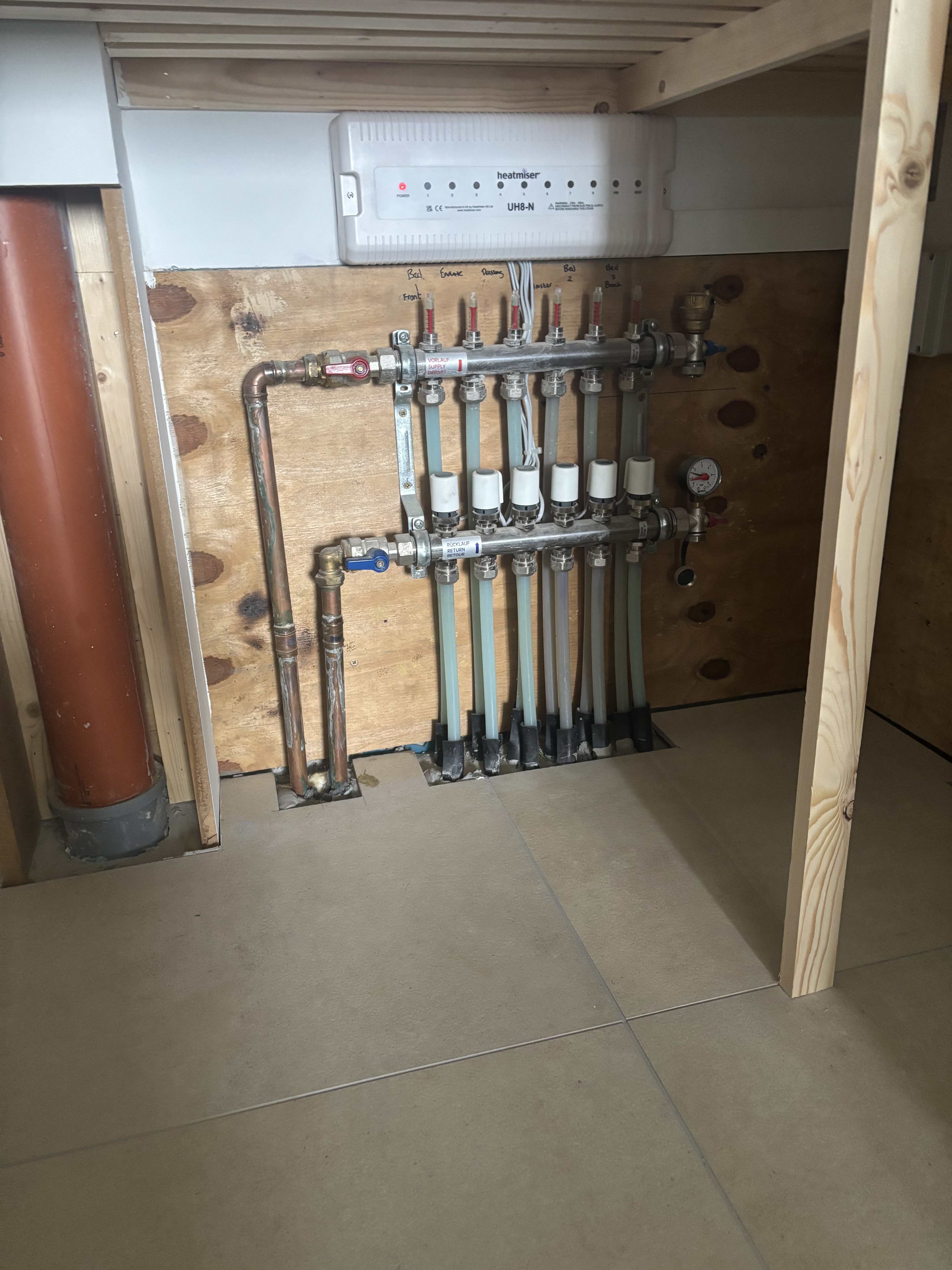

Richie Posted June 3, 2025 Author Posted June 3, 2025 UPDATE: Builder was up and removed the 2 toilets with the plumber, he did say the original fittings were not great. Smell is no longer in bathrooms but still in the hotpress( where SVP is located) at random times throughout the day but it comes and goes. He removed the bottom of the plaster board the other day to expose the pipe but on that particular day there was no smell in hotpress. I came home today and went to hotpress and could smell the strong odour. Got on my hands and knees to smell bottom of pipe but couldn’t smell anything from the pipe itself however to the right of the SVP is the underfloor heating pipes and I could definitely smell the odour coming from the back of them. I believe the SVP goes under the floor I hotpress and into the bathroom beside it. I mentioned this to builder but he can’t understand how the smell would come through so much concrete, insulation, radon barrier and floor screed . At this stage I believe a camera maybe be required. I have attached picture of area
ProDave Posted June 3, 2025 Posted June 3, 2025 Pester him to do that drain pressure test. Only that will tell you if there is a leak in any part of the drainage system. Without that he is poking around at random, getting nowhere and not solving the problem. 1
saveasteading Posted June 4, 2025 Posted June 4, 2025 14 hours ago, ProDave said: that drain pressure test. Builder seems to be avoiding that?
