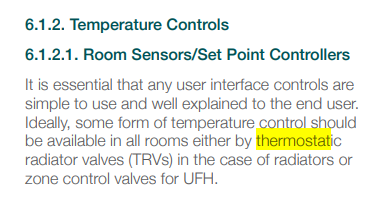

I found this
The use of the word "ideally" rather gives the game away doesn't it? In contractual documents it recognises that the advice following it is not going to be observed by many/most recipients. You could anyway argue that the presence of lockshield valves is "some form of temperature control".
