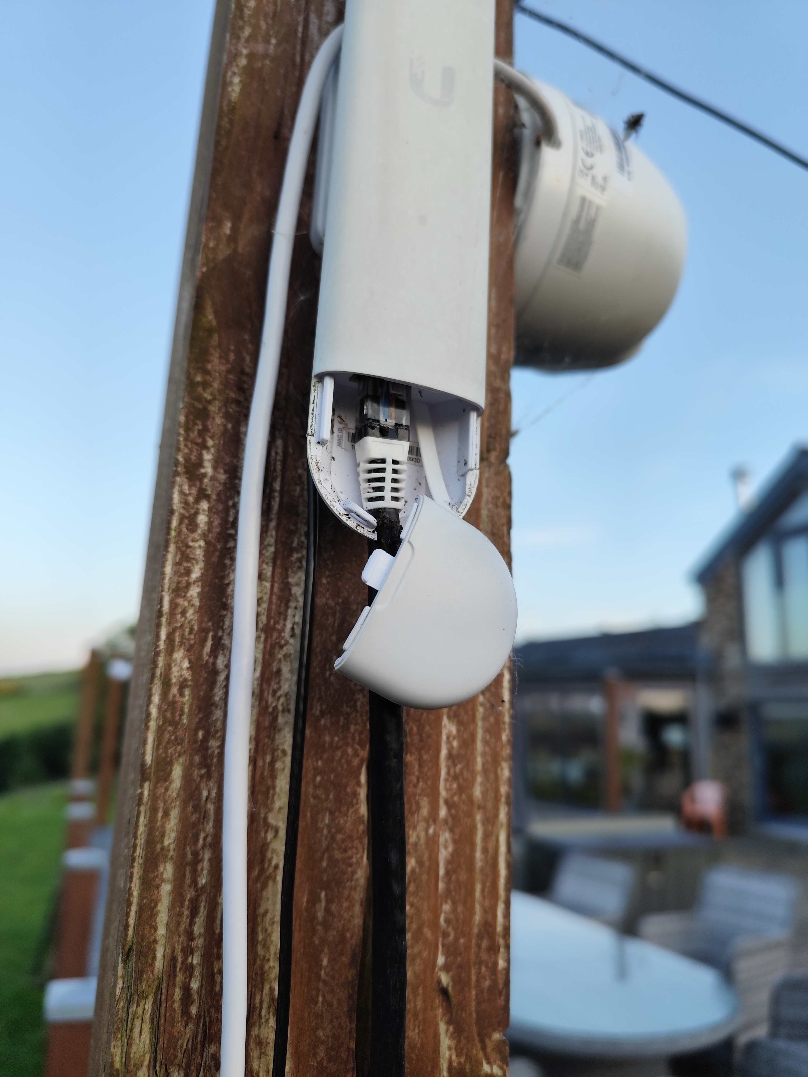

Pocster Posted May 15, 2025 Author Posted May 15, 2025 1 minute ago, pudding said: Absolutely no way you can you drill a hole through a wall somewhere and poke a CAT 6 out for POE and data and avoid the mesh? Makes it so much simpler. I've got an AC Mesh on my decking via POE and its worked great, nice long range coverage up to the garage. I’ve got a poe cable out there direct from the network switch . Atmospheric issues causing me trouble . It’s in a plastic water proof box . I’ve cleaned it etc - all fine for a few days . Then with damp weather it just fails again
pudding Posted May 15, 2025 Posted May 15, 2025 Whats in the plastic box, the Swiss army knife? Don't you just put the cable straight into it, and then mount it on a wall or post?
Pocster Posted May 15, 2025 Author Posted May 15, 2025 1 hour ago, pudding said: Whats in the plastic box, the Swiss army knife? Don't you just put the cable straight into it, and then mount it on a wall or post? Yeah . But before I’ve had poe mesh routers in there and the connection always seems to degrade . Clean the rj45 and it’s good for a bit . Box is a proper waterproof box with gaskets etc . Just seems the rj45 plug doesn’t like the atmosphere- hence resorting to WiFi only as it avoids the issue .

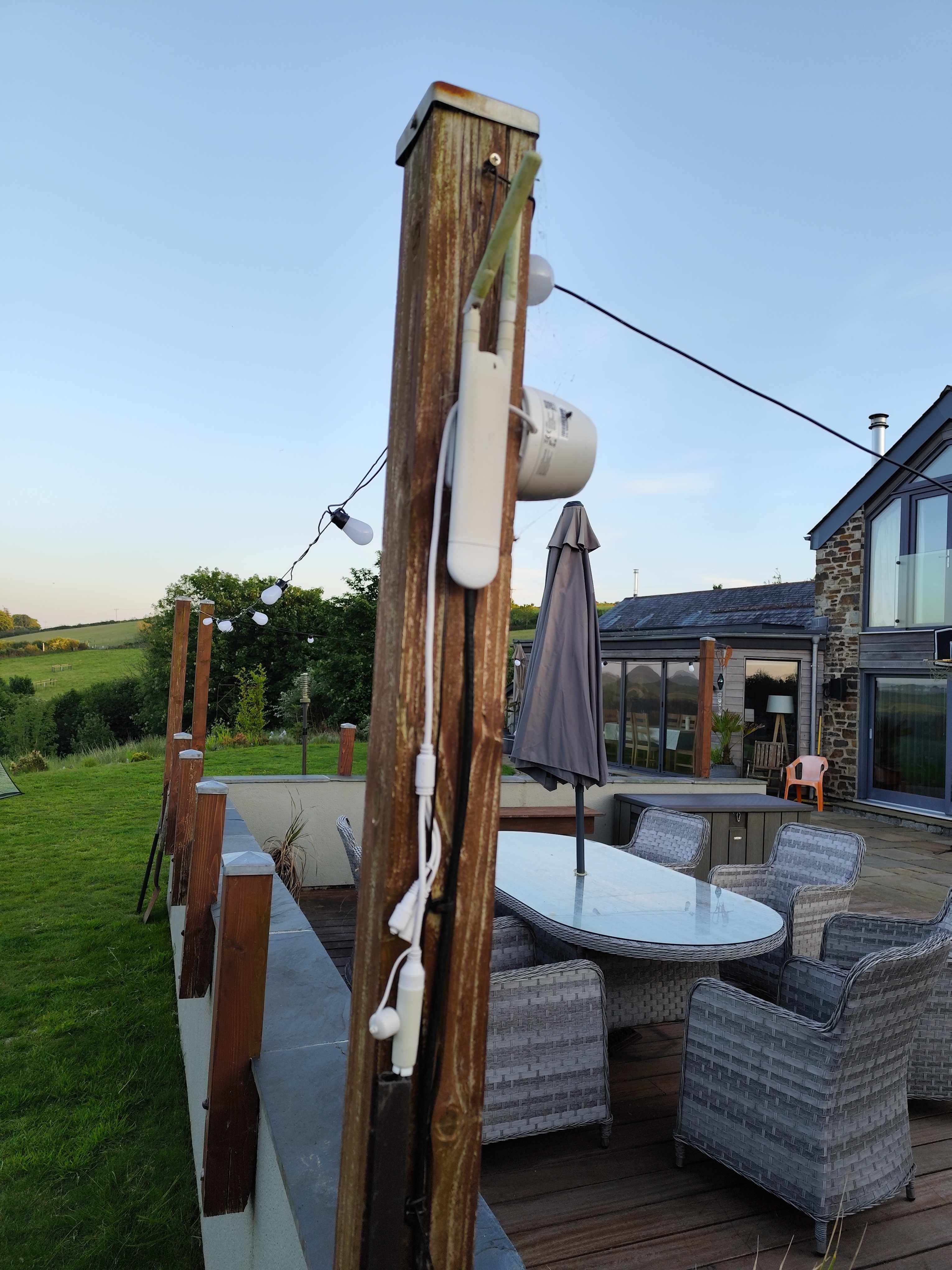

pudding Posted May 15, 2025 Posted May 15, 2025 Hmm weird. I've had my AC Mesh with the RJ45 plugged into the bottom for probably 2years now just outside on a 4x4 post about 2m high, completely exposed and no issues. Got any other plugs to try, cut the old one off and crimp a new one on? Just been outside to take these 2 pics of it, and remember the cable I used was outdoor rated CAT6, which had some gel stuff surrounding the 8 cores, maybe that makes a difference? 1
Pocster Posted May 15, 2025 Author Posted May 15, 2025 36 minutes ago, pudding said: Hmm weird. I've had my AC Mesh with the RJ45 plugged into the bottom for probably 2years now just outside on a 4x4 post about 2m high, completely exposed and no issues. Got any other plugs to try, cut the old one off and crimp a new one on? Just been outside to take these 2 pics of it, and remember the cable I used was outdoor rated CAT6, which had some gel stuff surrounding the 8 cores, maybe that makes a difference? Your atmosphere must be better than mine ! 😊 Had issues with lots of rj45’s outdoors on cameras etc . Outdoor cat5 cable . Tests fine . Only thing that’s surviving is a ip camera with a fly lead female rj45 ; so the male and female go in a snap shut gel box . If only outdoor AP’s had a fly lead connector ! But I’ll try the ac-m which it looks like what you have .

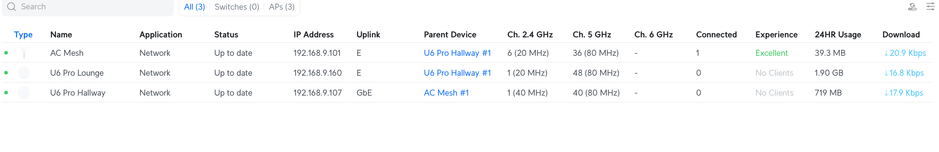

Pocster Posted May 18, 2025 Author Posted May 18, 2025 I'm confused! These 3 devices are all plugged into the same poe switch. Yet 1 shows Gbe and the other just E, why? Also what's all this parent thing - I can get it to change ; but surely none of them have a parent as all supposedly backhauled????

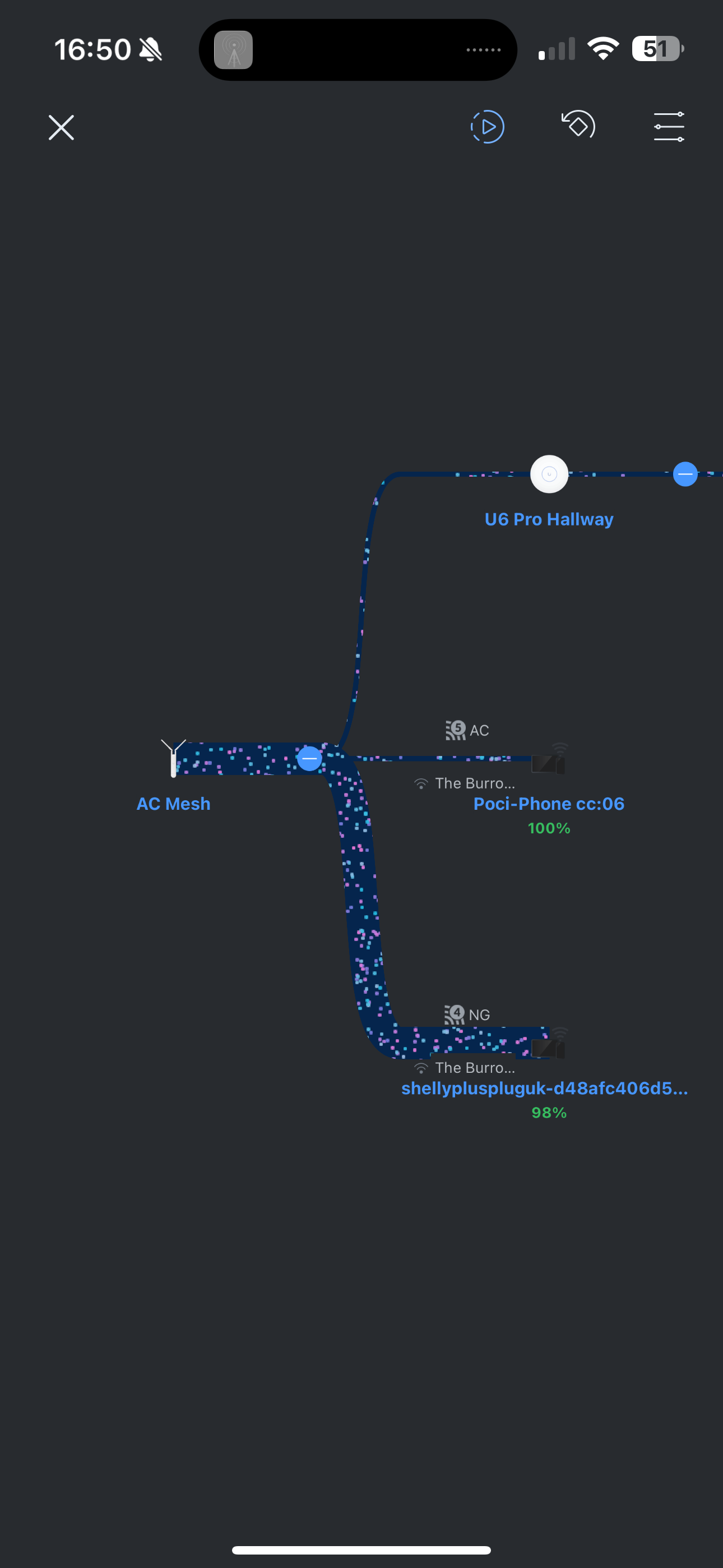

Pocster Posted May 18, 2025 Author Posted May 18, 2025 This - topology connection diagram - confusing or correct !?
Pocster Posted May 18, 2025 Author Posted May 18, 2025 Hmmmm , re adopted everything now the connection is showing as Gbe for everything . This parent thing ( after googling ) seems not to be a real topology thing - so…… I ignore it !
Adsibob Posted May 18, 2025 Posted May 18, 2025 On 15/05/2025 at 18:40, pudding said: Don't you just put the cable straight into it, and then mount it on a wall or post? That’s how I have my Ubiquiti Swiss Army knife set up. Works very well. Managed to send a WiFi signal down a 20m side passage between two houses. I do have the external antennae on it though, in sure they help. We haven’t had much rain since I installed this a couple of months ago, but it works fine.
