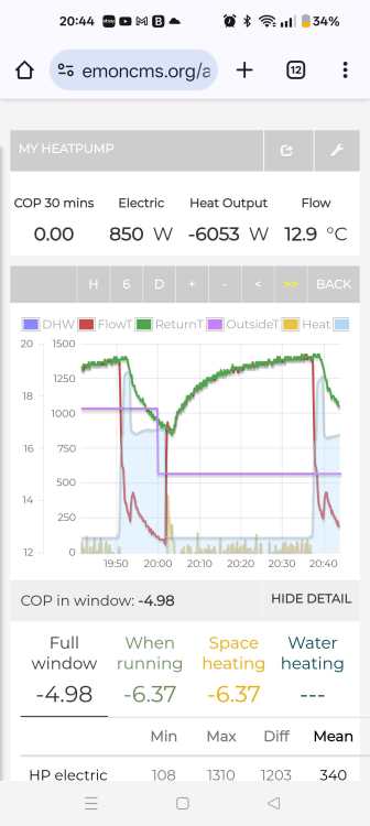

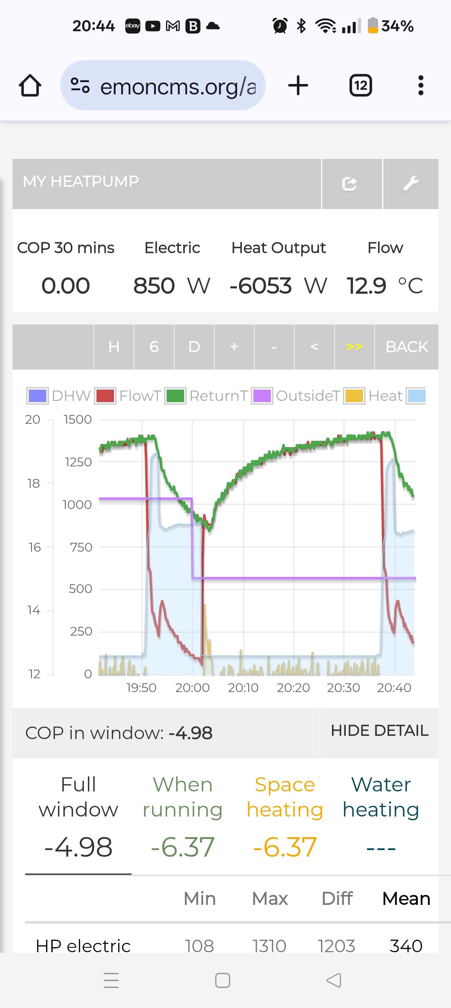

My target flow temperature is 12.5 degs. But pipes are in 100mm concrete. Floor temp is closer to 19.5, so never see any issues. Now on year two doing cooling. Typical heat pump cycling
Red line is flow temperature, green is return. Purple line is outside temp.

So you don't have any pipes anywhere indoors in voids anywhere that could see condensation?  I read somewhere that anything below 18C was risky for (unseen) condensation  leading to damp/rot problems down the line.
Be careful what you read always check yourself.
Yes I have pipes inside and an uninsulated UFH manifold. No voids though. But nothing runs below dew point and that's the important bit, so are always dry.

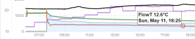

whilst cooling my flow goes as low as 12.5 degrees however return is circa 15 so somewhere in the middle.  I haven't noticed any condensation anywhere
