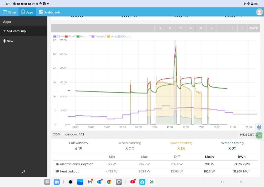

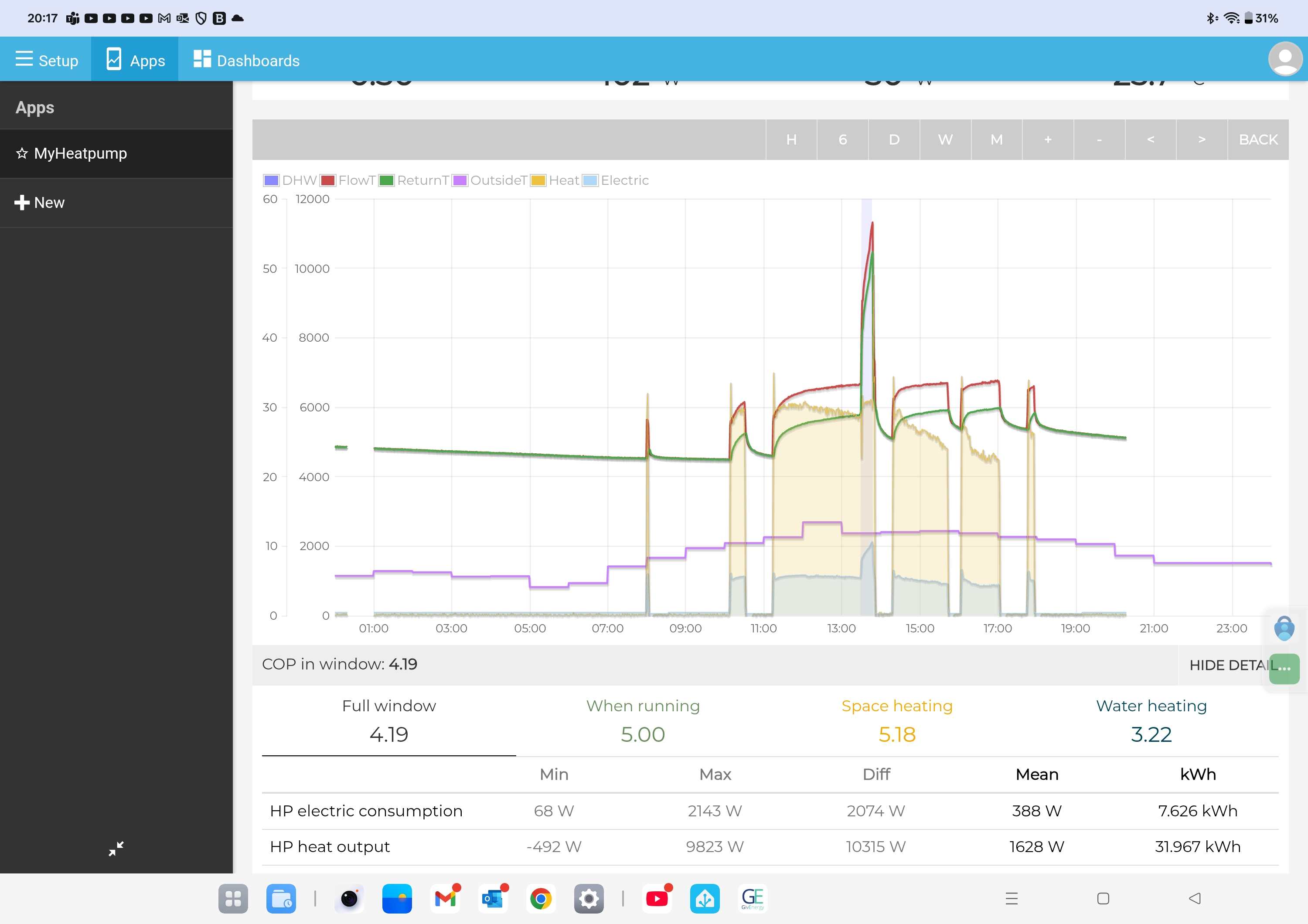

JohnMo Posted April 24, 2025 Posted April 24, 2025 1 hour ago, Iceverge said: Is your house kept at the same temperature constantly or do you intermittently heat it? We heat intermittently, but house stays pretty stable temperature wise. So today our average temp over the day is about 8 degs, so we are still in heating mode, but are getting plenty of solar. So heating is generally powered by PV (since start of March) and a floating battery state of charge to get reasonable run times. So the heating is free - can't do that with gas or oil or with direct electric heating (without a solar farm). So turns a modest PV excess of 7.6kWh in 32kWh. Any additional went into hot water via immersion
JamesPa Posted April 25, 2025 Posted April 25, 2025 (edited) 17 hours ago, Iceverge said: Is your house kept at the same temperature constantly or do you intermittently heat it? At the current time, like @JohnMo, its heated intermittently, because the ASHP cant possibly modulate down far enough and there is anyway solar gain during the day, so the heating switches itself off from about 9am till 10pm. The house stays at a fairly constant temperature because of thermal mass/solar gain. Unlike @johnmo I don't have a big concrete slab, its a 1930s house remember, but the heat capacity is nevertheless roughly 20kWh/K. The loss at -2C is about 7kW, so even at -2 it takes 3 hrs to drop a degree, at a more average 7C its nearer 6hrs to drop a degree, hence little saving in loss (and thus heating bills) from part-time heating Over the past 5 years I have gone successively from gas fired, intermittent heating throughout the season, trvs everywhere, flow temperature as installer left it (ie high, about 75C) gas fired, heating 24*7 in the height of the season, intermittently towards the ends of the season, trvs everywhere; flow temperature turned down to 50 (lowest possible on my boiler most of the season), 55 in the height of the season (necessary to get enough out of the rads) ASHP, set to heat 24*7, in practice heating 24*7 in the height and shoulder of the season, intermittently towards the ends of the season. Only 2 rads out of 16 with any form of thermostatic control otherwise open loop Each step has both increased comfort (because of reduced thermal gradients) and reduced my bills. I'm now looking at bills 25% lower than when I was doing the 'conventional' thing of gas boiler with bells and whistles controls and heating early morning and afternoon/evening only. The comparison is like for like, ie I have taken out the effect of price changes, and is actually an underestimate because I am not taking into account the fact that some of my space heating now comes from solar (unlike @JohnMo this isn't free because I get paid 15p/kWh for export, but it is less than my import rate) I would be dismissing this as chance were it not for the fact that there are good thermodynamic arguments why excessive zoning (whether in time or space) reduces the house energy demand by much less than the manufacturers of complex controls like us to believe. See Heatgeeks discussions on this from time to time. Of course the detail will vary from house to house. Edited April 25, 2025 by JamesPa
JohnMo Posted April 25, 2025 Posted April 25, 2025 24 hours later, we are now in cooling mode. Cooling switched on this morning. That will be left to get on with it until end of September now. Running pretty much a fixed temp. So far today running 15 mins on/25 mins off cycle this morning getting a negative CoP of just over 8. Yes 8 - you have to love a heat pump.
