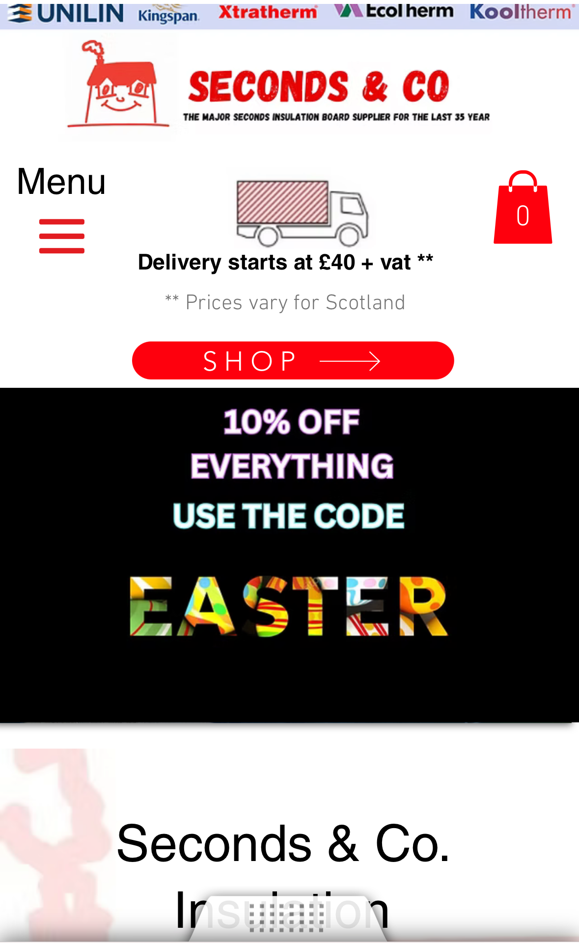

Benpointer Posted April 19, 2025 Posted April 19, 2025 Regarding Seconds and co, they advertise their PIR boards as being 70/80mm or 90/100mm but I want 100mm, not 90mm nor do I want a mixture of 90 and 100mm. How do I know what I'm going to get?
JohnMo Posted April 19, 2025 Posted April 19, 2025 13 minutes ago, Benpointer said: How do I know what I'm going to get? You don't Shop around and buy what you want - simple. I couldn't be bothered guessing, or messing about with odds and ends, so I shopped around, bought exactly what I needed. 1
Super_Paulie Posted April 20, 2025 Posted April 20, 2025 14 hours ago, JohnMo said: You don't Shop around and buy what you want - simple. I couldn't be bothered guessing, or messing about with odds and ends, so I shopped around, bought exactly what I needed. Same. Looked at the seconds & co option and there were too many little things like delivery criteria, sizing "alternatives" etc. I just thought sod it and bought exactly what I needed. Each to their own I guess. I bought from Pinks in the end, they essentially just have it delivered from a local supplier they have a deal with as it had Newcastle on the delivery note.
