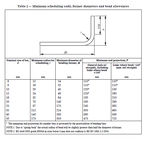

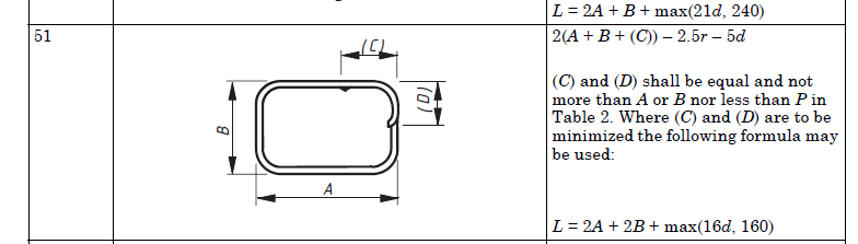

Shape code 51 is this
Table 2 says this
On 17/04/2025 at 18:18, WannabeBob said:
H10 (10mm) links/stirrups with a dimension of 90mm, ie shape code 51 where B=90mm
And there lies your problem.

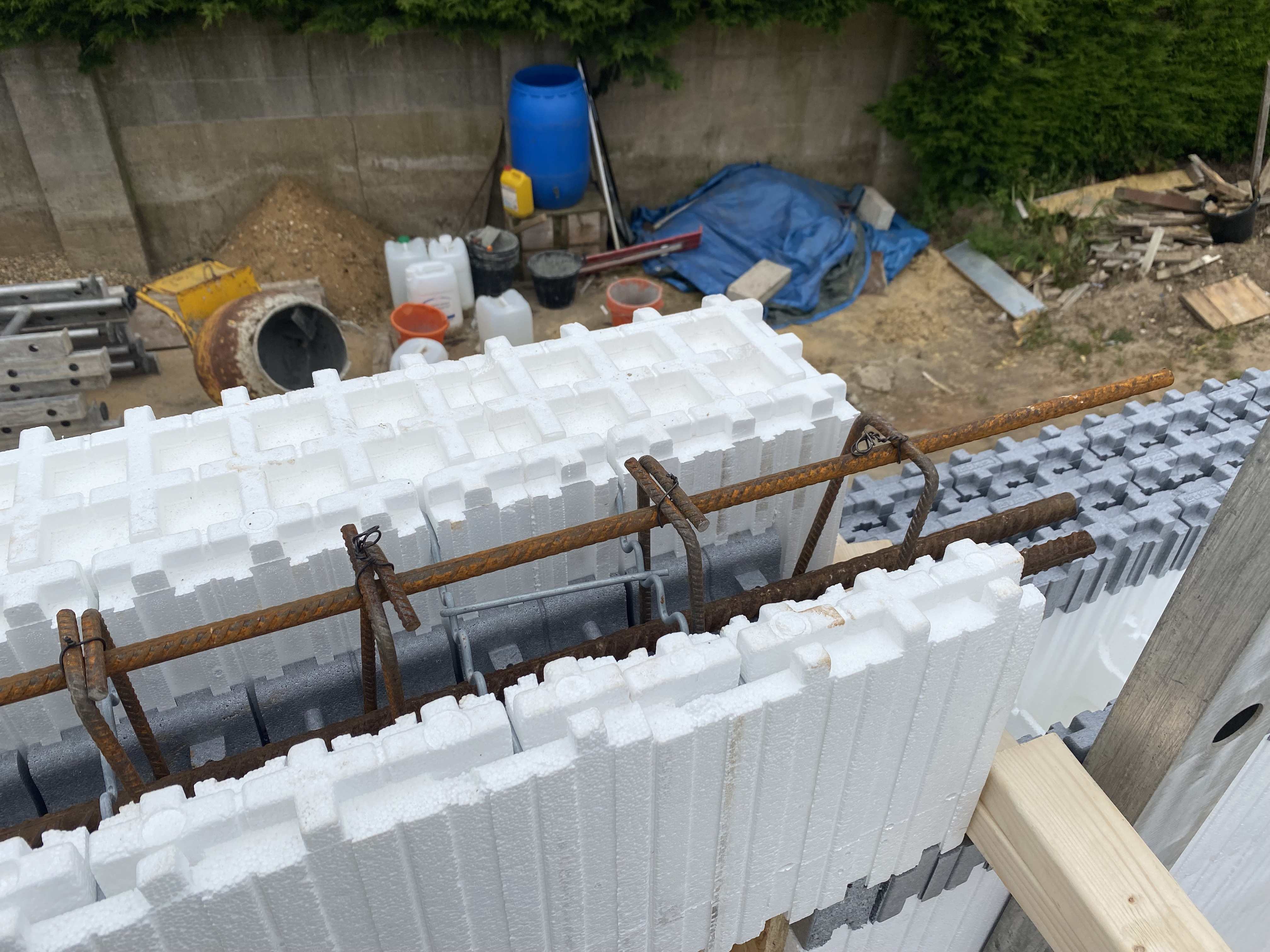

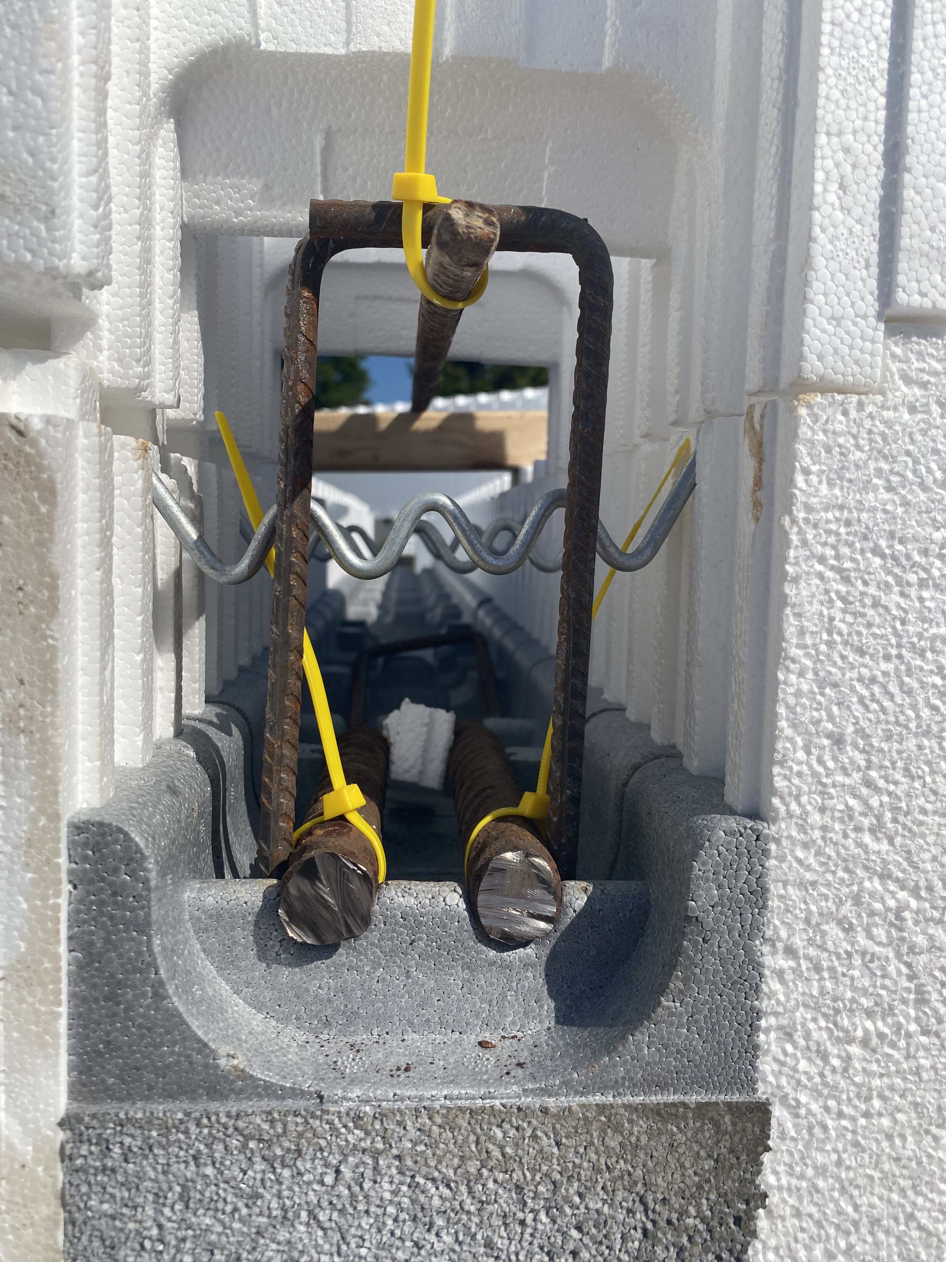

IMG_2271.thumb.jpeg.5aa9ce2aa02cb962141a1b75ee7d1d71.jpegIMG_2255.thumb.jpeg.8ada5dac9834ac57fe04109e7b3fe6ba.jpeg

Good, just make sure that you can vibrate the concrete ok and get the pour sequencing right.
Go back and just check the design with you SE, in case there is an annotation error.. it happens.
Thanks. Yes, we’ve checked the dimensions with them and according to our SE that’s the “standard detail” approved by the ICF manufacturer who’ll come on site to help with the first lift as well.
