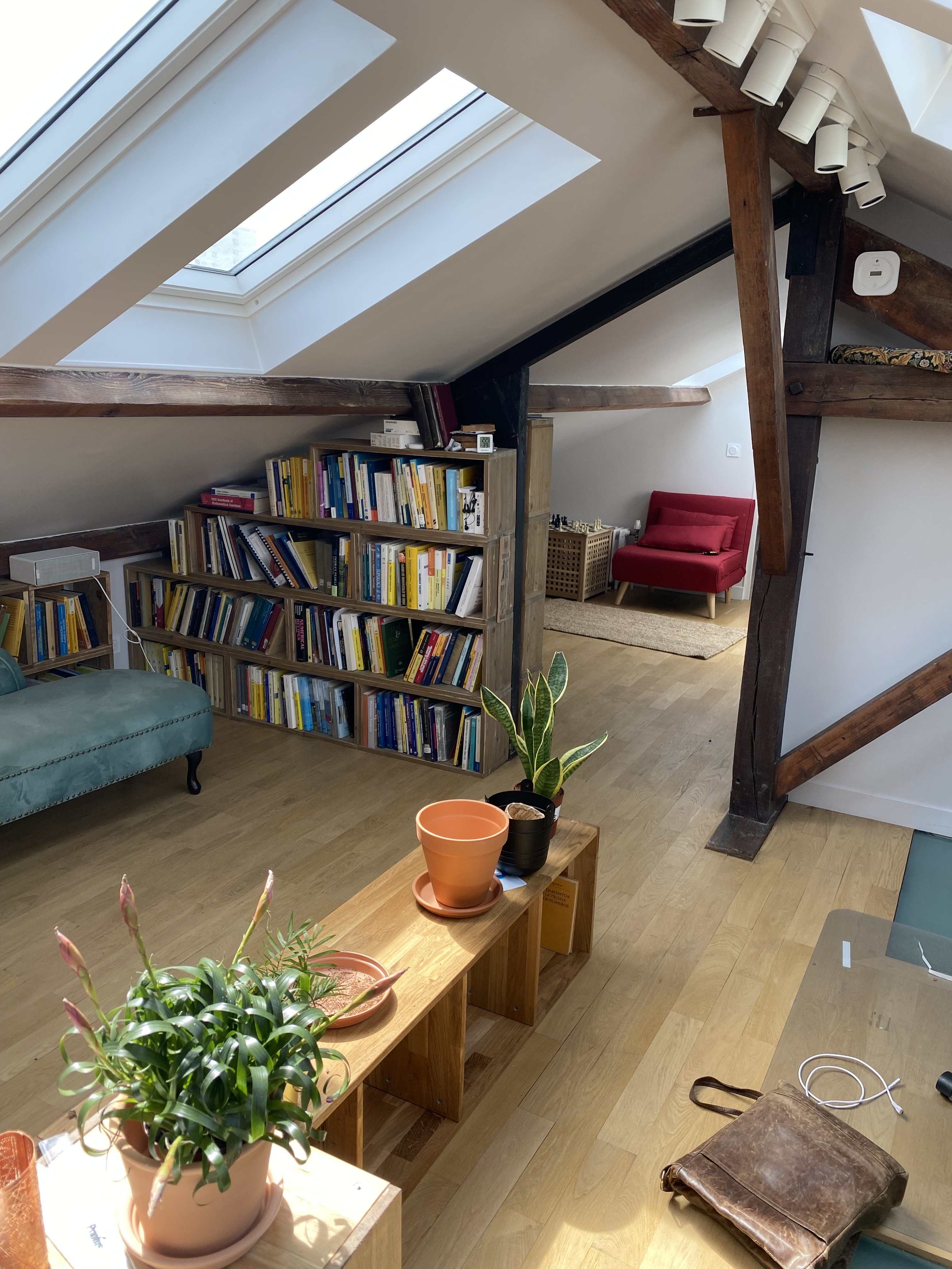

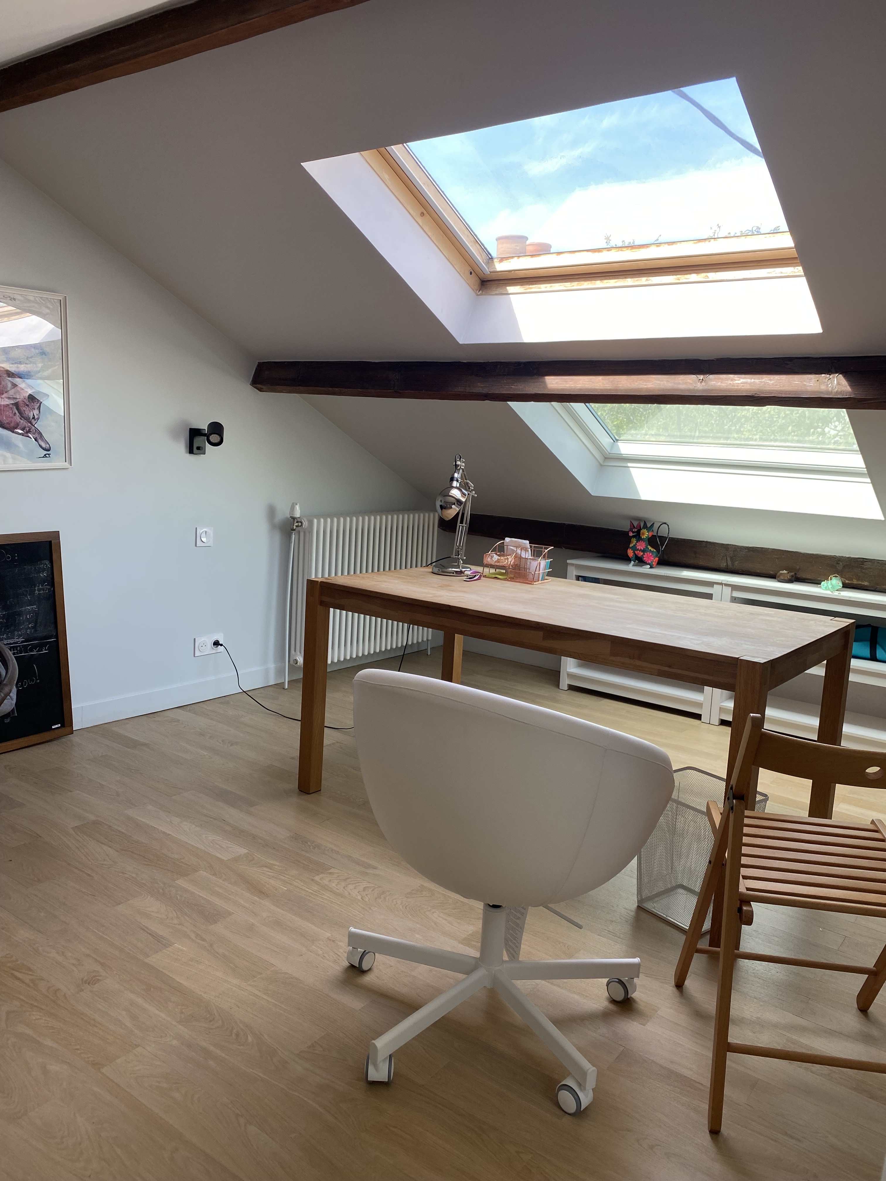

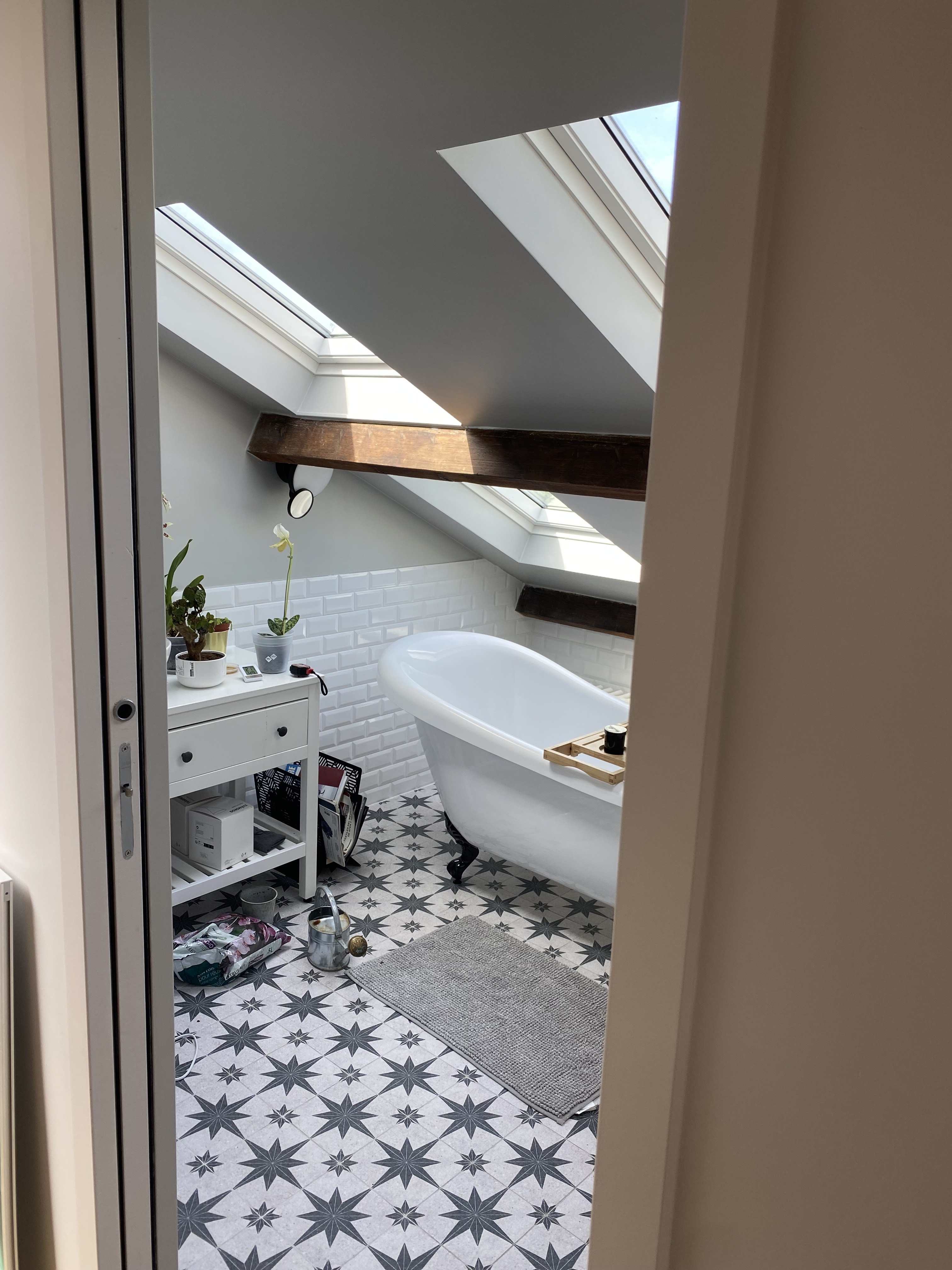

Garald Posted April 12, 2025 Author Posted April 12, 2025 (edited) Let me include a couple of pictures, in part to make clear that this is a fiddly structure that not every builder *wants* to insulate from the inside, and in part so that everybody can see how short I am of headspace as it is. I *could* consider losing a couple of cm in the lower parts (where one can't stand anyhow) just so as to reach R=6 (the magical level for the however rather paltry subsidies). Not in the middle part, however - places where a 180cm-high person can still stand are worth their price in gold (plus, I am 178cm, and I want to hit my head as little as possible). I can of course remove all the furniture myself. The bookshelves are DIY - I can modify them a bit if the ceiling on the lower part needs to be dropped 3cm, say. Edited April 12, 2025 by Garald

Mike Posted April 12, 2025 Posted April 12, 2025 (edited) Based on your constraints, I think that the (insulation) spec is about as good as you'll get. I'm not too shocked by the price either. A few observations: If you're still planning to install MVHR, you can very probably drop the vapour barrier from the spec; the MVHR unit is very likely to keep the moisture below problematic levels. Having said that, it may be difficult to convince the contractor to omit it, as it is required by the French DTU. And ideally you'd want a WUFI analysis to prove it (and obtaining the data for that could be tricky - I may have some next year). However, unless you already have one, I'd add back in an airtight membrane on the outer face of the insulation. That will be fiddly, so will cost more than the vapour barrier would have done (unless you DIY it) Think about a double layer of plasterboard, or at least upgrading the plasterboard to a high-density version, as it will be very exposed to knocks in your situation, and the extra layer will help somewhat with sound insulation. FWIW, my mansard spec isn't too dissimilar : Mento used as an airtight barrier + 100mm Biofib Chanvre + 45mm Biofib Trio + 2 layers of Gypso Omnia (aka Gypso Lignum). Edited April 12, 2025 by Mike
Conor Posted April 12, 2025 Posted April 12, 2025 (edited) Smaller, and triple glazed, roof lights would make a bigger difference than new insulation. It looks like you've some 30-50% glass in those rooms. You could make each one half the size and not make the spaces feel too dark. Cost would be more like €5-7k, and youd properly insulate the reveals. You'll never see the money back on those above quotes. More heating / cooling would be cheaper over a lifetime. I'm assuming the roof lights are of the same generation of the remedial roof works, ~15 years old? Edited April 12, 2025 by Conor
Garald Posted April 12, 2025 Author Posted April 12, 2025 (edited) 29 minutes ago, Conor said: Smaller, and triple glazed, roof lights would make a bigger difference than new insulation. It looks like you've some 30-50% glass in those rooms. You could make each one half the size and not make the spaces feel too dark. Cost would be more like €5-7k, and youd properly insulate the reveals. You'll never see the money back on those above quotes. More heating / cooling would be cheaper over a lifetime. I'm assuming the roof lights are of the same generation of the remedial roof works, ~15 years old? No, all roof lights (except for one) are new, from 2 years ago - double-glazed, not triple glazed, but with good specs (U = 1ish if I remember correctly). That is, half of the roof lights were already there, but I had the windows remplaced entirely. I also put retractable outside shades on all of them (that made a very big difference - as far as summers are concerned obviously). It's not 30-50% glass, it just looks that way (on purpose ). It's about 21% glass. A very pleasant space in mid-season (I'm sitting there right now). Edited April 12, 2025 by Garald 1
