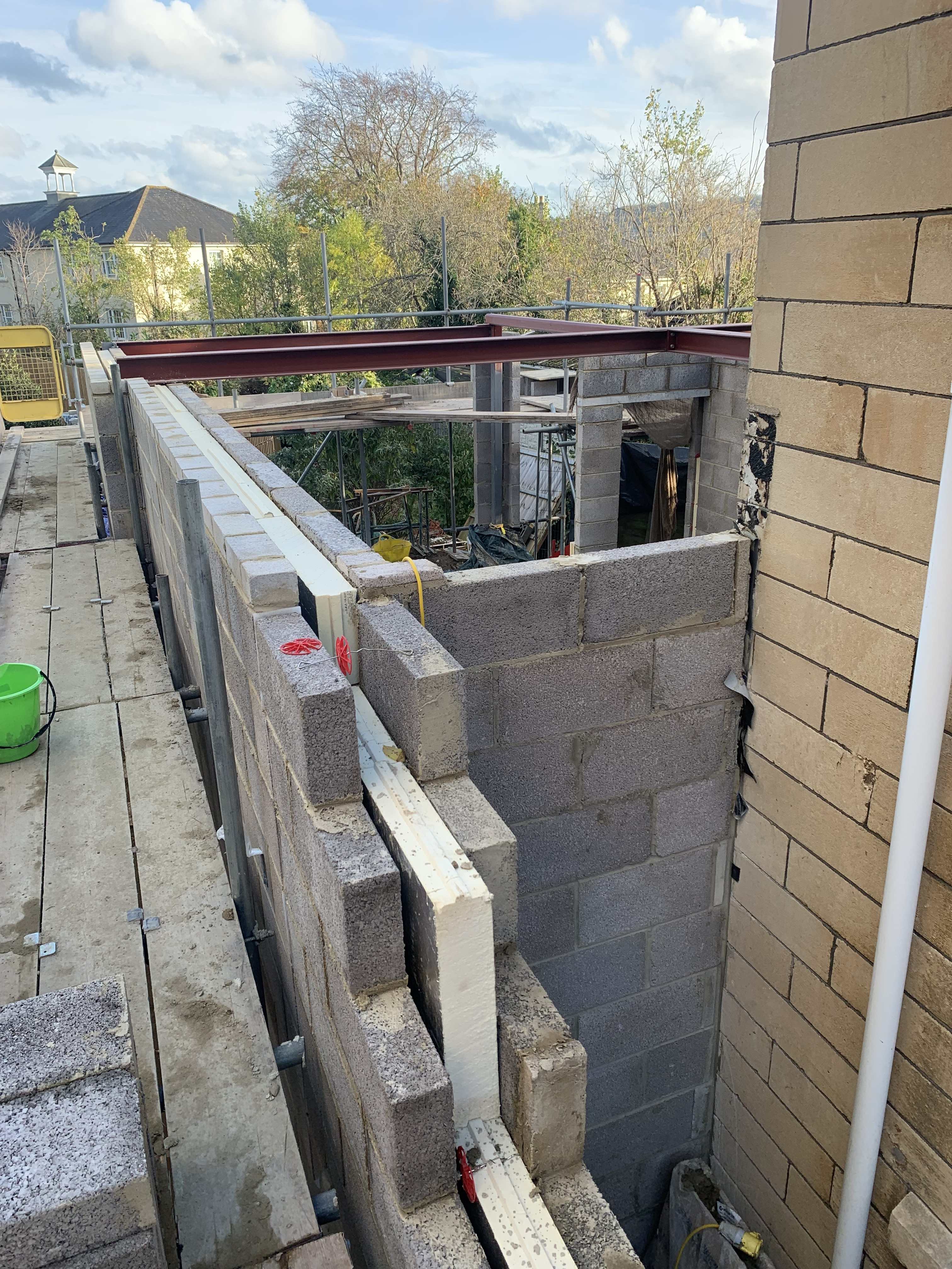

If wall ties are place at a bit of slant so inner leaf blocks are 20mm higher than outer leaf bricks  when the wall ties are placed at 450mm centres and so wall ties slant downwards from the inner block to outer brickwork does this compromise the structural integrity of single storey extension measuring approx 5.8m by 4m?
Essentially is it best to get both inner blocks and outer bricks level so wall ties can be placed level OR is the scenario mentioned above OK as well?

Wall ties are supposed to slope gently towards the outer leaf...
You want any liquid to run towards the outer leaf so you'll be alright. My ties had a double dip in the centre anyways to stop moisture travelling all the way along them and back to the inner, but if they slope down then water isn't going to travel up!
Gently being the keyword.
20mm inside to out exceeds ‘gently’ in my book.
Structurally, they will not be as strong in compression.
In reality, as wall ties will buckle quite easily when compressed, it won't make any difference I suspect.
Probably near enough that same in tension.

My short response is that I never thought of ties working in compression, only in tension.
And yet there has to be a reason for sometimes using twisted flats rather than wire.
Plus I had never heard of putting them on a slope. Any water ingress will be from outside to in, then it drips off the twist or bend and the problem is gone
Structurally I can't see that it matters.

If they are there to 'help' stabilise the wall in very windy weather, then they are most likely dealing with higher air pressure outside than inside, so compression, mainly.
They are probably there for failure mode, than any real contribution to overall structural integrity.

Cavities are commonly insulated with insulation boards like PIR and these seem to be commonly made to interlock at the junctions, and in sizes which seem to correspond to standard block and mortar courses. This then seems to make it more straightforward for wall ties to pass through the insulation boards at the horizontal junctions between boards, and for the wall ties and the board to be readily incorporated into the wall as it is built up. If you have sloping ties then you may have more issues with having to puncture or slit insulation boards to fit around them. Likewise those red circular clip things that commonly attach to wall ties to hold the insulation boards tight to the inner leaf may not fit so well with angled wall ties.
My own naive understanding was that the ties have twists in for the very purpose of preventing water travelling along them anyway.
