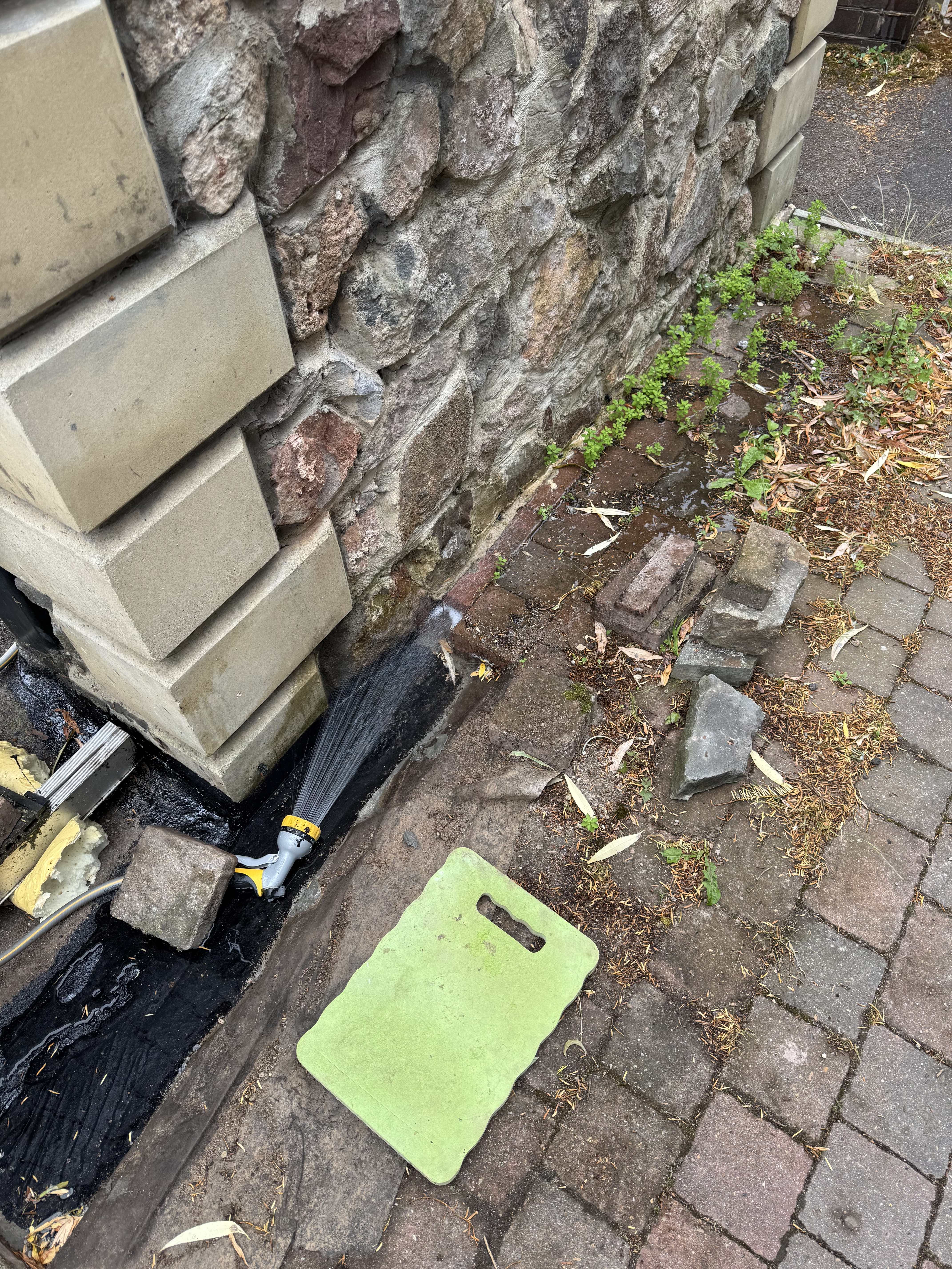

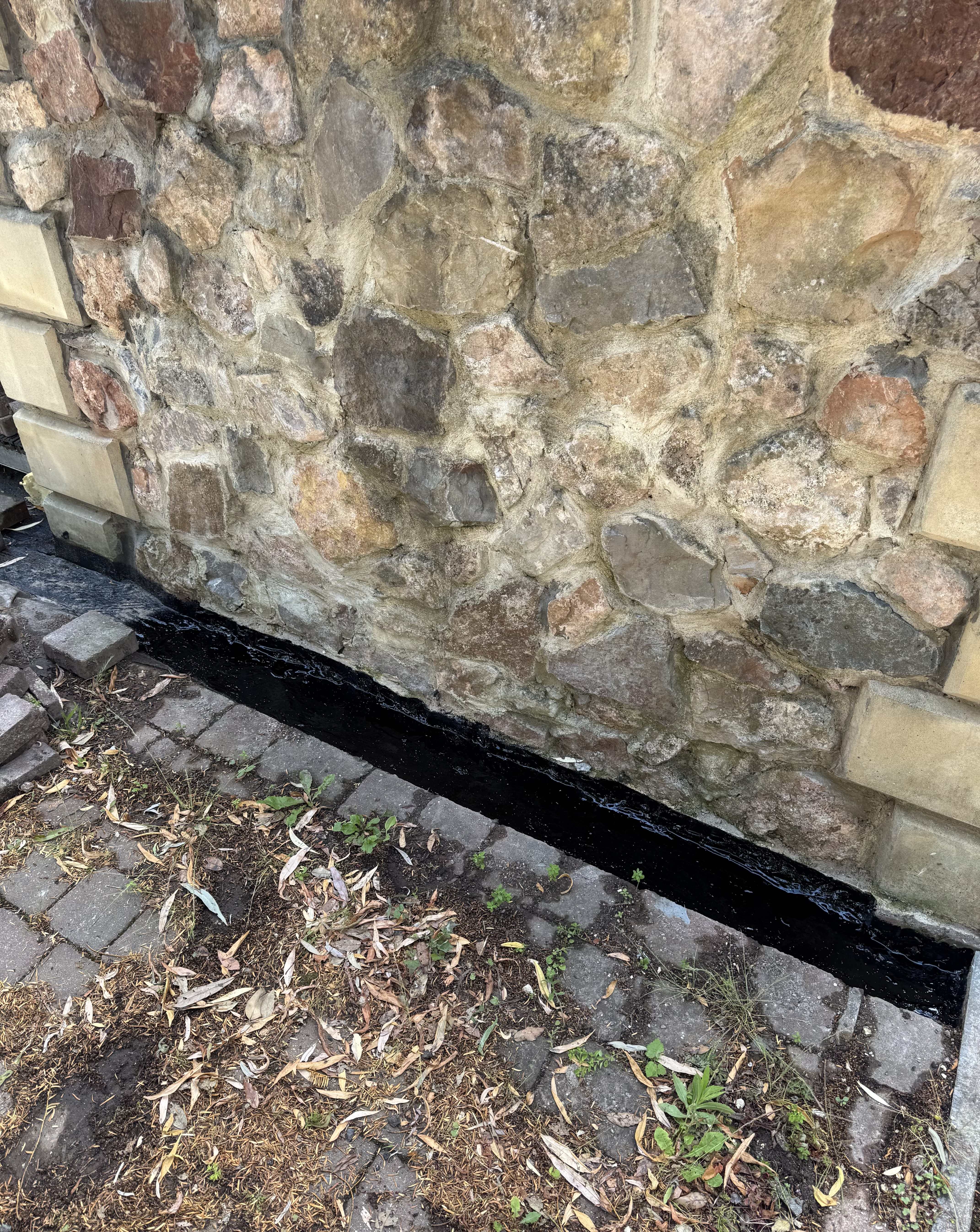

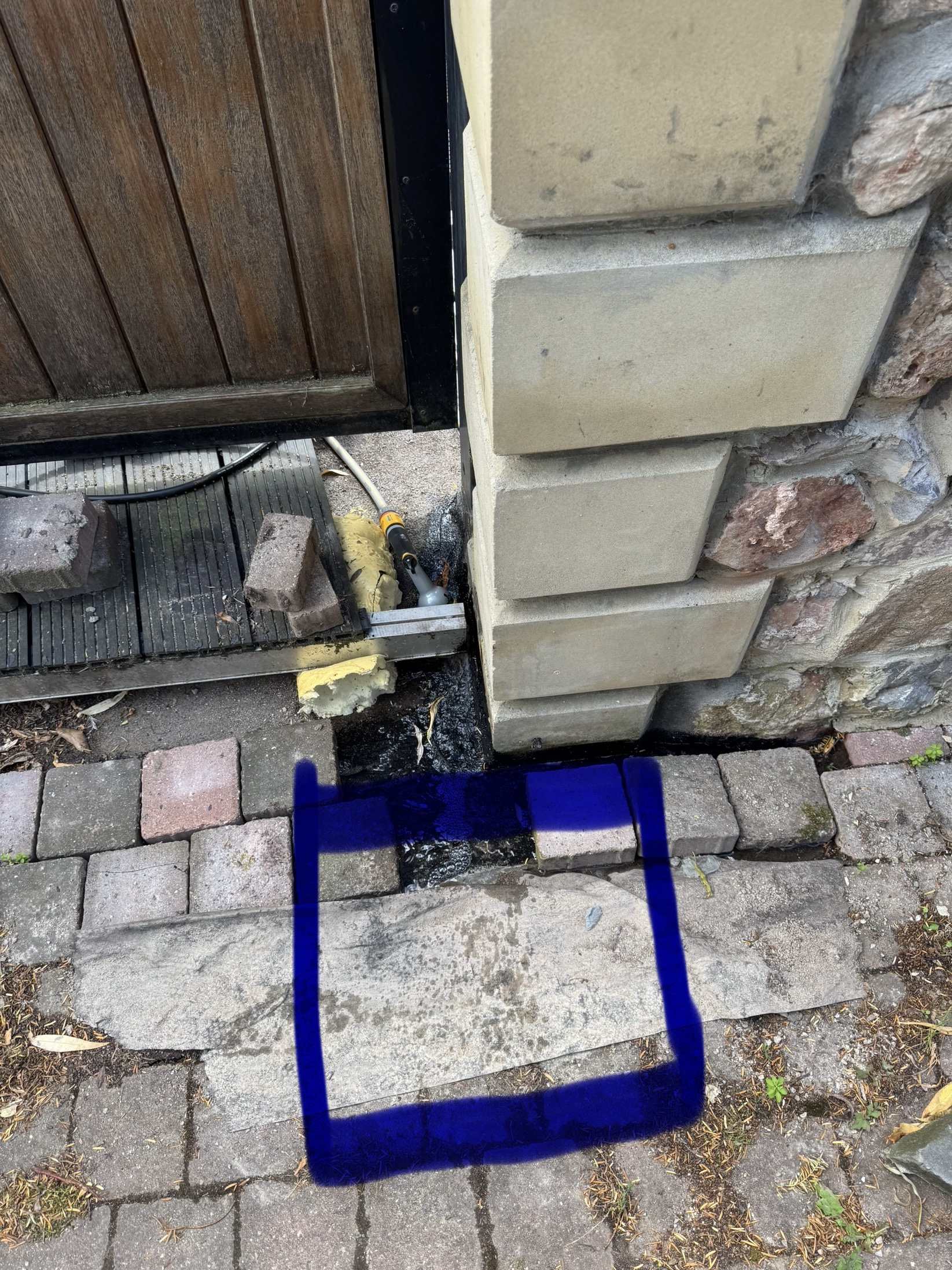

Pocster Posted June 24, 2025 Author Posted June 24, 2025 There was rain last night but I have no idea how much . No obvious leak . My new theory is …. This wall I hosed continually and kept away from the quoin near the gate . No leak . So I assumed wall not an issue . But ! . Water from under the gate run off is lower than the block paving so in theory could run under it ? . Hence hosing to the right - testing that .

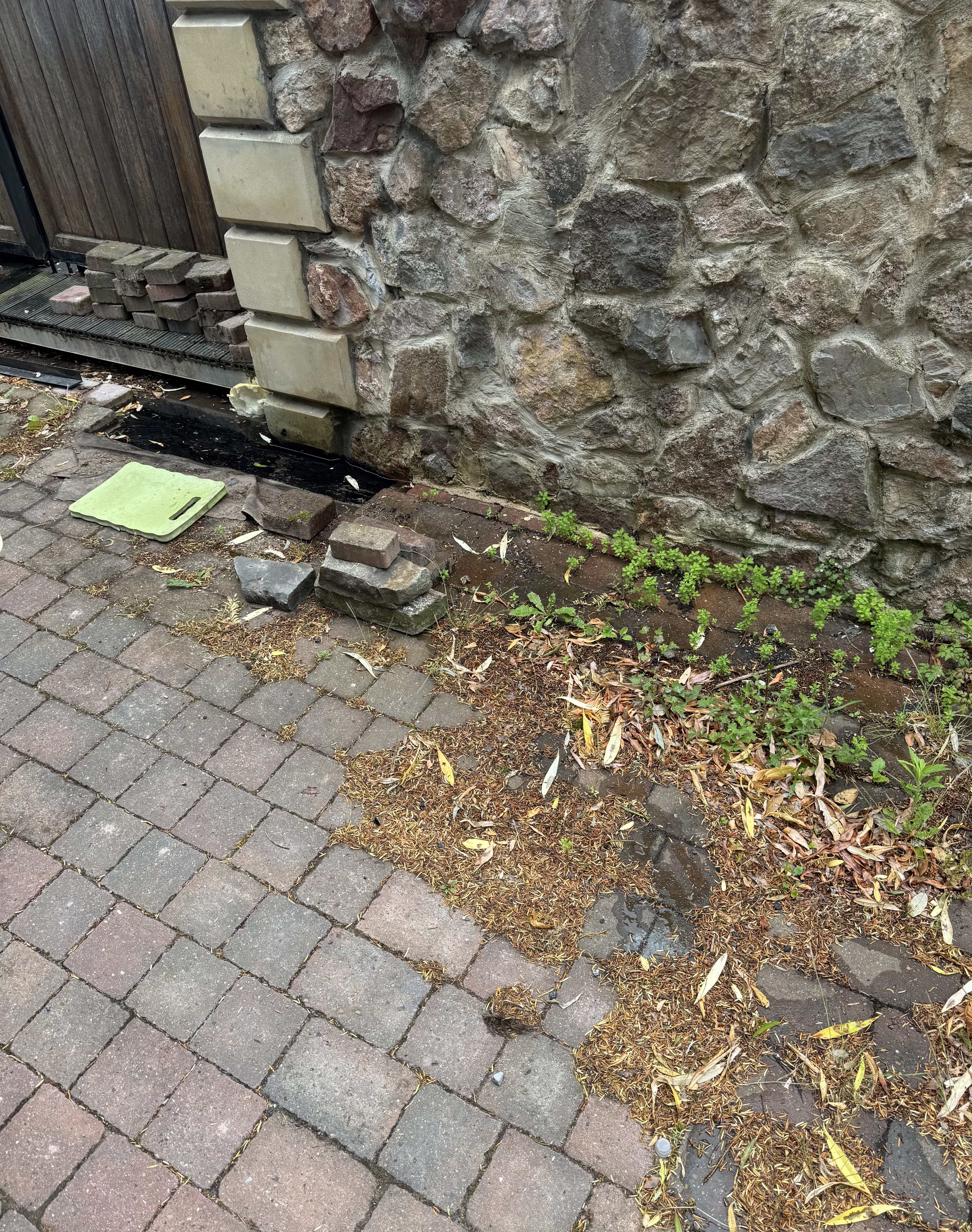

Pocster Posted June 24, 2025 Author Posted June 24, 2025 Ran that for 10 mins . what’s surprising is the little amount of water running over the pavers . It’s all vanished somewhere !!
Pocster Posted June 24, 2025 Author Posted June 24, 2025 Nothing . Not a hint of dampness inside . Though I still need to allow a few hours . Assuming it’s dry there are 2 possibilities… It’s not leaking because the leak isn’t in this area I.e it’s to the left not the right OR <holds breath > the leak is fixed 🤯😲 1

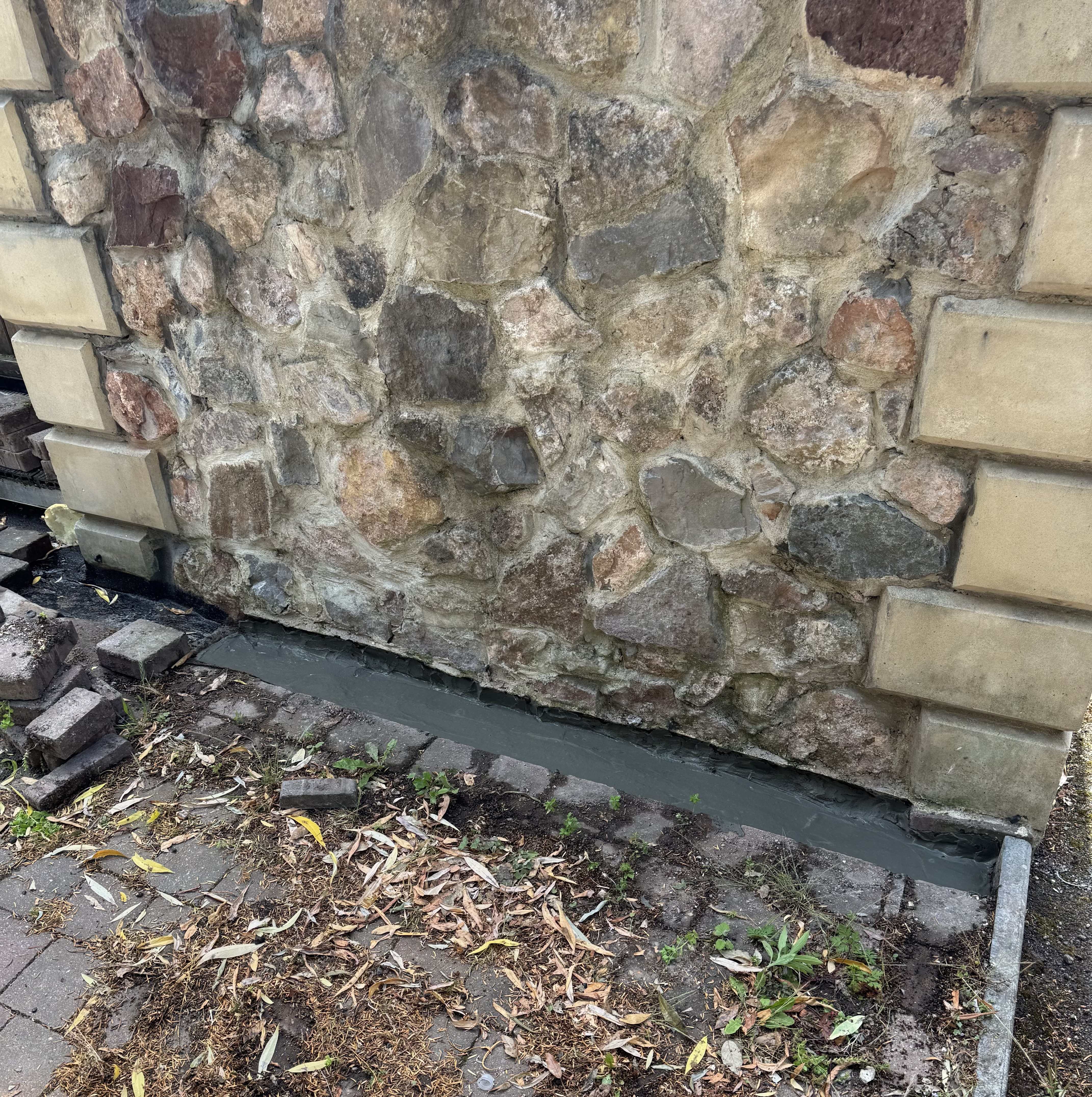

Pocster Posted June 25, 2025 Author Posted June 25, 2025 Possibly a tiny bit coming through … will wait longer . If so will take up the bricks along the rest of that wall , dig out loose ground , concrete and bitumen paint as before . But it’s definitely getting less . I guess what would be helpful is to have that water run off from that corner somehow ‘made’ to go over the block paving …
Pocster Posted June 25, 2025 Author Posted June 25, 2025 For certain tinniest weep comes through . Dig it out concrete that stretch tomorrow 💪👊🏻
Pocster Posted June 25, 2025 Author Posted June 25, 2025 May be fit a manhole cover here ? So literally nothing underneath- just so water can’t pool but will run forward and then when it hits the rest of the block paving will spill over so it can’t ’back up’ . Good plan ? . A plan !!

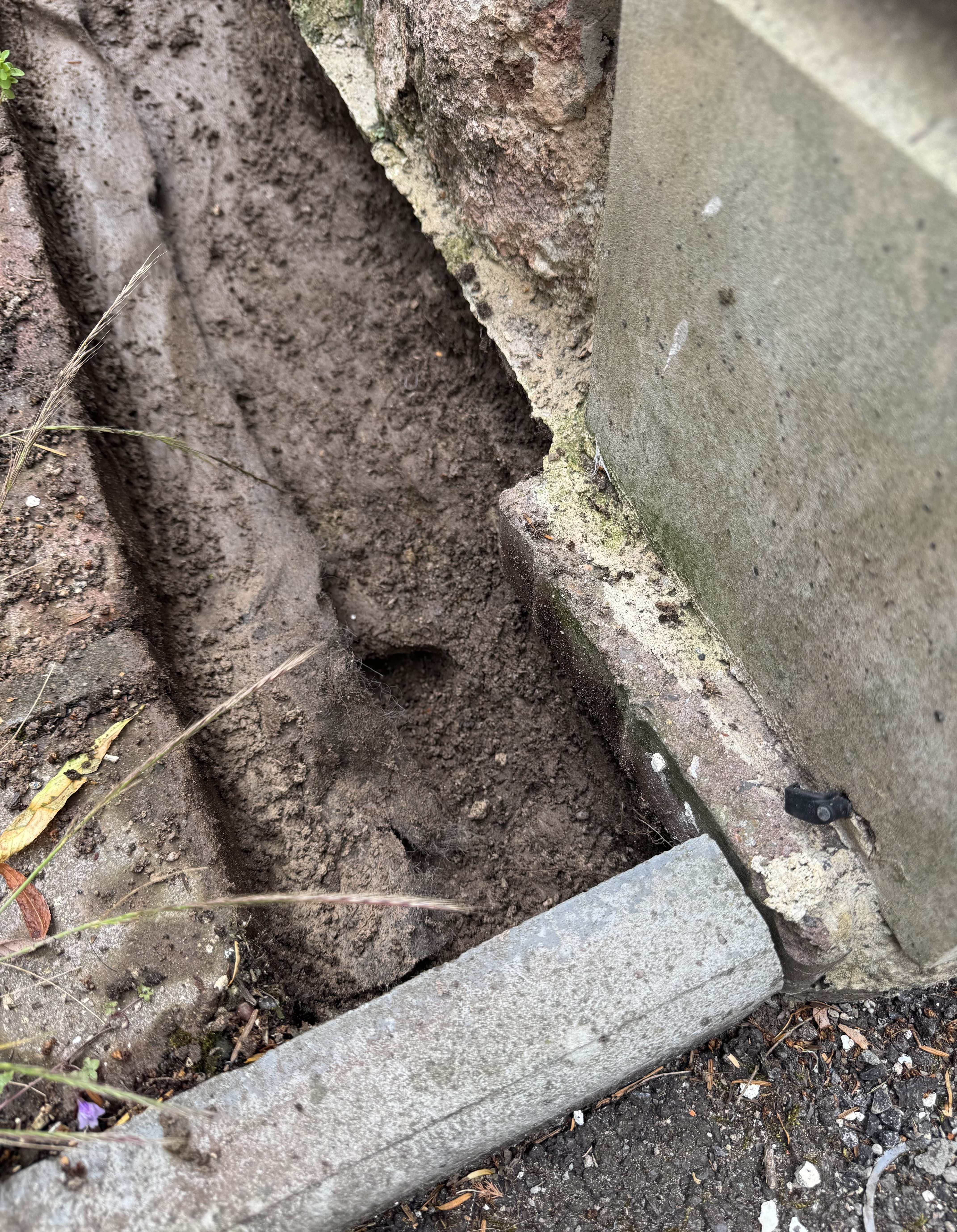

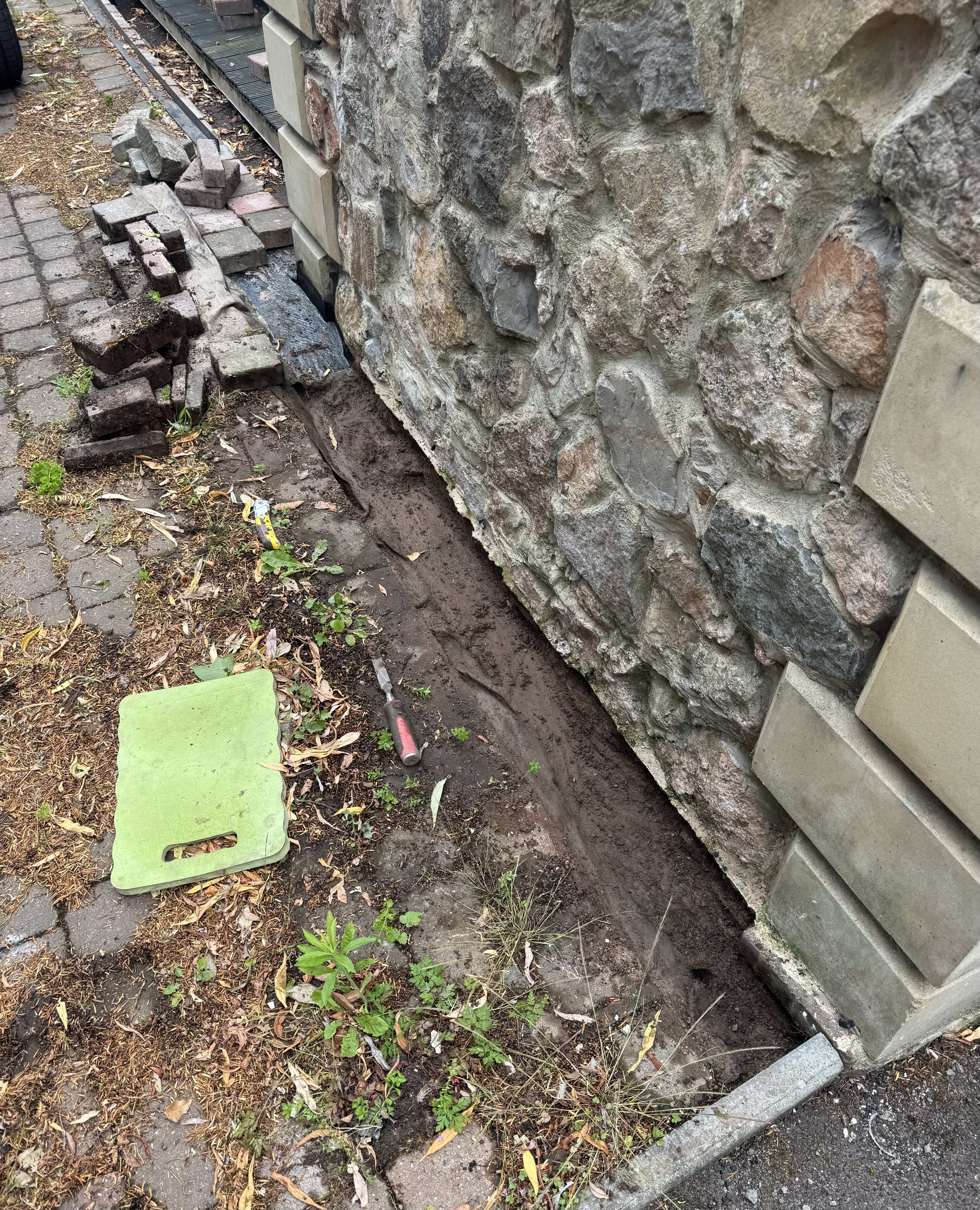

Pocster Posted June 25, 2025 Author Posted June 25, 2025 (edited) Cleared out the rest ready for tomorrow. You know I was amazed how all the water disappeared…. Well , probably because of that mofo hole !!! Edited June 25, 2025 by Pocster

Onoff Posted June 25, 2025 Posted June 25, 2025 4 hours ago, Pocster said: May be fit a manhole cover here ? So literally nothing underneath- just so water can’t pool but will run forward and then when it hits the rest of the block paving will spill over so it can’t ’back up’ . Good plan ? . A plan !! Pooling water will find the weak point. If you can get rid of it, as the low point is "filling up", it can only help. In winter water can expand in a crack making it bigger. 1

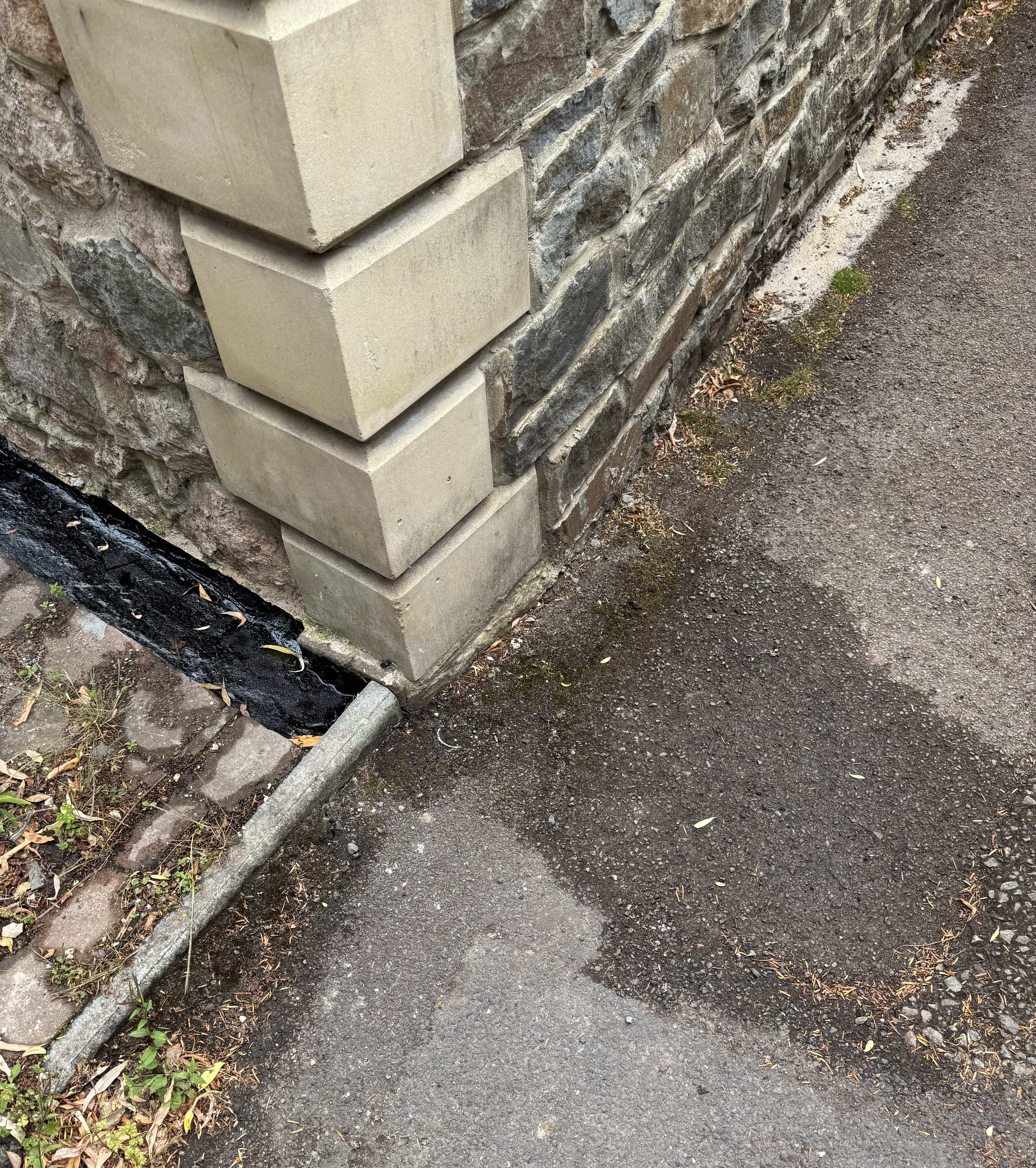

Pocster Posted June 27, 2025 Author Posted June 27, 2025 Leaked after rain last night . I’ll bitumen paint today but I’m not optimistic….
Andehh Posted June 27, 2025 Posted June 27, 2025 (edited) On the brightside , playing with concrete is always good fun! So you did that!!! Edited June 27, 2025 by Andehh 1
Pocster Posted June 27, 2025 Author Posted June 27, 2025 So I bitumen painted it , but am truly sceptical it will fix the issue . Will do a mega soak test tomorrow!!

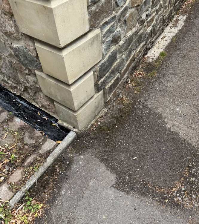

Pocster Posted June 28, 2025 Author Posted June 28, 2025 Flooded it about 2 hours ago ; no sign of leak

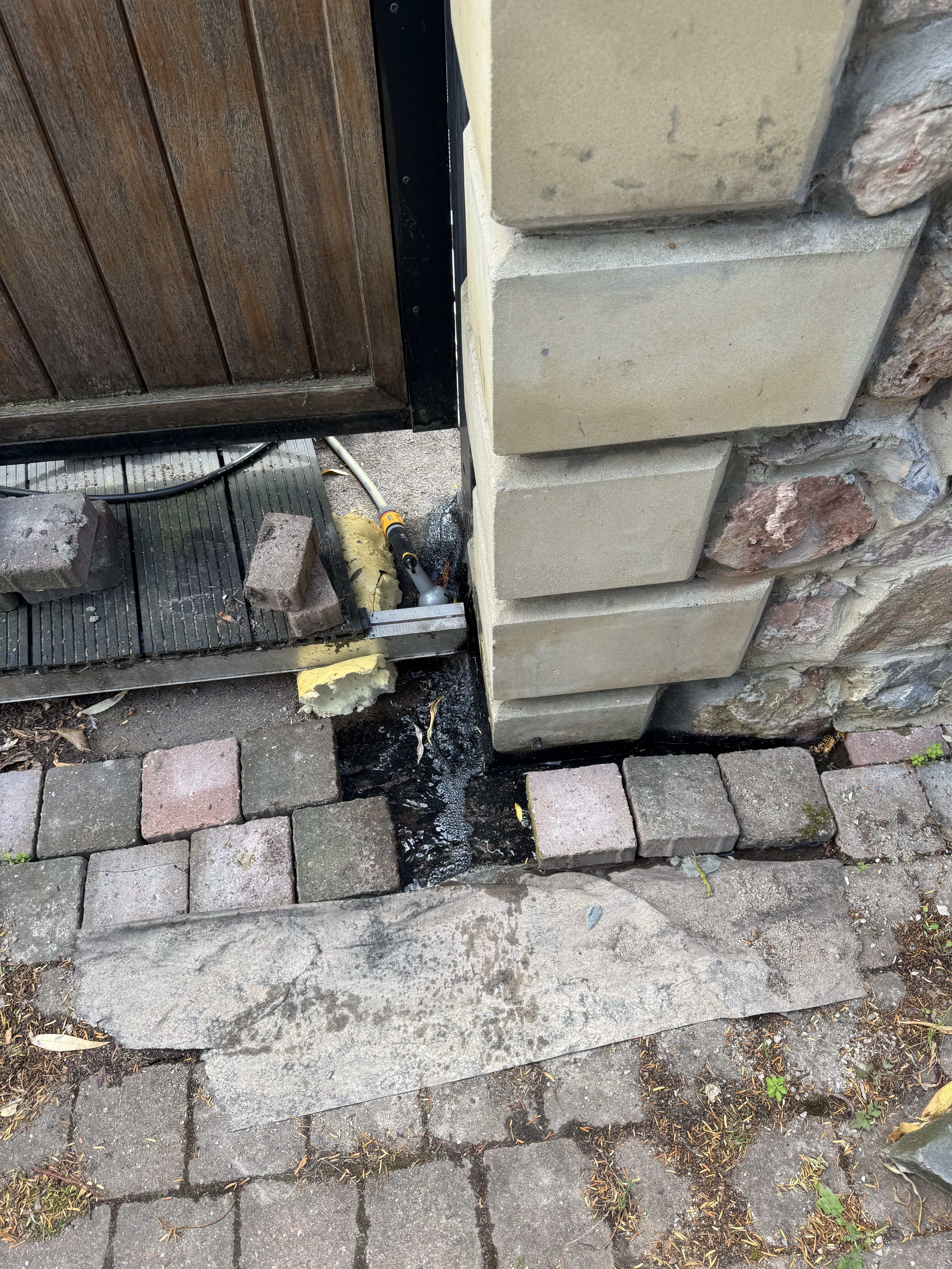

Pocster Posted June 28, 2025 Author Posted June 28, 2025 Typical isn’t it ! Spoke too soon. ! Right going to dig this corner up at the base quoin and concrete it
Pocster Posted June 28, 2025 Author Posted June 28, 2025 Annoyingly one of my first tests was hosing the quoin column for 10 minutes - with no sign of a leak . But I’ll dig up that part in the lane Monday when it’s 30 degrees .
