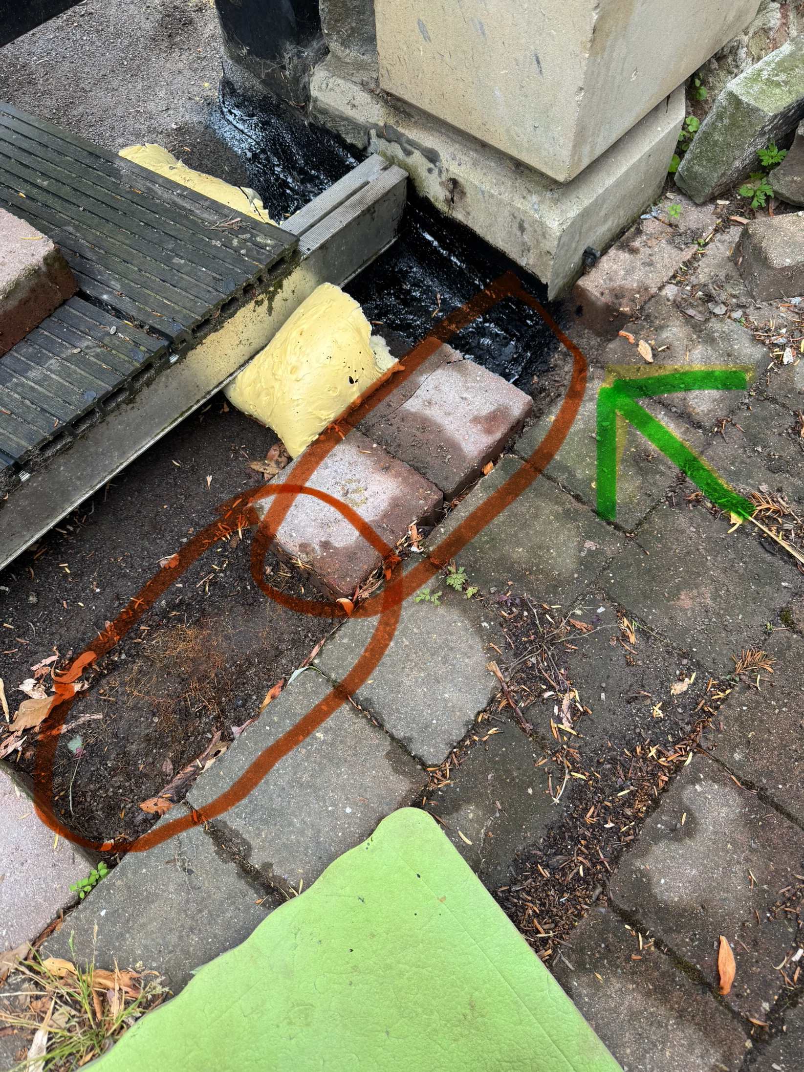

Pocster Posted Saturday at 11:19 Author Posted Saturday at 11:19 (edited) Still leaks but very slight . The issue I think ( guess ) is overflowing that corner I.e the block paving causes the water to pool and run high… Could just remove some blocks and retest … ? Just pour / paste bitumen all over the exposed ground ? It pools at the green area and literally rises to the top of the blocks - so I think it then seaps through the ground and runs under . Edited Saturday at 11:25 by Pocster
Pocster Posted Saturday at 11:31 Author Posted Saturday at 11:31 Dig up the rough ground where the asphalt ends and rough ground begins ( currently pavers ontop ) . Cement with fibres mixed in to stabilise the ground then bitumen paint that and over the asphalt edge ?
Pocster Posted Saturday at 11:34 Author Posted Saturday at 11:34 Think I need to take up a row of pavers . Clean it up so I can see how the asphalt actually ends .

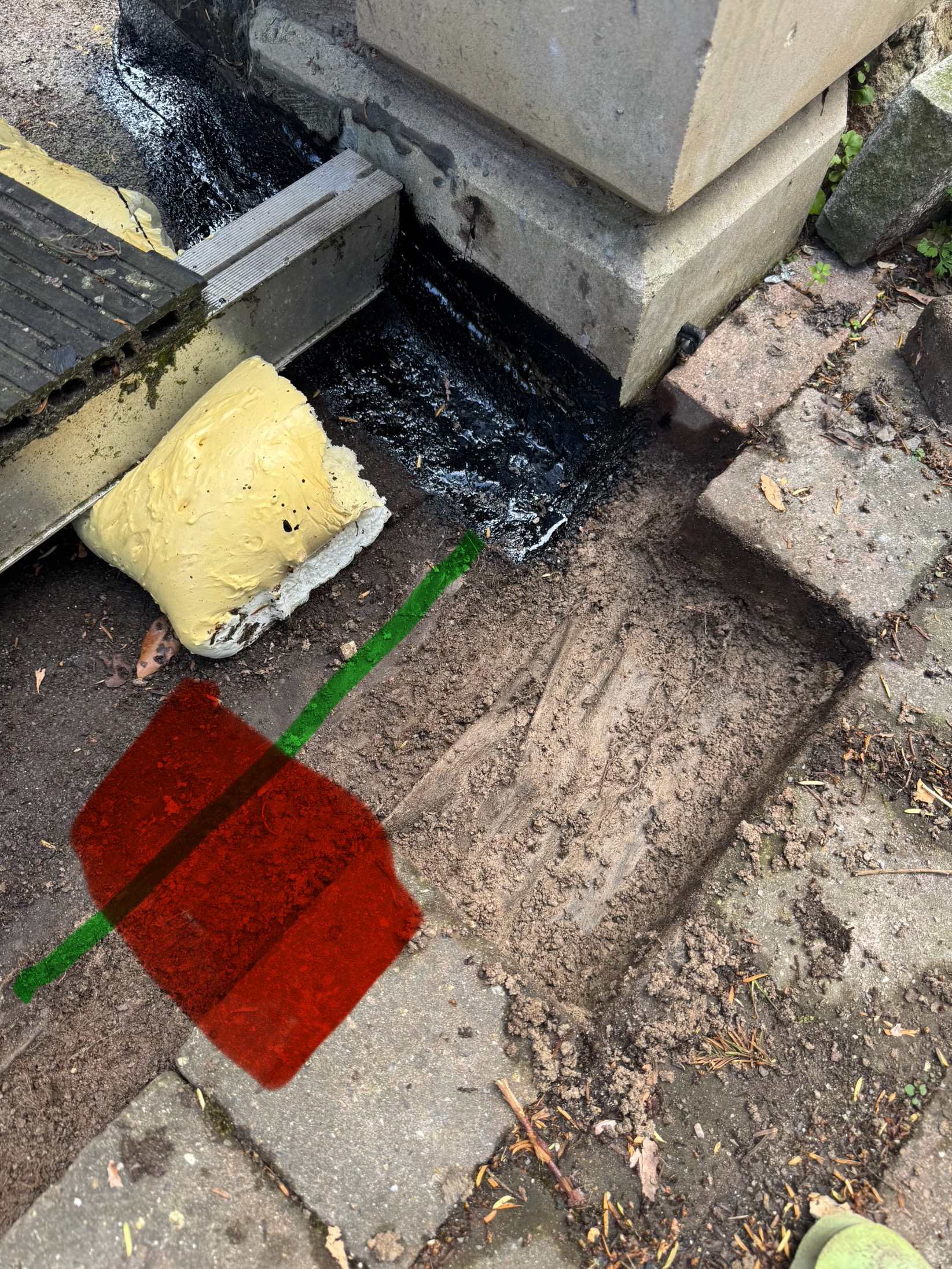

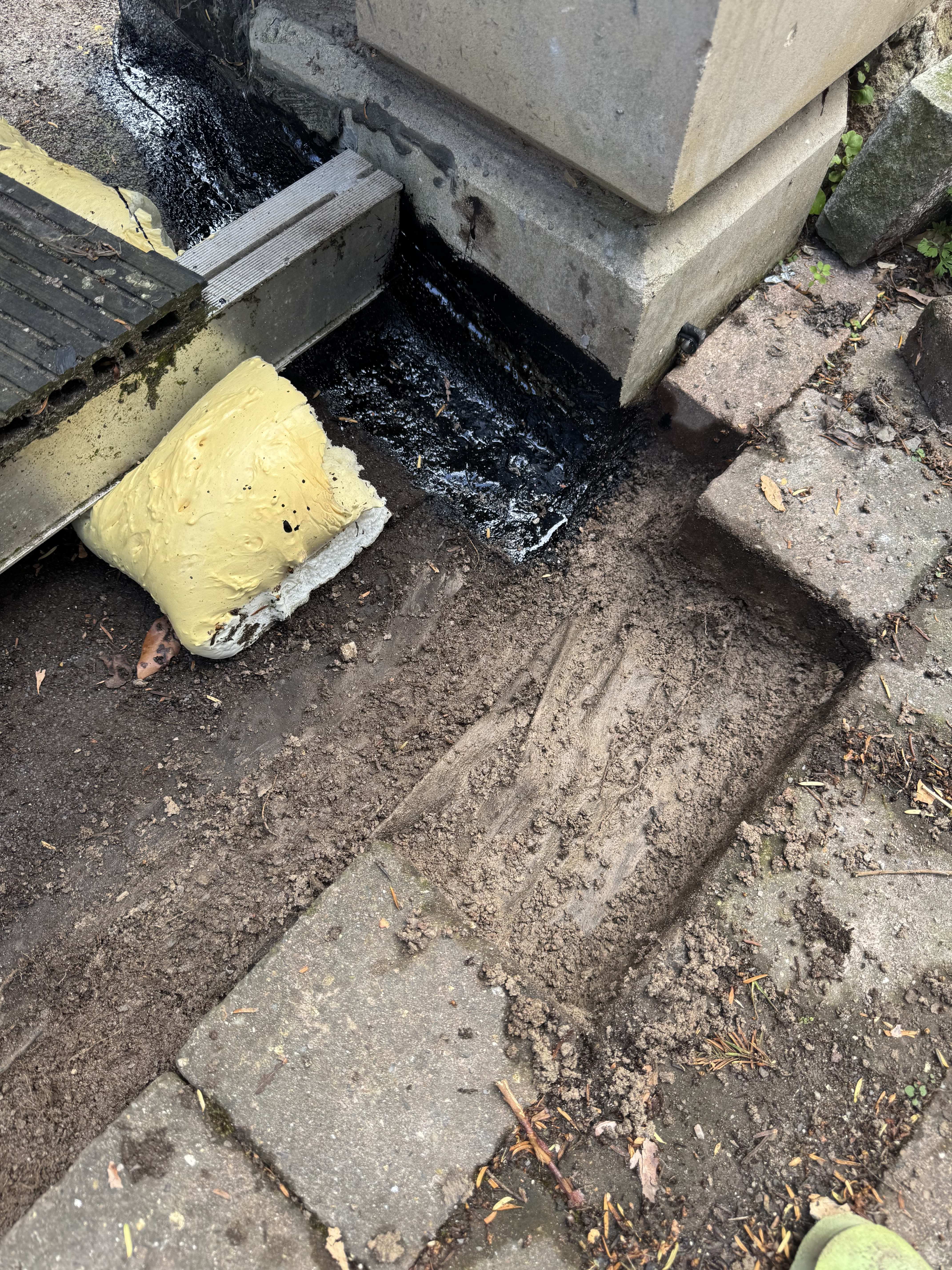

Pocster Posted Saturday at 13:41 Author Posted Saturday at 13:41 (edited) Dug up a bit . So there’s some membrane under the pavers . Perhaps when it floods it runs under that and back ? Just concrete over the edge of the asphalt and membrane - then bitumen paint the lot ? I can’t just bitumen paint this as is can I ?? Liquid rubber ? So up over the asphalt to meet the bitumen . Over that small bit of rough ground , then over the edge of the membrane … ? Edited Saturday at 13:52 by Pocster What to do !

Onoff Posted Saturday at 14:28 Posted Saturday at 14:28 So you have proper, traditional, hot laid asphalt? Anything else is not asphalt. Atop that a membrane then sand bedded pavers? Looks like green mineral roofing felt in earlier pics with all the nasty associated joints, laps, folds and seams. Pay particular attention where it laps up any walls etc. Hot laid asphalt is great and forms a homogenous layer even on upstands where you incorporate fillets. Until of course it cracks. I'd assume the flat areas are ok and focus on the bold highlighted bits.
Pocster Posted Saturday at 15:05 Author Posted Saturday at 15:05 (edited) 36 minutes ago, Onoff said: So you have proper, traditional, hot laid asphalt? Anything else is not asphalt. Atop that a membrane then sand bedded pavers? Looks like green mineral roofing felt in earlier pics with all the nasty associated joints, laps, folds and seams. Pay particular attention where it laps up any walls etc. Hot laid asphalt is great and forms a homogenous layer even on upstands where you incorporate fillets. Until of course it cracks. I'd assume the flat areas are ok and focus on the bold highlighted bits. Where the asphalt ends - then rough ground , then the compacted ground ; membrane ontop and pavers . So that liquid rubber over the lot ? Effectively ( hopefully ) forming a waterproof barrier from rain going over asphalt then over the rubber off onto the membrane under the pavers I.e water will run away at that point Edited Saturday at 15:05 by Pocster

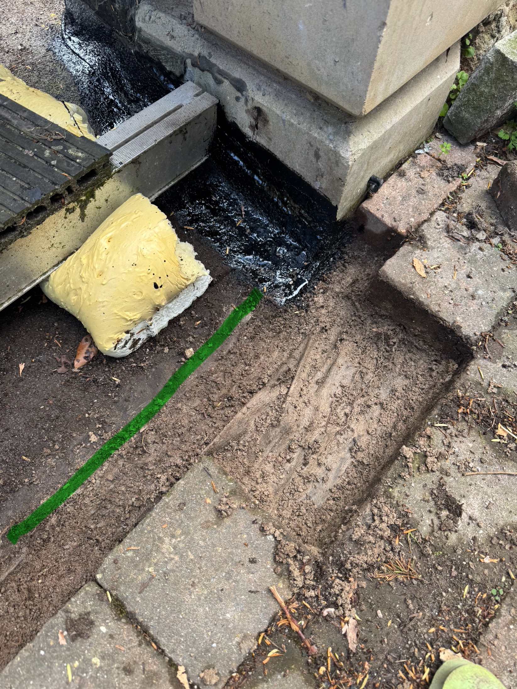

Pocster Posted Saturday at 15:13 Author Posted Saturday at 15:13 (edited) So the asphalt ends at the green line , rough ( but compressed ) ground ( probably mot1 ) - so that runs under the membrane . So just liquid rubber running from a few inches up the asphalt to a few inches over the membrane . In essence the red bit is liquid rubber done all the way along covering all the different materials . That a plan. ? Edited Saturday at 15:15 by Pocster

Pocster Posted Saturday at 16:34 Author Posted Saturday at 16:34 Think what I might do is cut back the membrane for the 1st row of pavers . Dig it out , put concrete in . Then bitumen from asphalt over that .
Onoff Posted Saturday at 17:02 Posted Saturday at 17:02 The liquid rubber will stick to both substrates and hopefully allow a flexible joint. The surfaces want to be clean as in vacuum job I would and maybe a wash / dry beforehand.
Pocster Posted Saturday at 17:05 Author Posted Saturday at 17:05 2 minutes ago, Onoff said: The liquid rubber will stick to both substrates and hopefully allow a flexible joint. The surfaces want to be clean as in vacuum job I would and maybe a wash / dry beforehand. But what about the compressed loose ground between them ? . Remove replace with concrete or just (expletive deleted) liquid rubber over that also ?

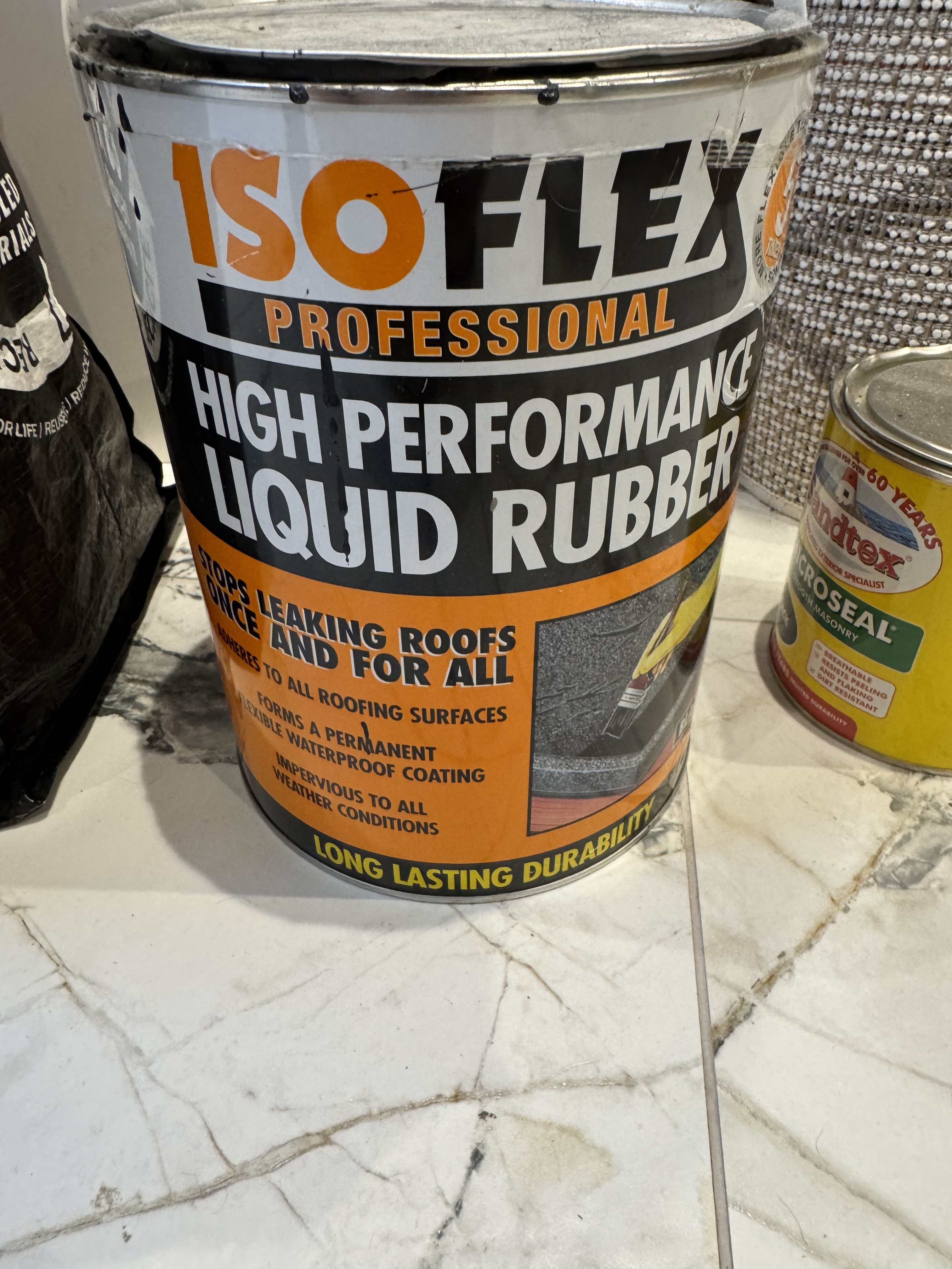

Pocster Posted Saturday at 17:20 Author Posted Saturday at 17:20 Forgot I’ve got some of this It’s the rough ground an issue - but it’s unlikely to move - just (expletive deleted) this over the lot ( professionally speaking )
Onoff Posted Saturday at 17:30 Posted Saturday at 17:30 It says for professional use. You need to take it back. 1
Onoff Posted Saturday at 17:31 Posted Saturday at 17:31 A rough substrate is no issue. More so if it's loose and bitty.
Pocster Posted Saturday at 17:50 Author Posted Saturday at 17:50 18 minutes ago, Onoff said: Was is this "rough ground" made of? Compacted mot1 I think
