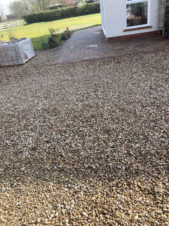

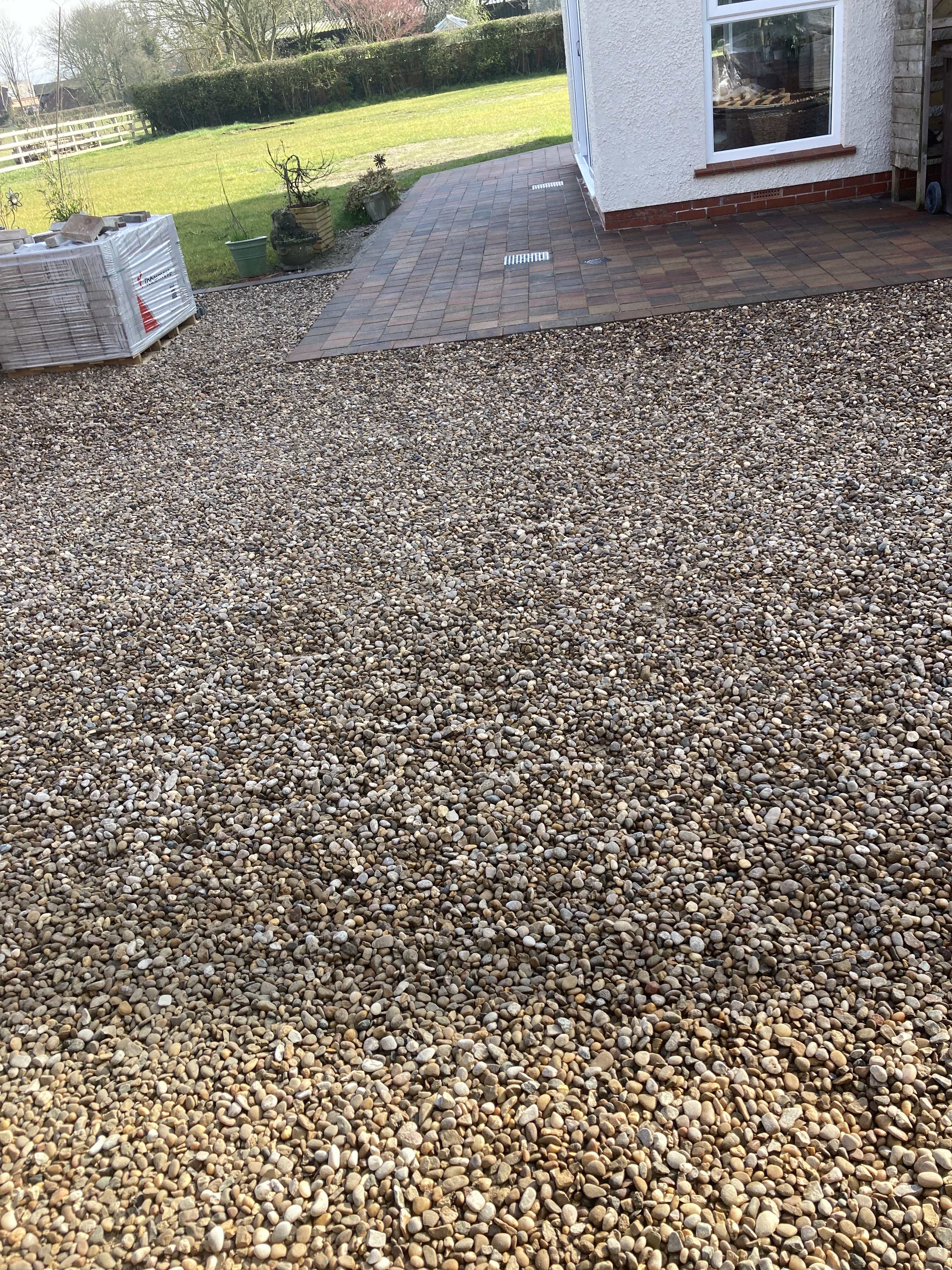

nod Posted March 22, 2025 Posted March 22, 2025 Tarmac around where we are tends to be 50m2 and that with all the prep work done fore them Sun base drains etc We are using block pavers again 550m2 Ouch plus a 100m2 in front of the garage in gravel Which I’m regretting already Horrible to drive on and worse to walk on A ready reckoner for anyone buying gravel I bought 20 ton for a 100 m2 12 ton would have been enough The other 8 had to be dumped in the field
SBMS Posted March 22, 2025 Posted March 22, 2025 1 hour ago, nod said: Tarmac around where we are tends to be 50m2 and that with all the prep work done fore them Sun base drains etc We are using block pavers again 550m2 Ouch plus a 100m2 in front of the garage in gravel Which I’m regretting already Horrible to drive on and worse to walk on A ready reckoner for anyone buying gravel I bought 20 ton for a 100 m2 12 ton would have been enough The other 8 had to be dumped in the field We are still debating what drive surface to use. We’ve got a lot to cover as well - resin far too expensive. What’s up with gravel? Did you put crates down?

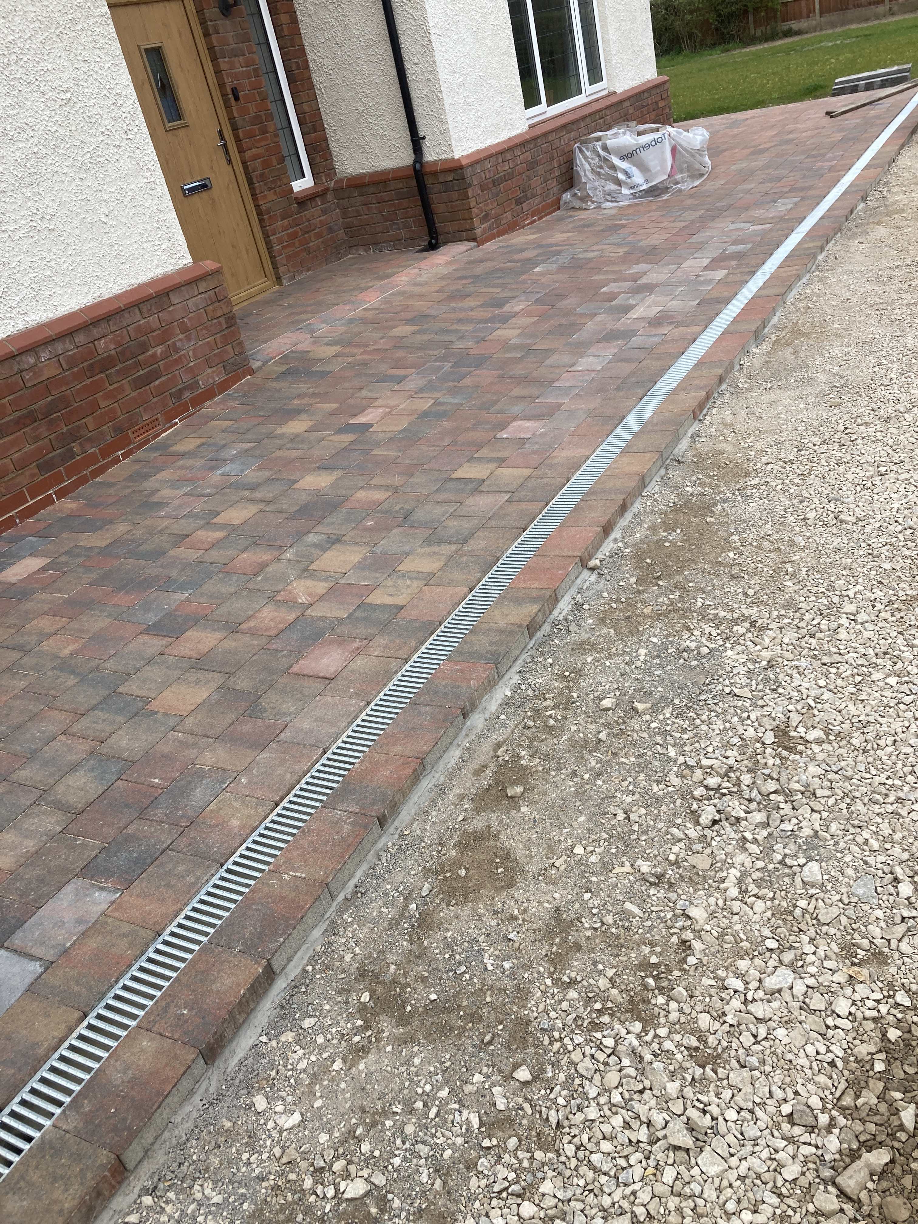

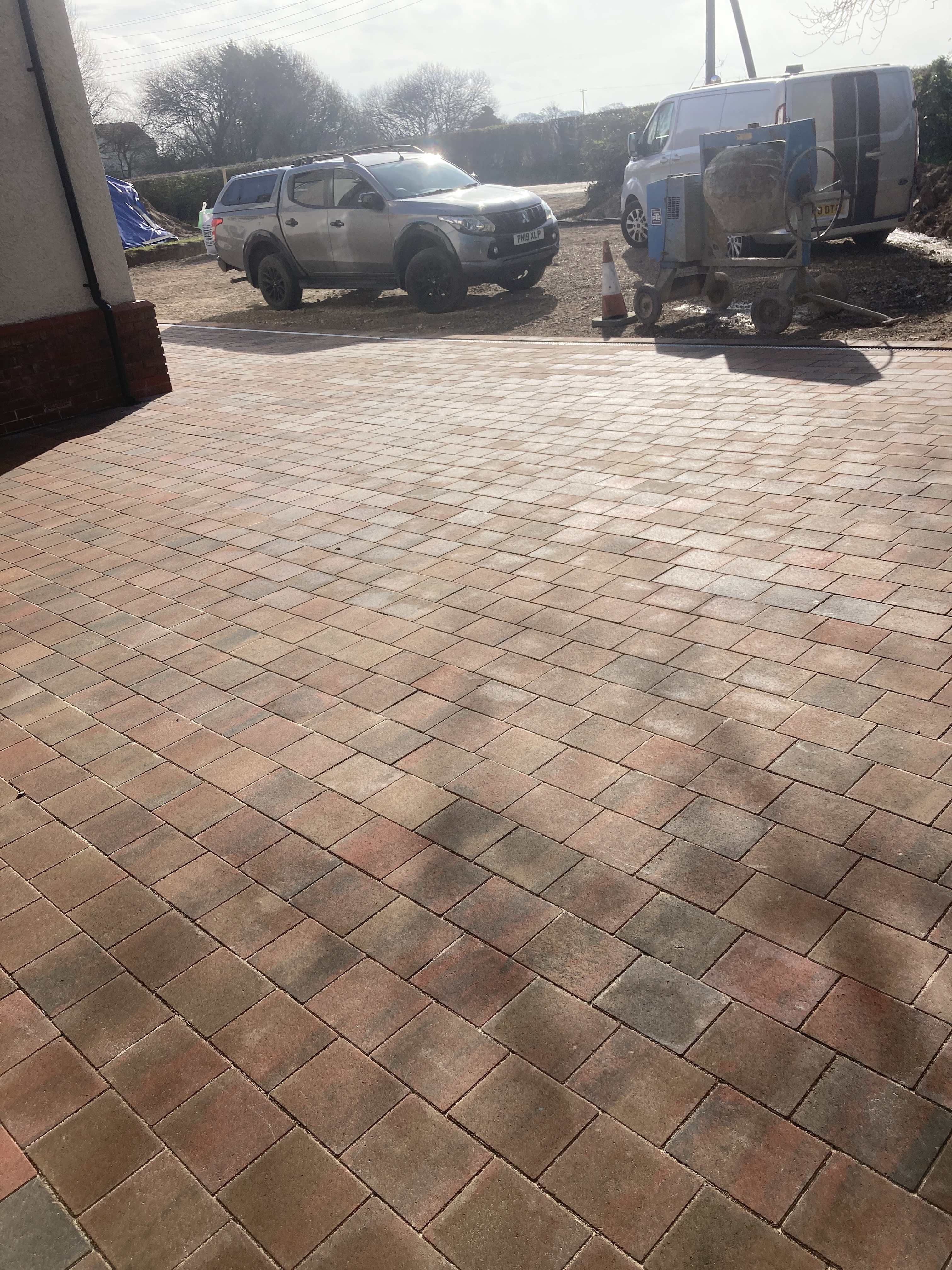

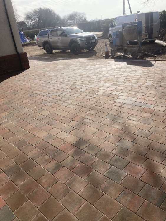

nod Posted March 22, 2025 Posted March 22, 2025 40 minutes ago, SBMS said: We are still debating what drive surface to use. We’ve got a lot to cover as well - resin far too expensive. What’s up with gravel? Did you put crates down? No We probably should have put crates down But that brings it up to the price of Tobermore paving As I stated Gravel is bad to walk and drive on Better with crates Tobermore is costing 16m2 plus sand
SBMS Posted March 22, 2025 Posted March 22, 2025 (edited) 5 hours ago, nod said: No We probably should have put crates down But that brings it up to the price of Tobermore paving As I stated Gravel is bad to walk and drive on Better with crates Tobermore is costing 16m2 plus sand Looks nice. You laying it yourself? Where did you get the tobermore from? Edited March 22, 2025 by SBMS
nod Posted March 22, 2025 Posted March 22, 2025 7 hours ago, nod said: No We probably should have put crates down But that brings it up to the price of Tobermore paving As I stated Gravel is bad to walk and drive on Better with crates Tobermore is costing 16m2 plus sand yes laying ourselves As I type 😂 CW Berry But Buildbase {Hews Grew)) where about the same
