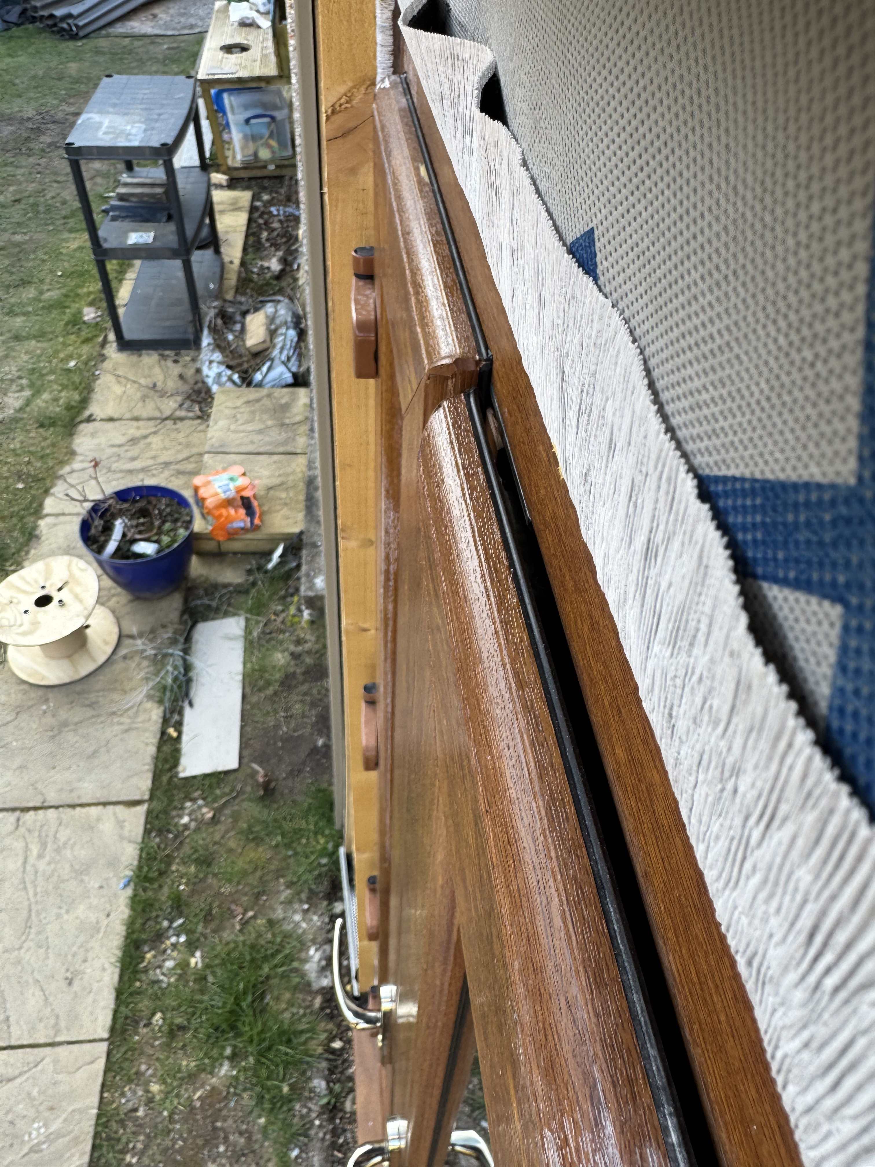

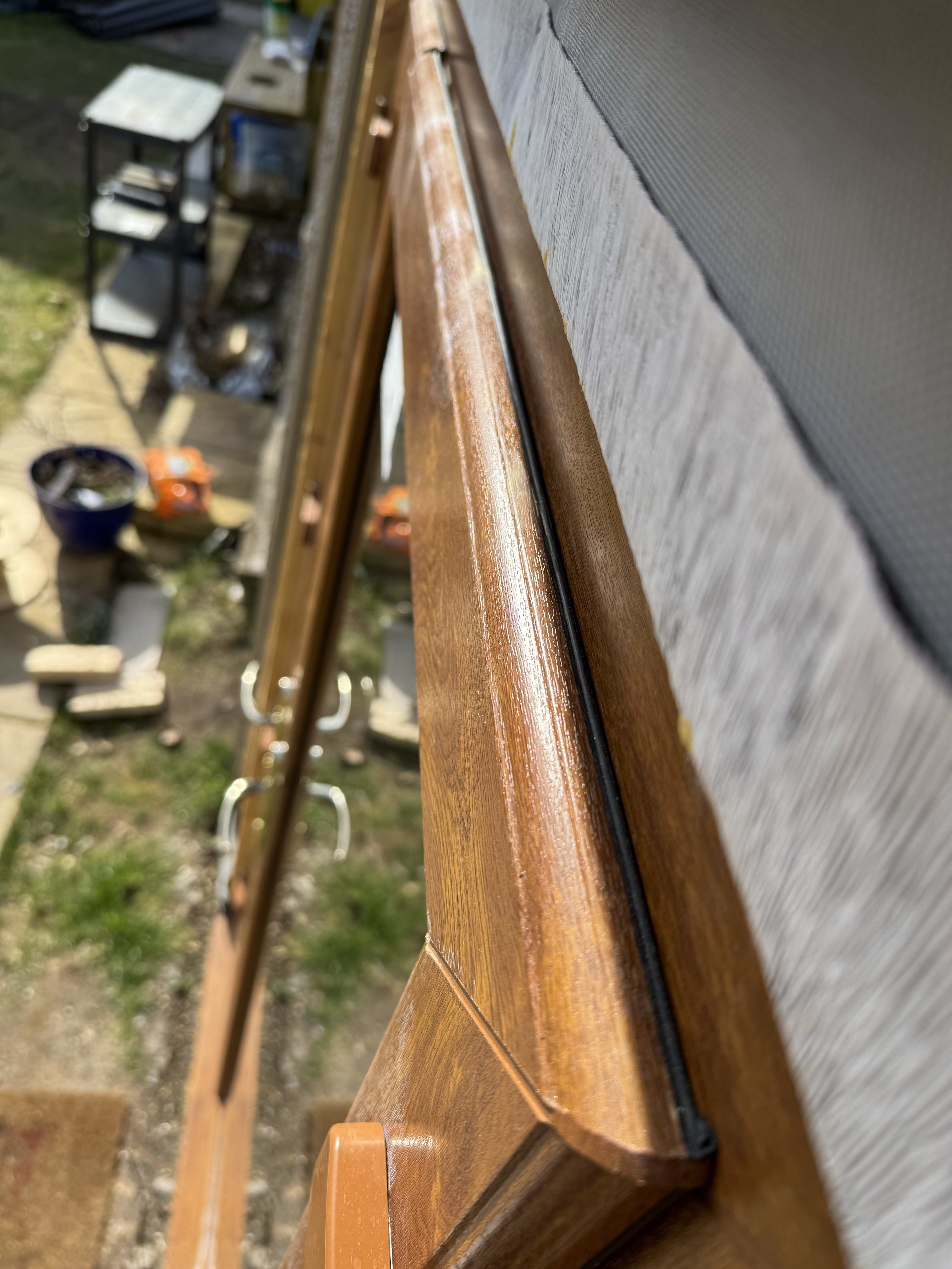

plockhart Posted March 20, 2025 Posted March 20, 2025 I had a french door installed and it feels rough to use. Unfortunately I cannot get the cowboy to come back and correct it because he is married to my wife. The french door was installed a while back and evidently I didn't do a good job at all. I'm coming back to it to try and improve it. When I close the door the bottom of it comes into contact with the frame (the smaller side of the french door) but the top does not and is out by ~10mm. To engage the locking mechanism I have to push on the top half of the door to bring it flush and then everything locks. It is not smooth usage. When I fitted it, it was felt like this and a bit rough to use. `good enough` as I was under a time pressure, so after it was like this I toe+heeled it and pressed on with the rest of the project. Now I'm mostly done I have come back to annoying jobs like this. I recently made a bunch of adjustments laterally already to stop it catching at the top, and raising the door vertically to stop it catching slightly along the bottom. Please see the media attached. It is as if I need to adjust the bottom of the door out a bit (towards the outside) so when everything approaches closing it is equally as flush to the other door; but there is no adjustment screw for that. Any ideas why is my door like this? Why is the lower half coming into contact with the frame before the top half? Thanks in advance. IMG_6292_480p.mov
ProDave Posted March 20, 2025 Posted March 20, 2025 Looking at the last picture it looks like the top of the door is too far out of the frame and it looks to be so across it's whole width (though the picture does not extend to the hinge end) So surely it is the hinges that need adjusting top and middle hinge pulled in to the frame.

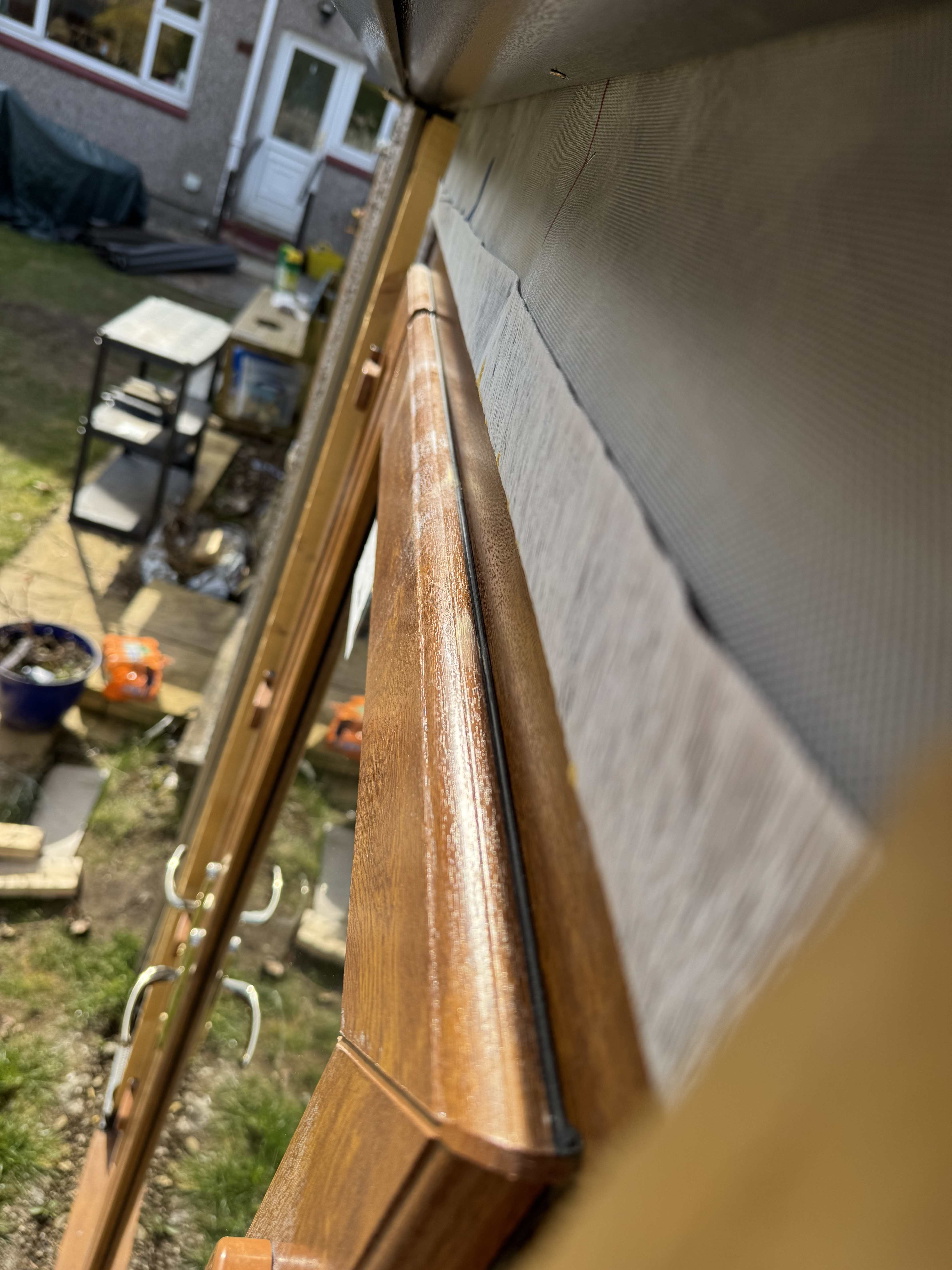

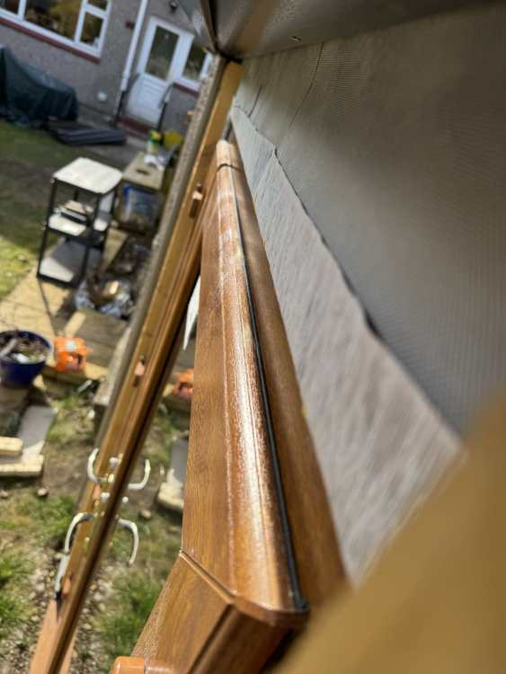

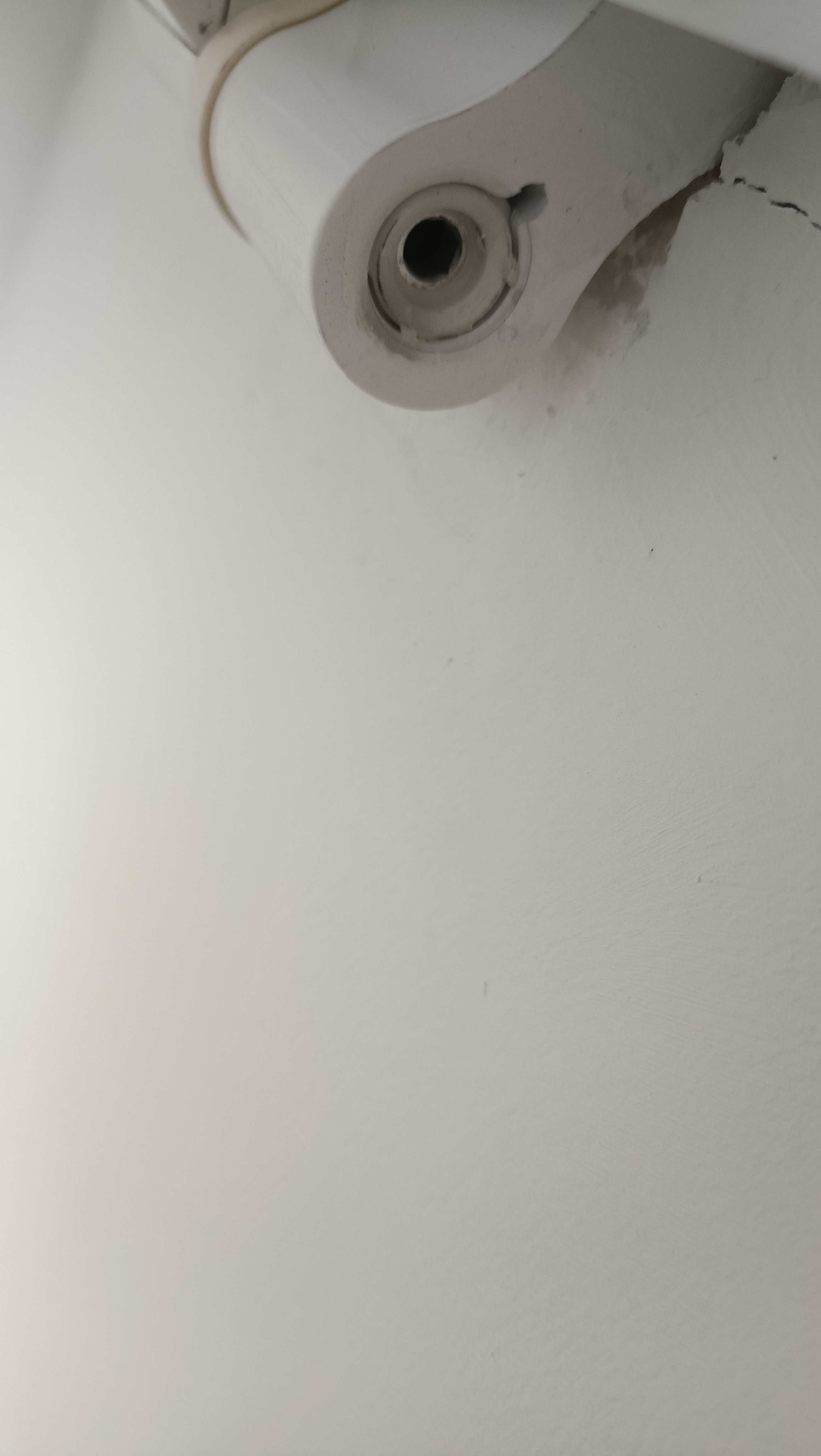

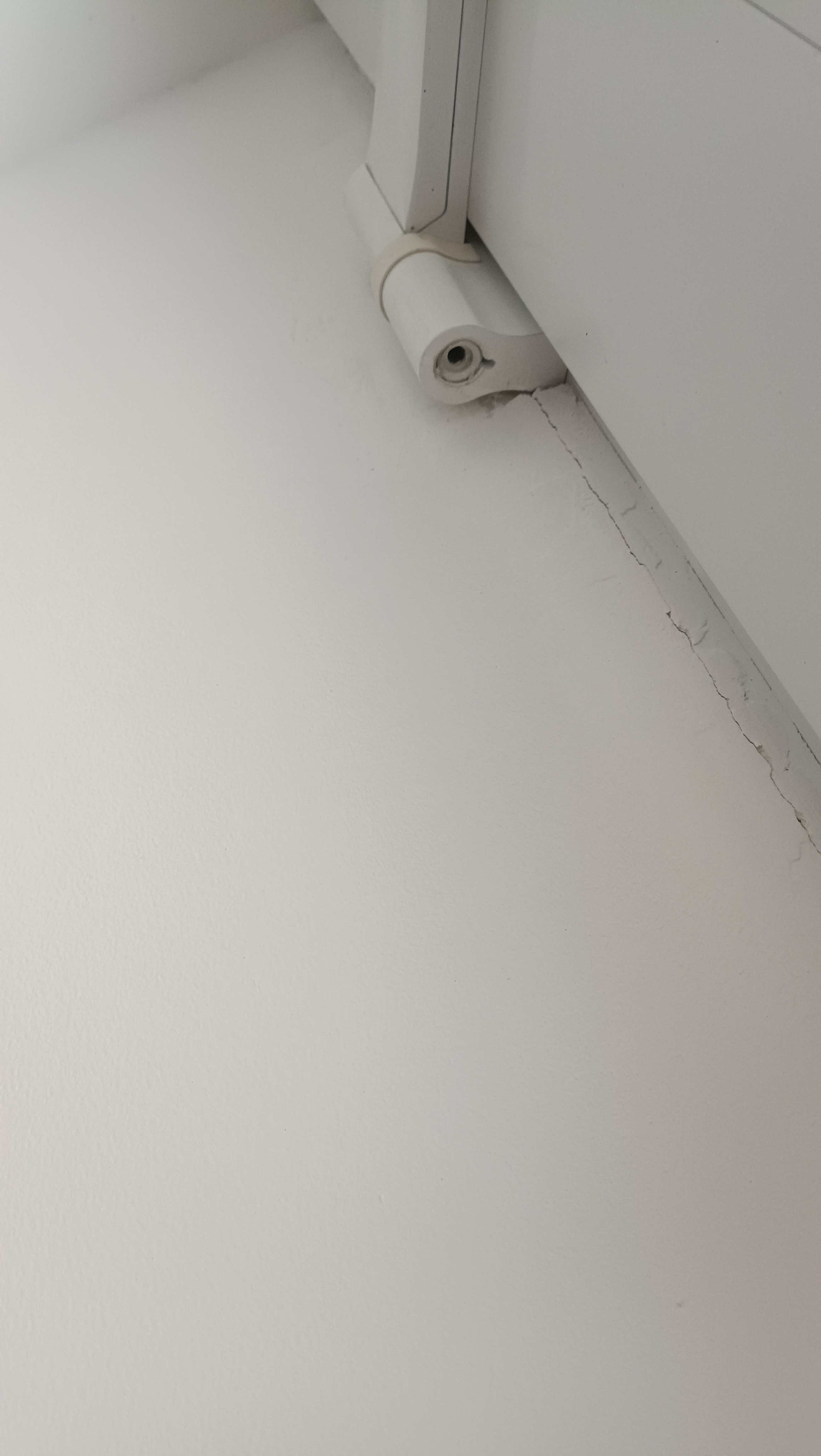

plockhart Posted March 20, 2025 Author Posted March 20, 2025 Thanks for the reply. I have attacked pictures of the door closed, one with the lock disengaged and one after I have engaged the lock. Before engaging the lock (which requires pushing the top of the door to the frame) the hinge side of the door is flush and it tapes to the ~10mm gap at the end of the door. After engaging the lock, all is flush. Here is the hinge that came with the door. From what I can see it does not let me move the door to/from the frame. Unless I am missing something? But even then, why is it like this 🤔
Iceverge Posted March 20, 2025 Posted March 20, 2025 There's a chance the door is warped. Run a long straight edge across the diagonals and check the clearance underneath is consistent. Of it's just hanging wonky pop the top off the hinges and use an Allen key to "cam" them into the correct position.

Iceverge Posted March 20, 2025 Posted March 20, 2025 That's the bottom of the hinges on our door. A hex head goes in and adjusts the door on a cam so you can plumb it up
Big Jimbo Posted March 20, 2025 Posted March 20, 2025 You may have twisted the frame when fitting it ? That would cause the problem that you have. You may be able to adjust it by using the hinges in and out adjustment . The pin in the hinge is often like a cam. Be careful though. you may find that the seal no longer touches the frame on the hinge side if you adjust it too much. That will then cause a draft internally.
