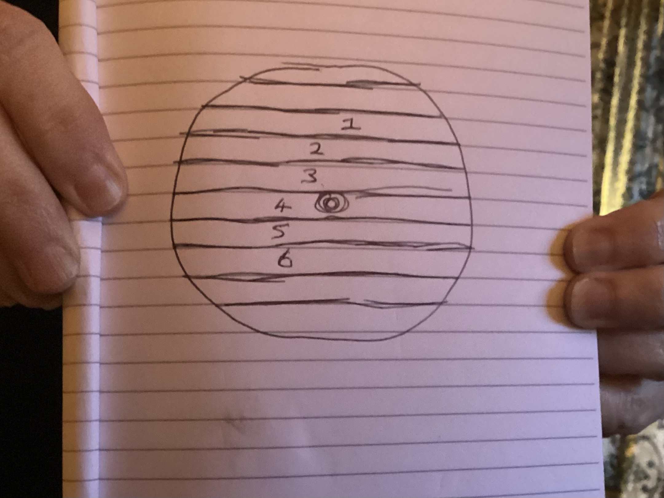

I want to build a large dining table from a single slab of timber, I went to a sawmill today to have a look at some and found plenty I liked, they had all thing I’m undecided about is what slab from what part of the tree.
the trees have been cut and then re stacked up in the same position that they came from the tree, so looking at my excellent diagram would you want a piece from the centre like no 4, or 3, or a slab from the outer parts no 1-2 or 5-6.
it’s all about 75mm thick at the moment ready to be surfaced flat on both sides to bring it in to about 60mm finish width. IMG_0353.thumb.jpeg.4d3e77b24f9aaa89a48f36b24673a91e.jpeg

And what kind of effect do you want from the finished table? The colour and grain is going to be different in those two places.
I’m probably going to stain it, most timbers will be too light for what I want to do.

I thought the outer bits were less prone to cupping.  Is this from Vastern?
The other way round.
Go for slab 4 every time. That's effectively quarter-sawn and stable - cabinet-makers generally pay a premium for quarter-sawn timber.
The only proviso is that, depending on the species, the centre of slab 4 may be split or even rotted out - but if you can see the slabs you can see any flaws.  and you can always cut a centre strip out and joint the two halves, or keep any flaws as a feature - filling splits with resin if you wish.
